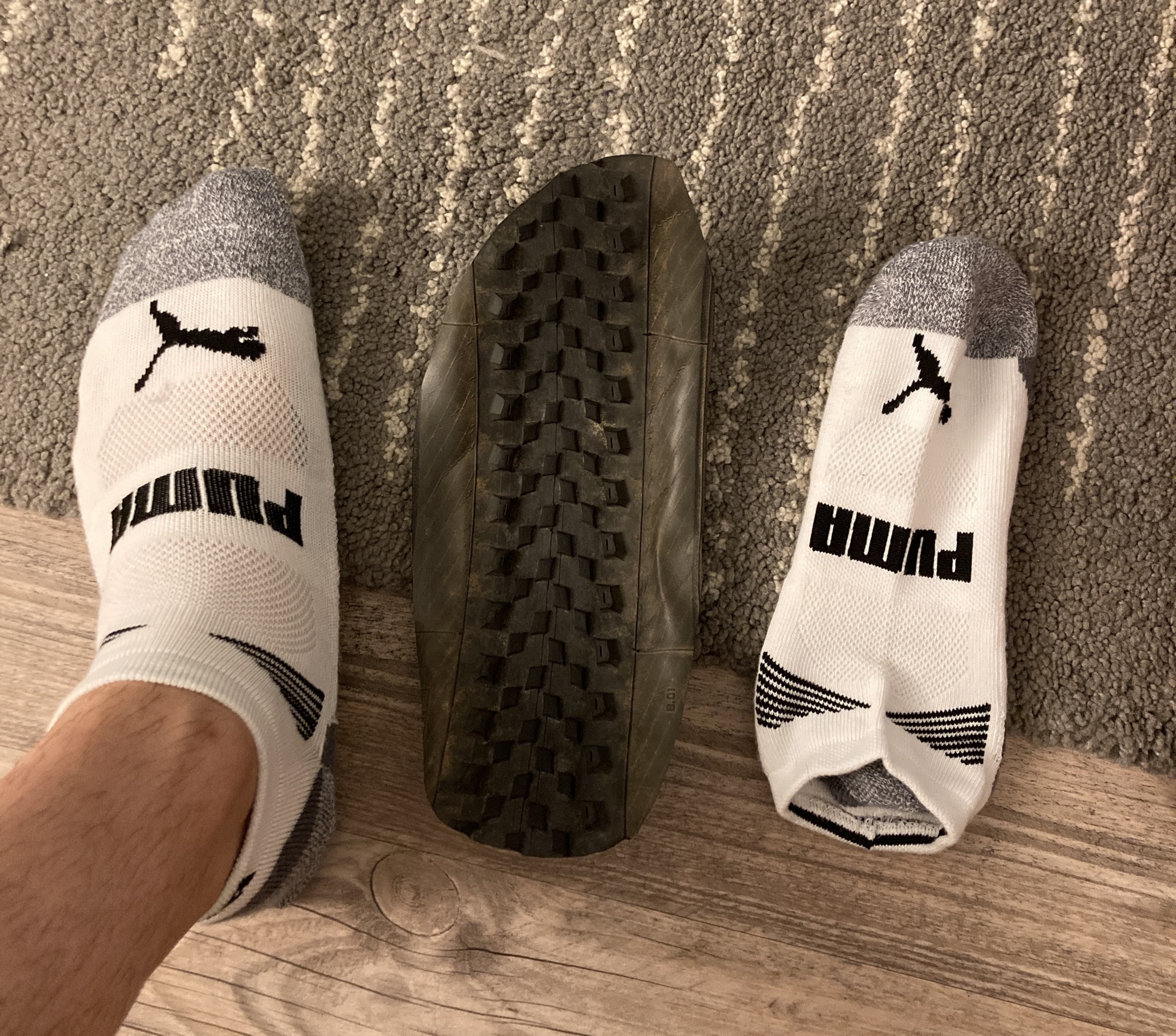

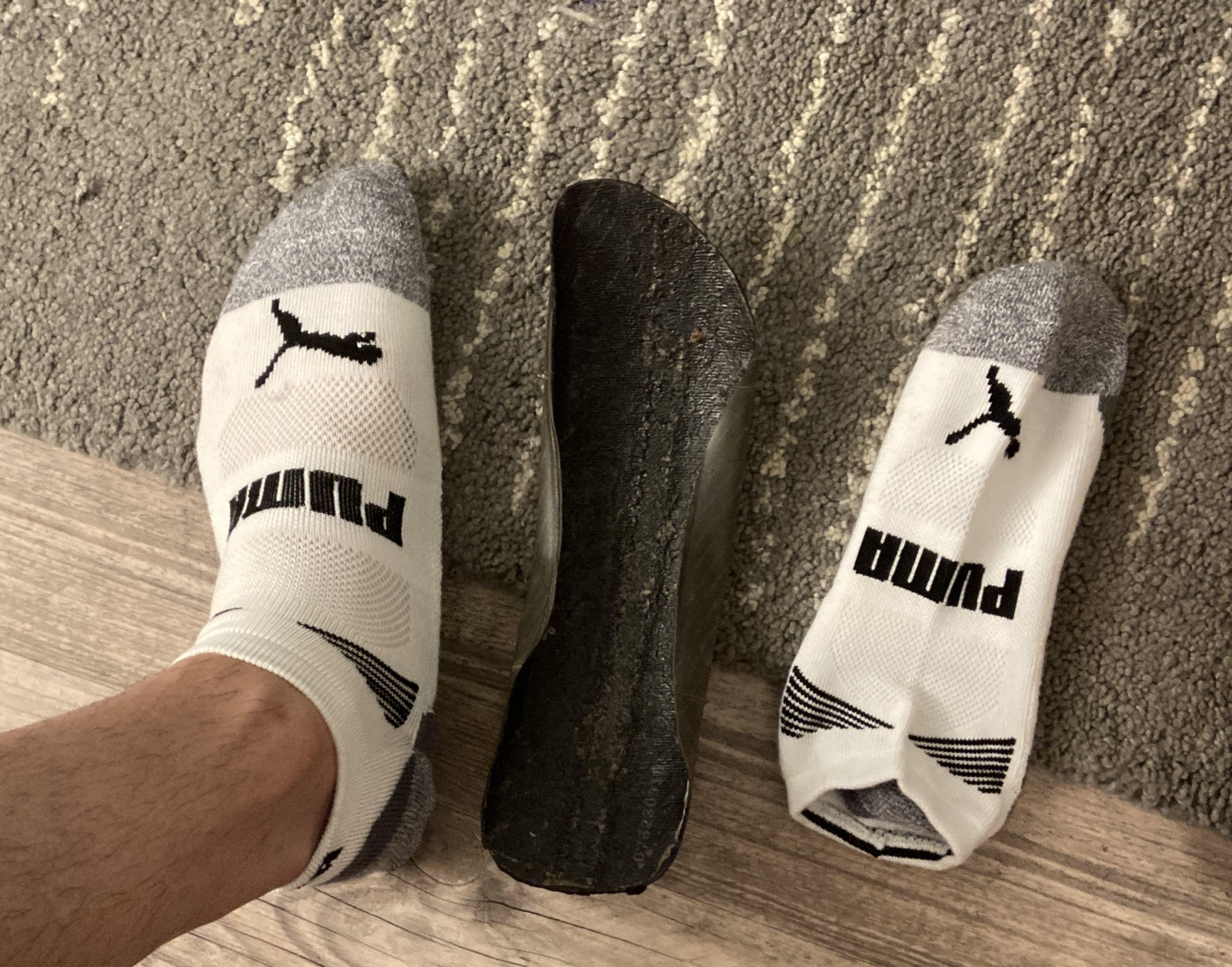

I made these last Winter for common water crossings, too deep to ride when it was cold enough wet cycling shoes would be a problem. Actually hand-stitched 1 simple barzo-moccasin but it ended up being too heavy would have been 400g+ for a pair. These are 180g.
I had thought about doing cutouts for the lugs but turns out after the first step it doesn’t matter, the sock loads up with sand/grit and grips fine. Everyone who has seen them IRL is disgusted by the concept but I like my soccasins and I’m going to use them this Winter too.

That’s basically a huarache sandal, but with a MTB tire instead of a car tire.
i’m confused. how does the sock attach
Is this guy copying your idea @jimmythefly ?
Foot goes on tire, sock goes over foot/tire
Patent Pending

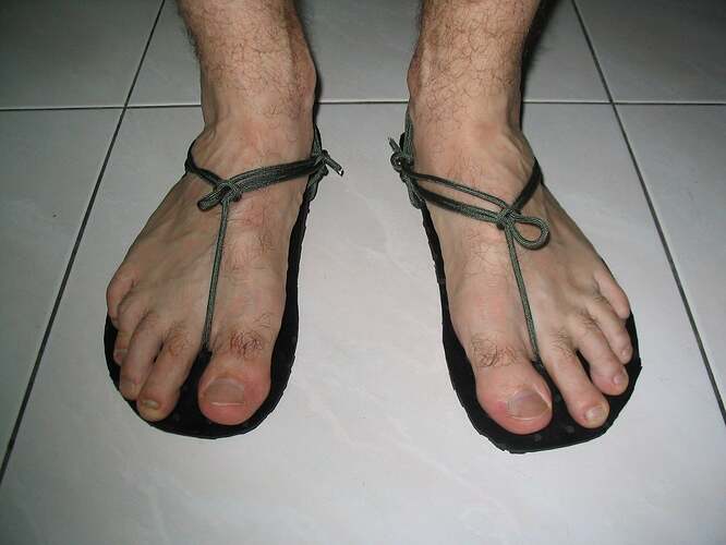

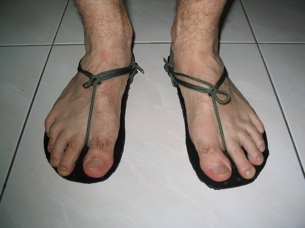

you could make actual huaraches using paracord looped/woven thru the casing of the tire, which would dry faster and be less disgusting to remove and carry
A good bike tire one here. Definitely going to try one of these. Upcycled Minimalist Running Huaraches or Lifestyle Shoes by Tired Feet : 6 Steps - Instructables

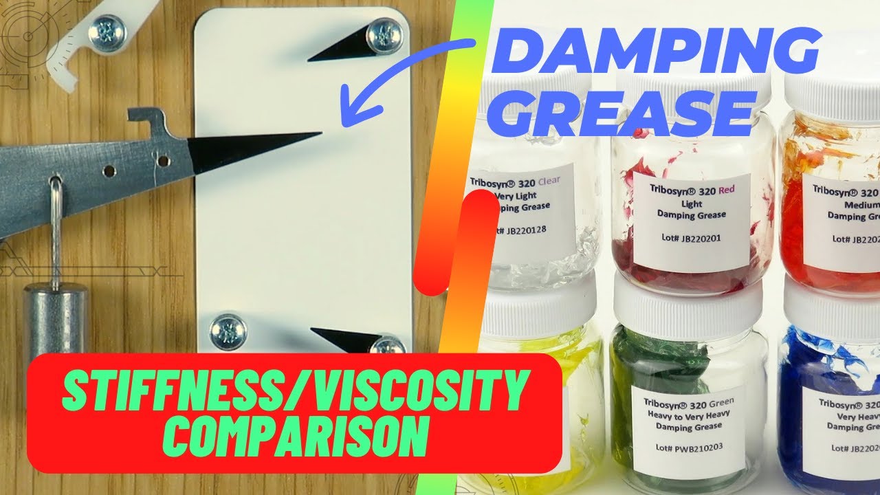

A downside was obtaining the magical damping grease. I contacted the manufacturer and they quoted me ~250 bucks for a tube. Thankfully, you can now buy replacement damping cartridges for 30 bucks. Cane Creek Viscoset Damping Cartridges
On SJS Cycles, where I bought the Viscoset, the customer service replies led me to a 100g tube of the same goop for that much, but also a link to this stuff which is supposedly equal: Tribosyn 320 Yellow - Newgate Simms
