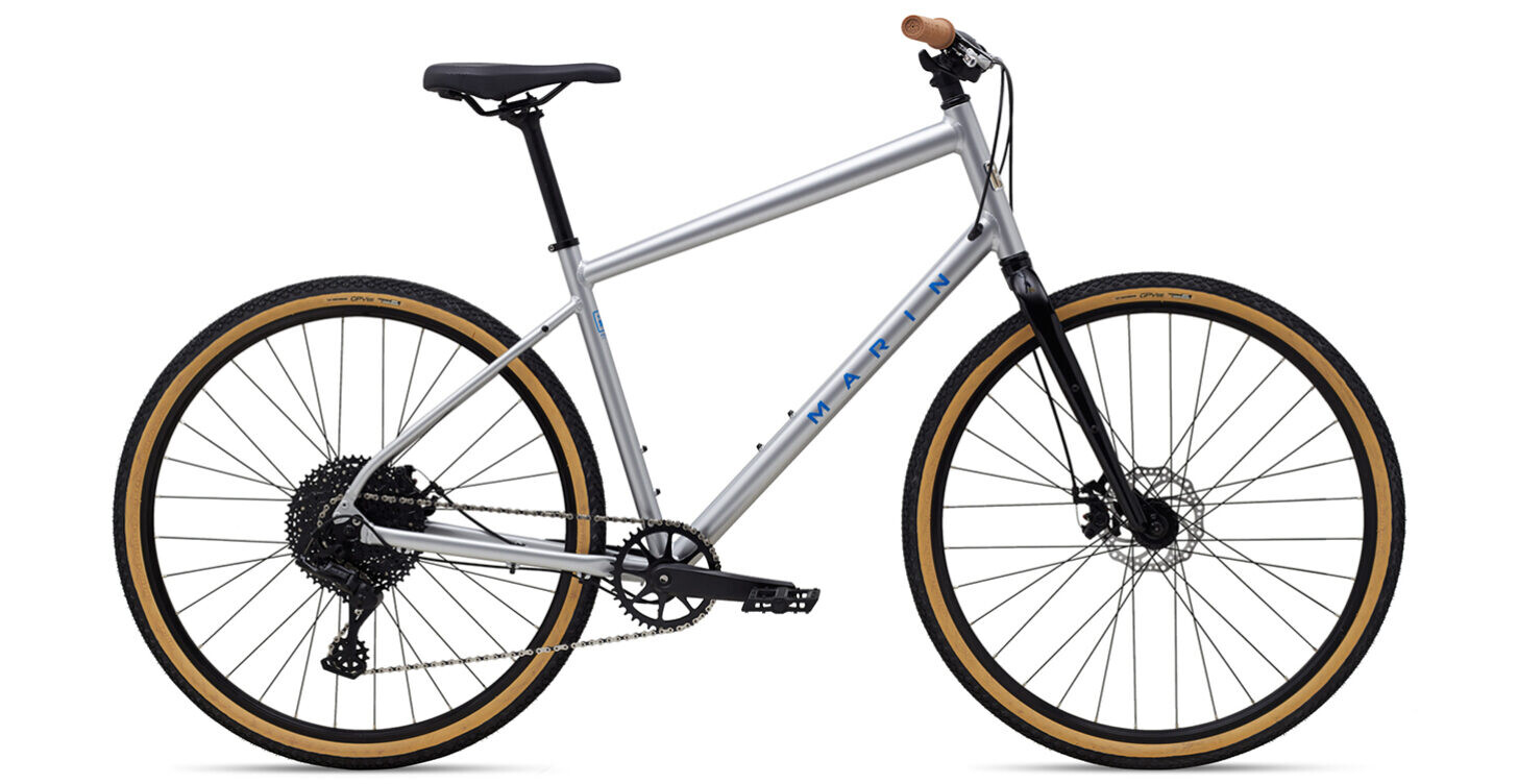

What’s the widest 650b tire you can fit in a Marin Kentfield?
real rap i think that might be my next clydesdale frame if i can get a frame
also marin bros what’s the a-c?
