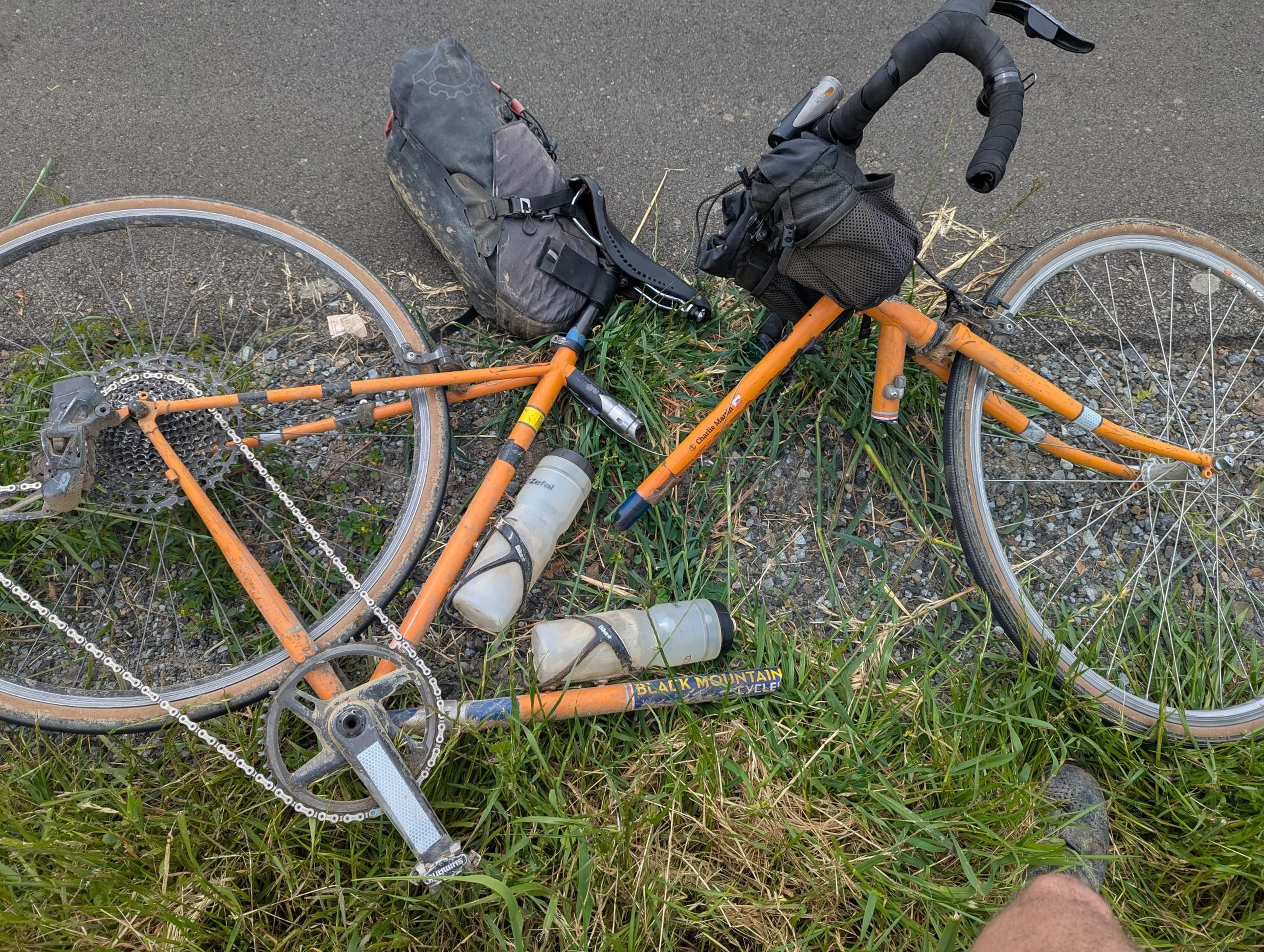

Bay Area K-Hound Charlie Martin suffers catastrophic failure of his BMC Road

Isn’t the down tube break right at the butte? (Sp?)
I don’t know much about anything but I’d blame the couplers. Given that this is local I’m sure Mike V will take a look
I’m not familiar with S&S couplers other than the basics but it seems they would have some effect.
I think his frame exceeded it’s expected lifetime by a significant amount, couplers or not. Of the handful of steel frames I’ve seen that approached 100,000 miles (in this case probably ~6700 hours), half of them failed before reaching that distance.
Figure all the similar spec steel frames that failed way before such mileage/time, and the expected lifetime is probably around 3500-4000 hours/50,000 miles.
Obvious joke about giving him another BMC Road and riding it until failure to make sure.
Of note, IMO, the ED coating appears to have retained it’s effectiveness at the downtube but was burned away at the top tube coupler and corrosion is evident
Ah perfect mine should be good for another 500 years at overall mileage per year but maybe 50-100 years at the current mileage rate
I’d agree, failed at the edge of the butt. Couplers aren’t to blame.
Yeah, dt had to fail before tt.
Once that frame tasted freedom it needed to become its true unicycles self
Simpler if the TT failed first but stayed partially together, and then precipitated the impact to the DT riding along until destruction
Coupler looks clean. Braze fails. TT stays in socket. DT does the wiggety waggety that is how you break metal.

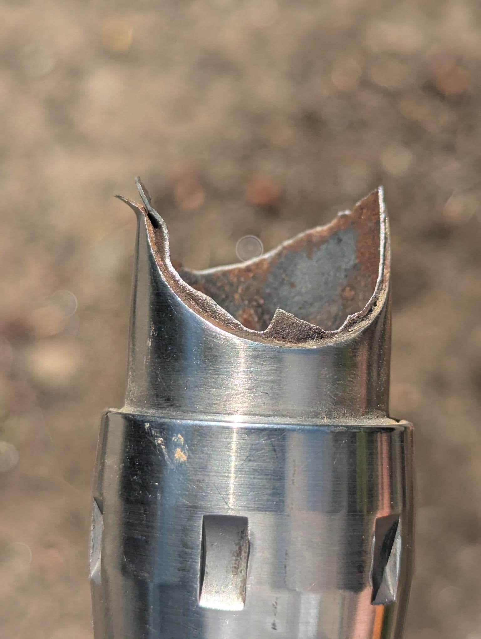

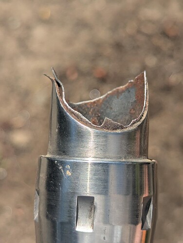

TT failed at the coupler attachment

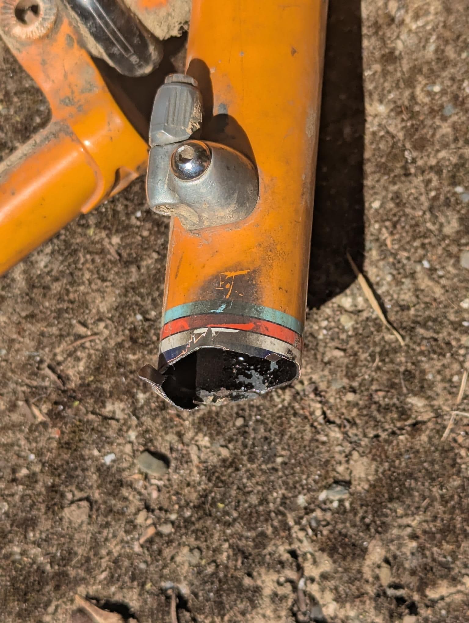

DT failed at the butt

for posterity’s sake:

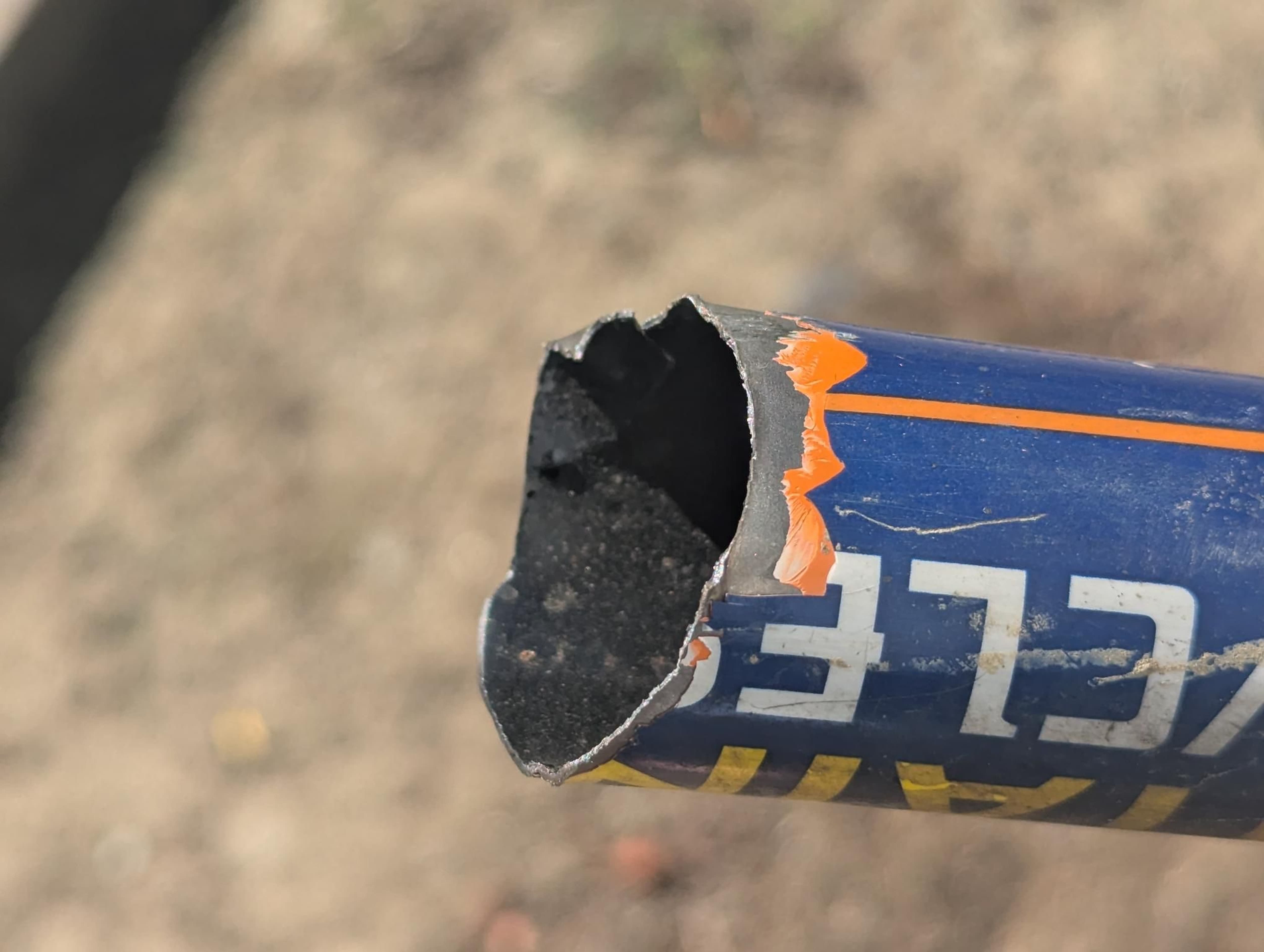

Shortly after turning onto Hicks Valley Road, I got out of the saddle to pedal for a bit, and I heard a loud “SNAP!” and felt a jolt. I looked down thinking maybe I had snapped my chain, but it looked fine. Maybe it was just a bad chain skip? Oh well, I’ll just ride a bit more and see if it’s resolved. I took another pedal stroke and was met with a loud “CRACK!” and before I knew it I was on the pavement in a pile of bicycle, with blood leaking out of my knee. It took me several moments to make sense of the situation. Did… the front just fall off? That’s not very typical.

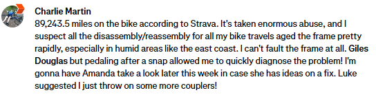

and from the comments:
89,243.5 miles on the bike according to Strava. It’s taken enormous abuse, and I suspect all the disassembly/reassembly for all my bike travels aged the frame pretty rapidly, especially in humid areas like the east coast. I can’t fault the frame at all.
Downtube:

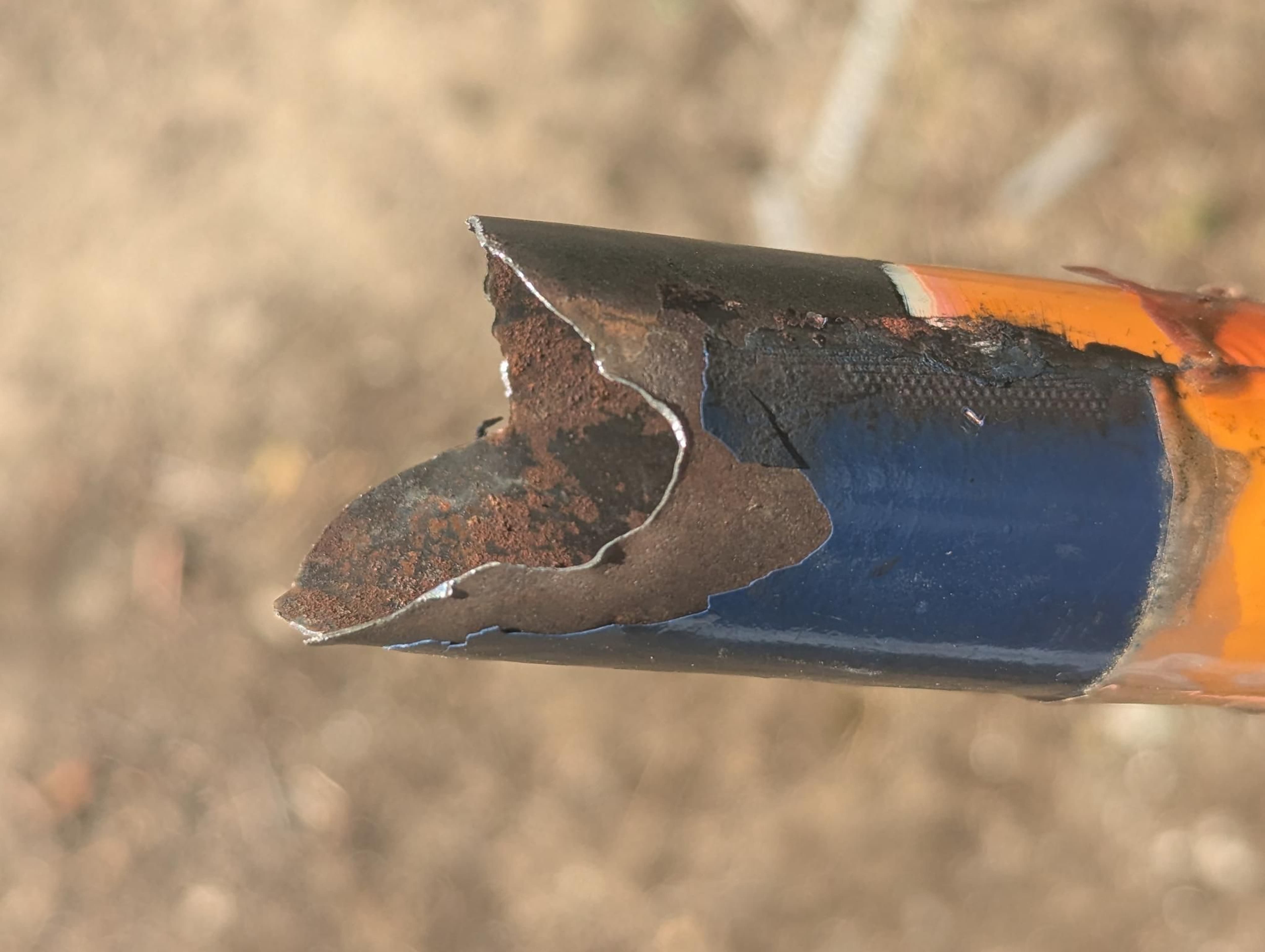

Toptube:
I was wrong. It just broke
