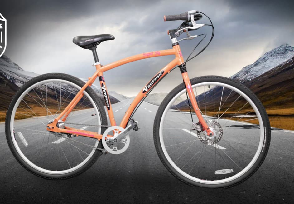

Is this antique enough to be one man’s trash?
Anyone got anything along these lines?
