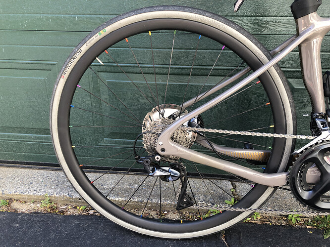

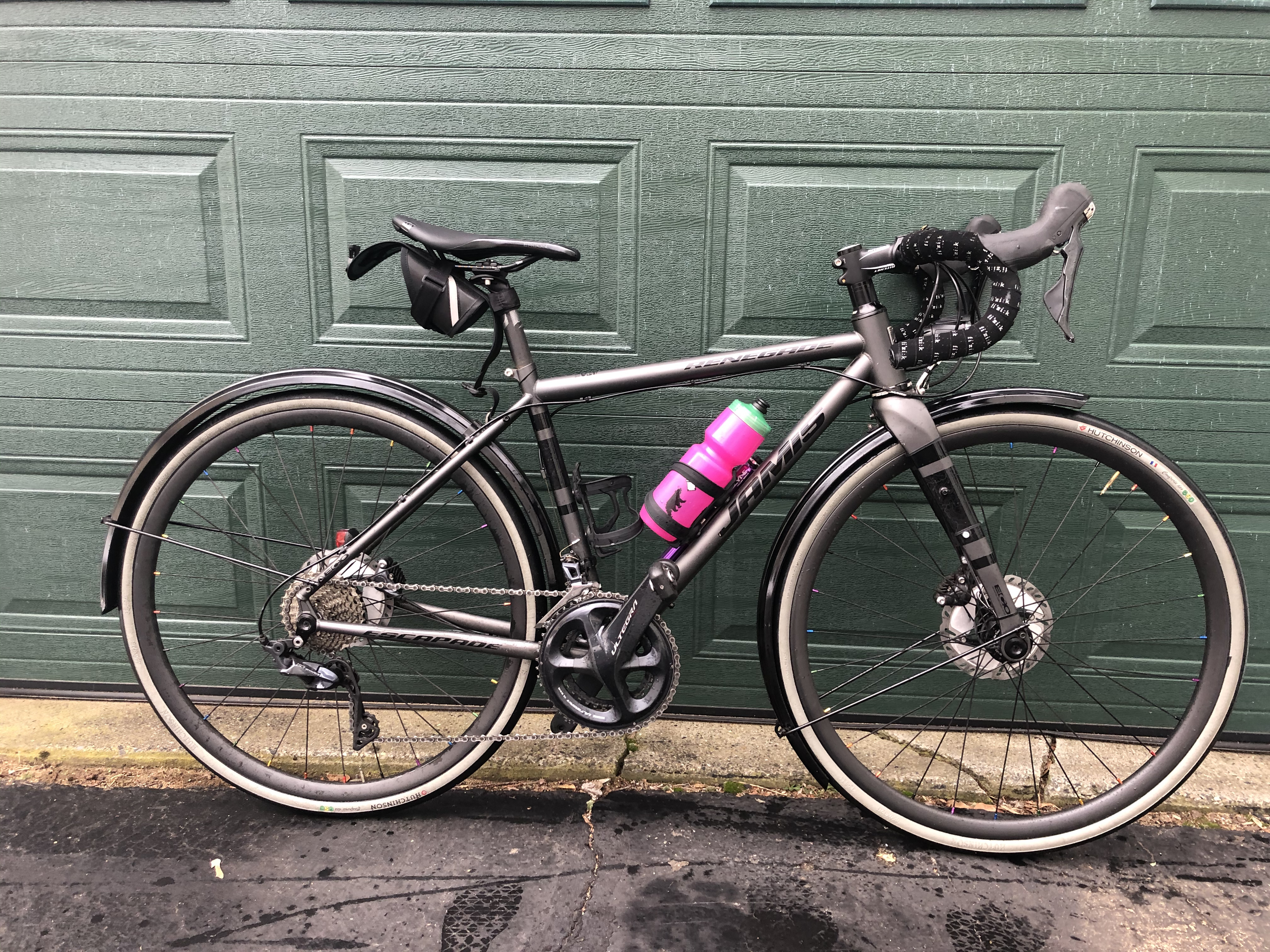

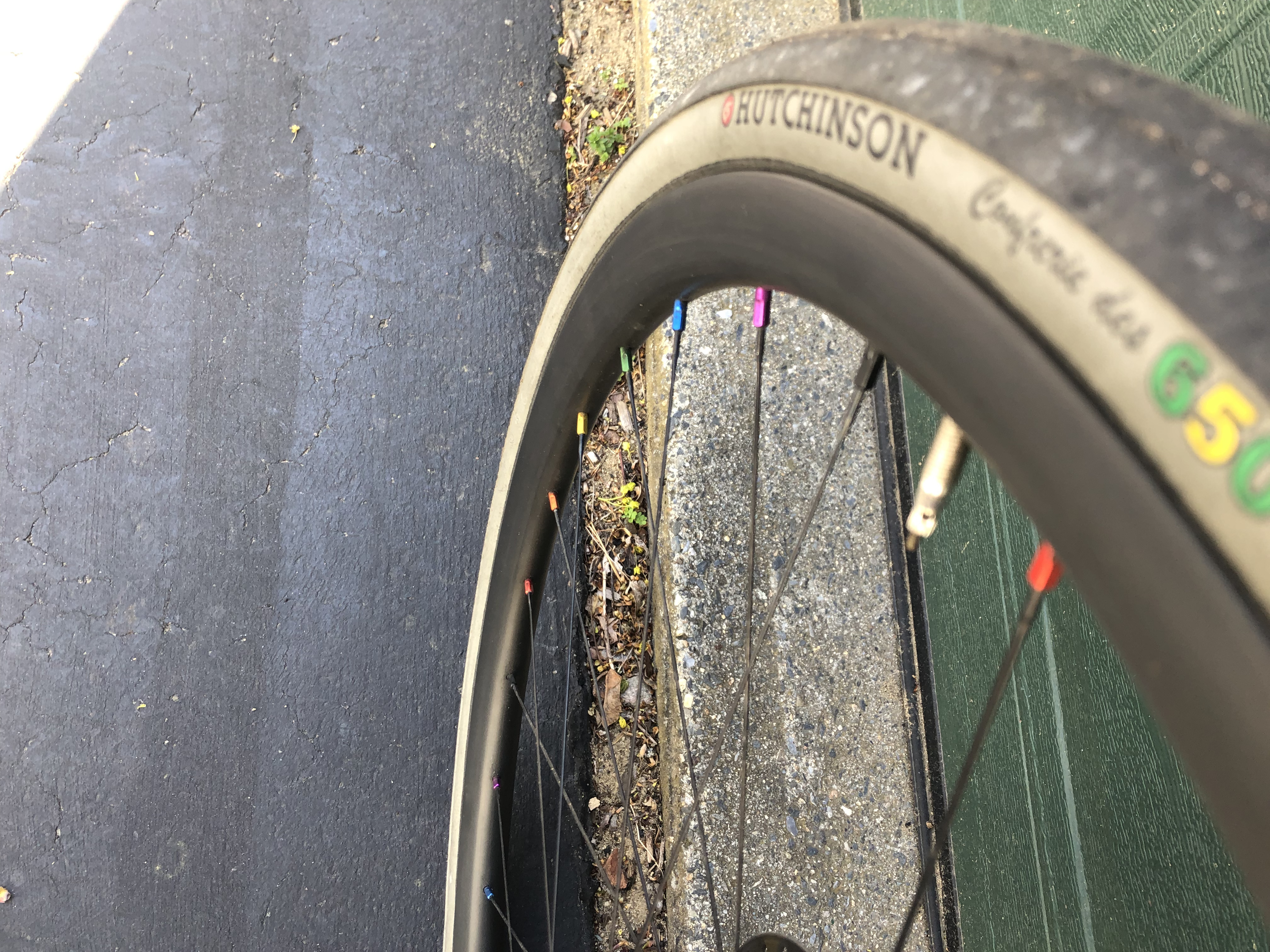

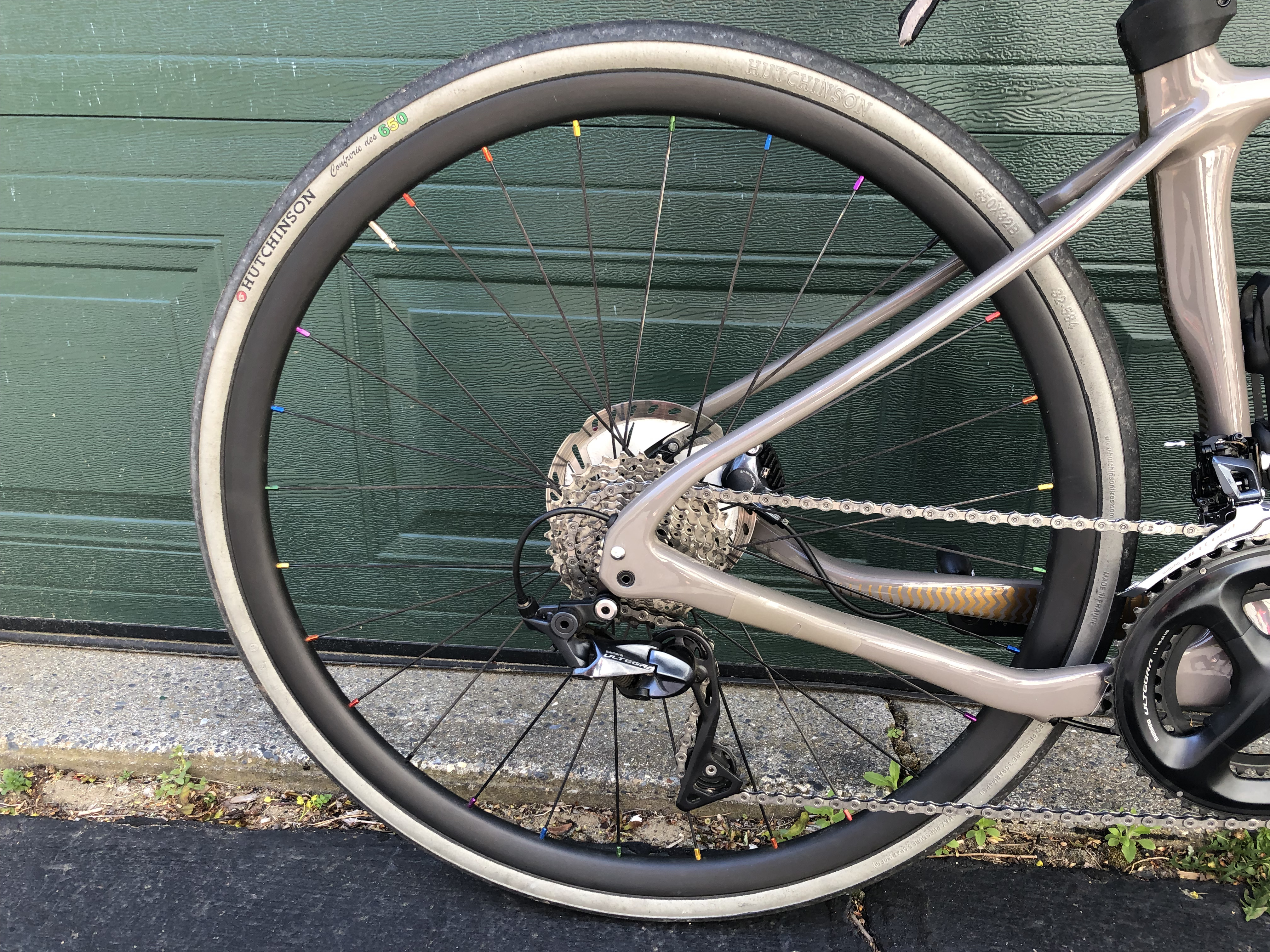

A couple years ago, my wife got a Jamis Renegade bike for gravel/rain riding. It’s a pretty cool bike, the geometry in tiny sizes is pretty good and designed around 36ish-584 tires and it’s very versatile with plenty of fender/rack/cage mounts. But it was heavy and fell into the gravel bike trap of not being fun either on or off road (one might even say it was a horrible compromise). She strugged to keep up with me when riding it. I noticed the stock wheelset was really heavy (like 2kg), so built up a silly-light dynamo wheelset, complete with TAF rainbow spoke nipples and @Orc’s favorite tires. Better, but still no kind words for the bike.

I moved the parts over from the Jamis. In the process, I weighted the framesets (with BB and headset installed on each, so subtract 150 g or so?):
  • Jamis: 3057 g (fork: 585 g, including TA)
  • Norco: 1683 g (fork: 380 g, I think?)
Chainstays are 14mm shorter on the Norco. Front-end geometry is similar on the Jamis and Norco. Once the Jamis was stripped down, my sense from the balance of the frame is that the chainstays and seatstays are really overbuilt.

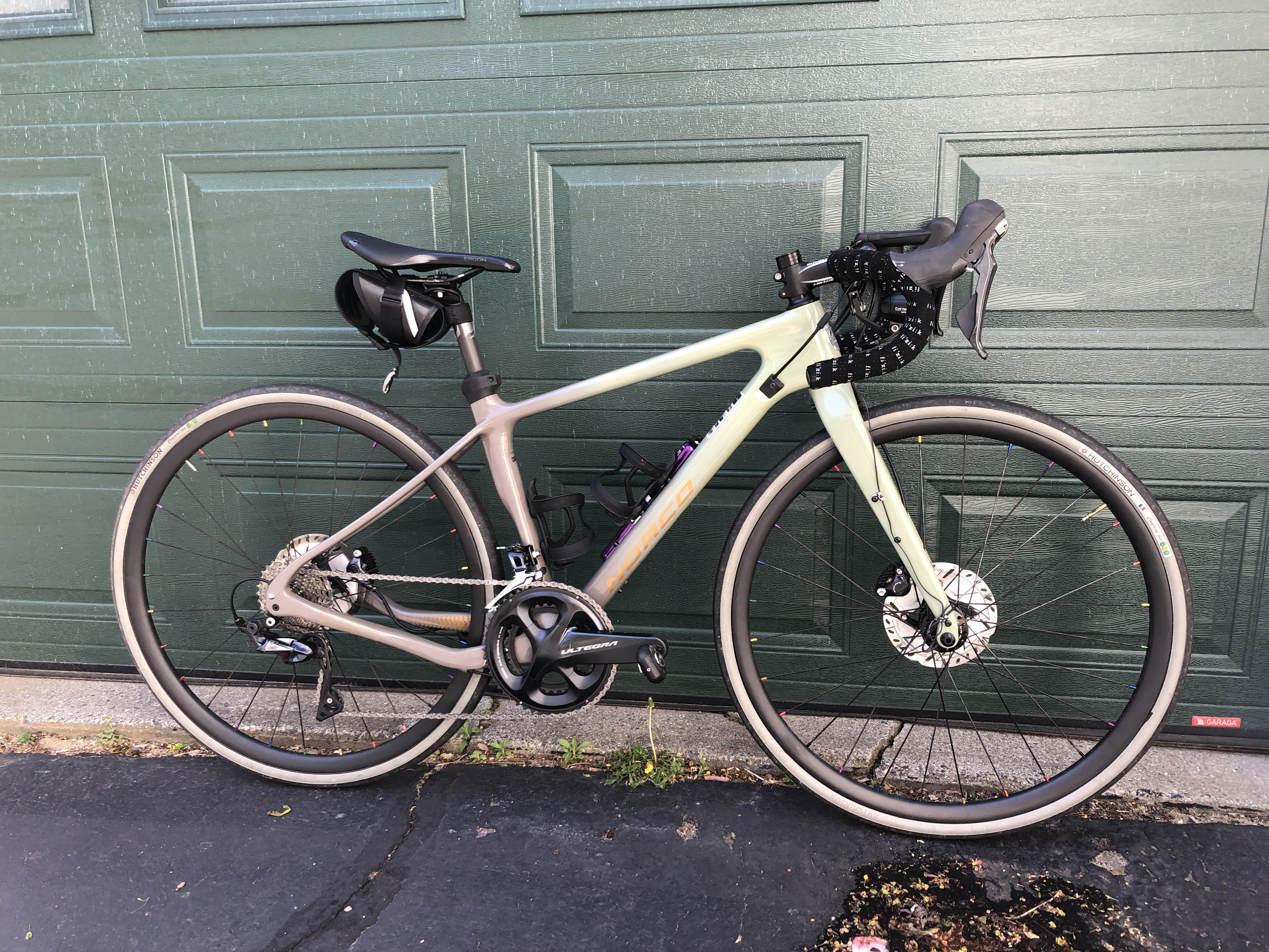

Building up the Norco went remarkably smoothly. The rear brake and shifter internal routing was frustrating, but I think I figured out tricks that will make it less painful if I have to redo it in the future. I’ve finally got the hang of filling/bleeding hydraulic disc brakes, or at least got lucky. We concluded that the biggest risk cutting the fork was getting the length wrong and that I was better off measuring and cutting than measuring and handing it off to a shop. I left it on the long side, just in case, but managed to cut it where I intended to.
Predecessor for comparison:

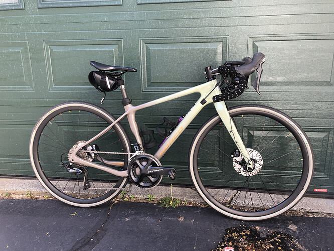

We went for a ride today with a couple dirt stretches and the verdict was “Whee!” There was a bit of fussing with seat position and FD adjustment, but otherwise my wife is really happy with it. It’s only 1.6 lbs heavier than her Canyon Endurace, feels like a road bike on the road, and rides really well on rough stuff.
The primary complaint is that the green-brown fade paint is rather understated by my wife’s standards. The wheelset helps make up for that.
I haven’t installed fenders yet. It looks like there’s plenty of clearance and the mounting points are reasonable except for the silly add-on seat stay bridge.

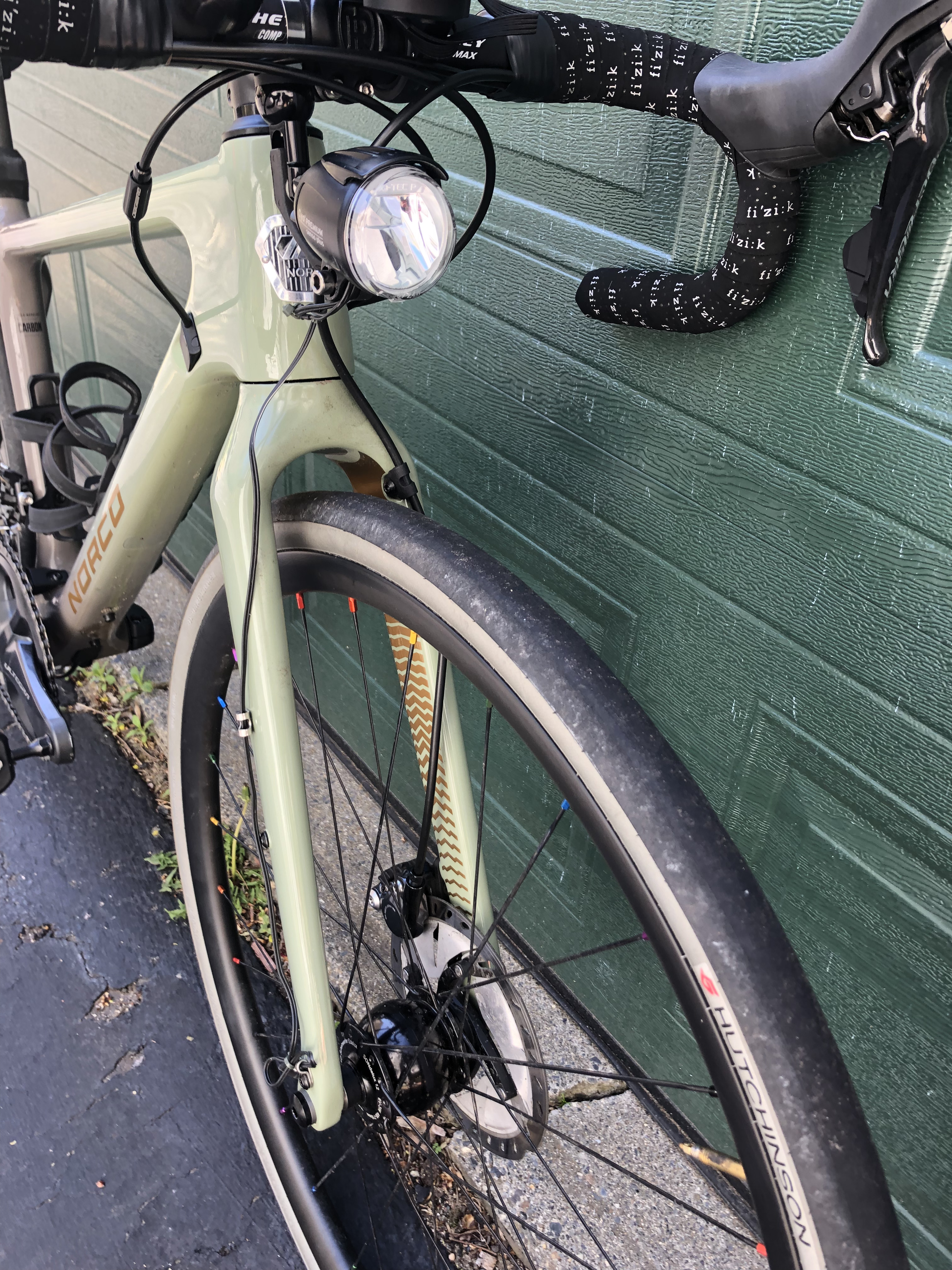

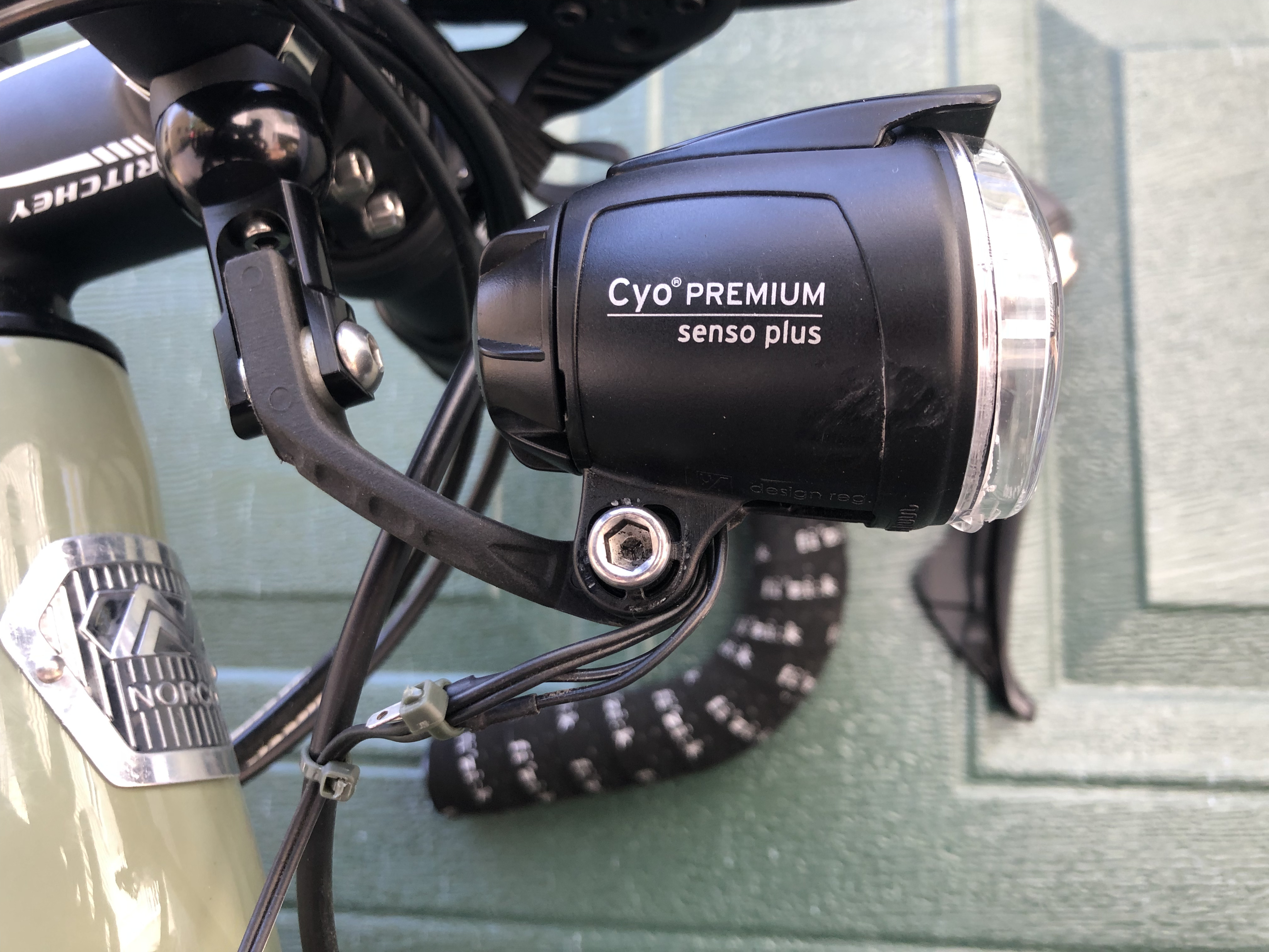

I rigged up a light mount, but will probably replace it with a BarFly with GoPro mount with some sort of extension that the light bolts to. I’m looking at the Lupine GoPro adapter, but open to suggestions.
And I just realized I could probably snake rear light wiring through the frame holes intended for a dropper post, so there’s more dithering to do!

Awesome! I have not done it, but you can remove the aluminum heat sink from the Cyo and drill/tap it for a hanging mount style.
Imgur
Ooh. I actually have a Cyo with a busted mount. I should try modifying it into a hanging mount. Excellent dither suggestion!
HY for her
If you’re looking for something to clean up the dyno wire routing, Shimano Di2 wire cover tape works really well for that.

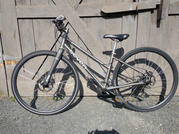

small cheap possibly horrible bike:
local pickup only
