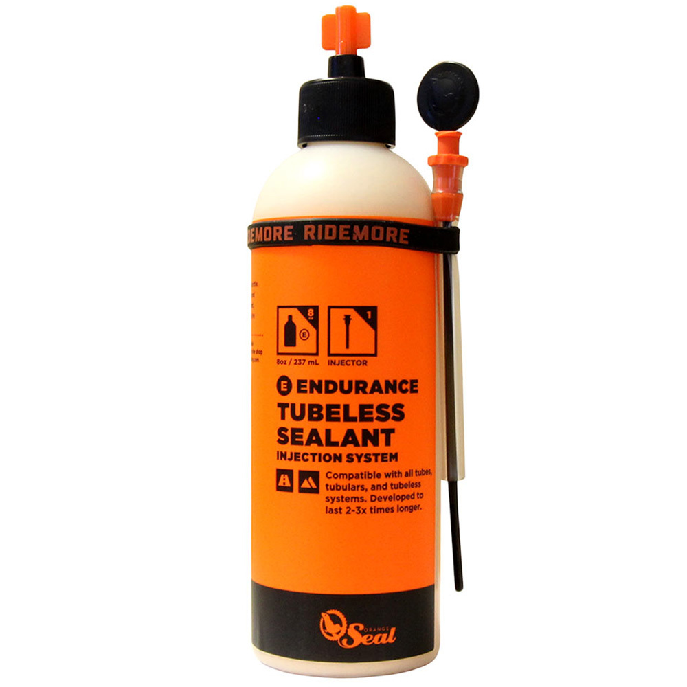

DQ: What’s the consensus on checking your levels? 3 months? 6 months?
I’ve been using the dipstick thing that comes with the smaller Orange Seal bottle to check every now and then…but I let my CG run dry and found out the hard way.
They say 6, but I like 3.
Dipstick? Am I not doing this correctly at all?
I dunno, I remove the valve core and dunk the black plastic stick thing in the below photo to get an idea of the fluid level without having to pop the tire off the rim.
It seems to cling enough to get an idea if there’s still fluid in the tire.
I think I’ve bought 3 bottles of orange seal, none of them has ever included that dipstick.
The bottle I got has one, but if I’m going through the trouble of dipping the stick, I might as well just squirt some more sealant in there.

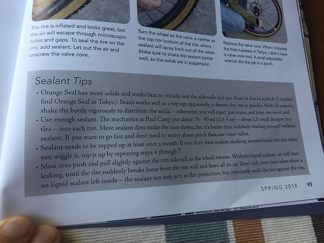

follow this ancient tire milk schedule:
download
Lol, Janny says “at least once a month”.
Sounds about right. he can see through his sidewalls.
Inflate before every ride. New tire every 6 weeks.
