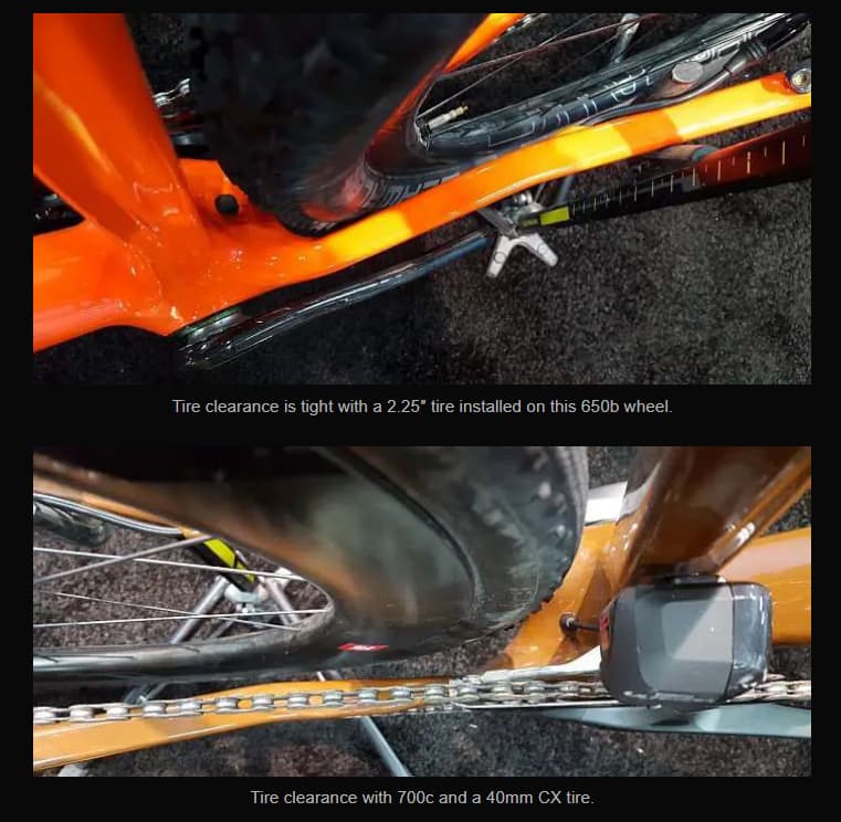

They’re potentially going to redesign the chainstays to limit clearance? Or is this some sort of warranty dodge or safety regulation? If they’re increasing bb drop to 80mm+ 650bx2.25 is 6mm lower than 700cx44. Enough to be an issue at this range (269-275)?
This is the original UP in 2015. I can’t see how they straighten the chainstays without increasing 650b clearance, unless they also do that weird flat/flare thing some CX/gravel bikes did early on.

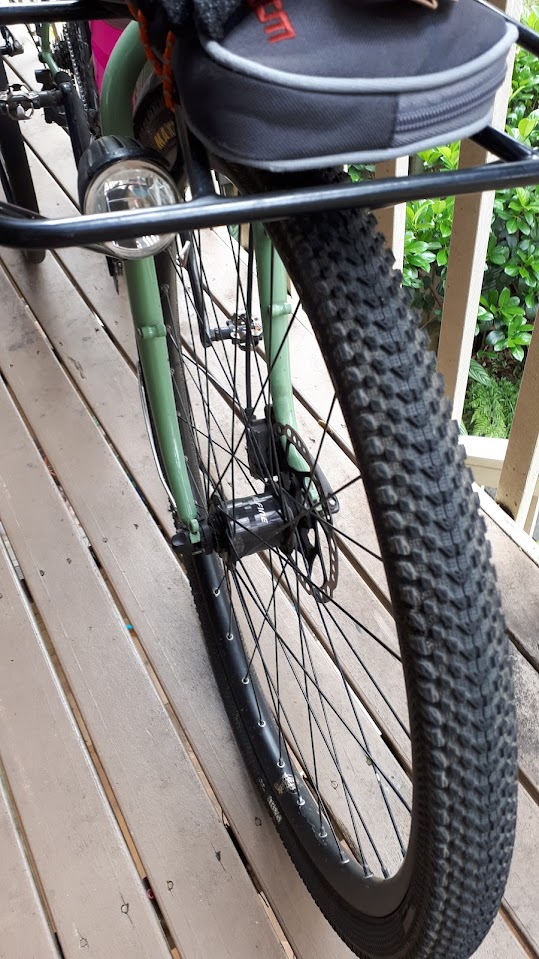

I had some TR Challenge in 36mm -I was plugging it every week or so. Was supple though
Does anyone know about the Maxxis Pace in 27.5 ? 60 TPI.

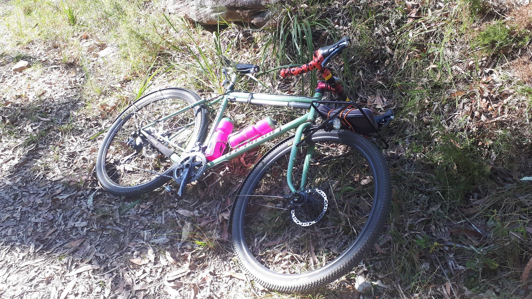

Yeah, I had a set on the NFE for fire trails and whatnot during the lockdowns. Mine aren’t 2.1", think they’re maybe 1.75" which don’t appear to be made anymore (actually must be 1.6" cos they fit under my mudguards). They’re fine, plenty of grip on loose dry dirt and gravel, can’t comment on wet grip though. Rolled fine on tarmac too. Can’t comment on longevity or suitability for pukebacking etc.

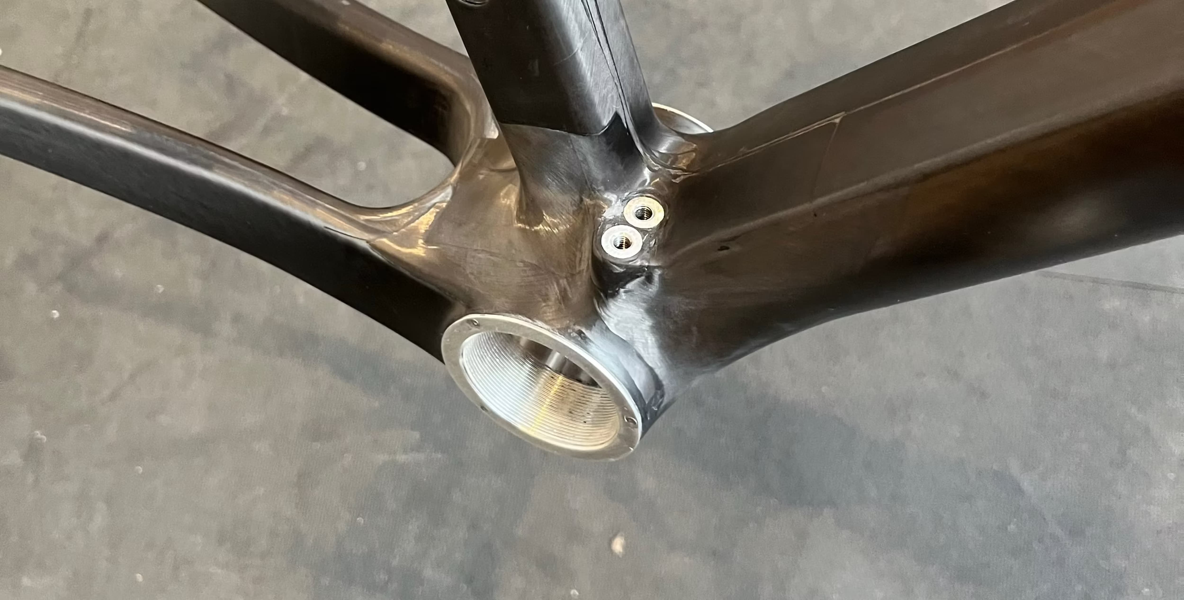

What’s up with the pins through the flange on the bb. Don’t we traditionally strive for smooth there?
