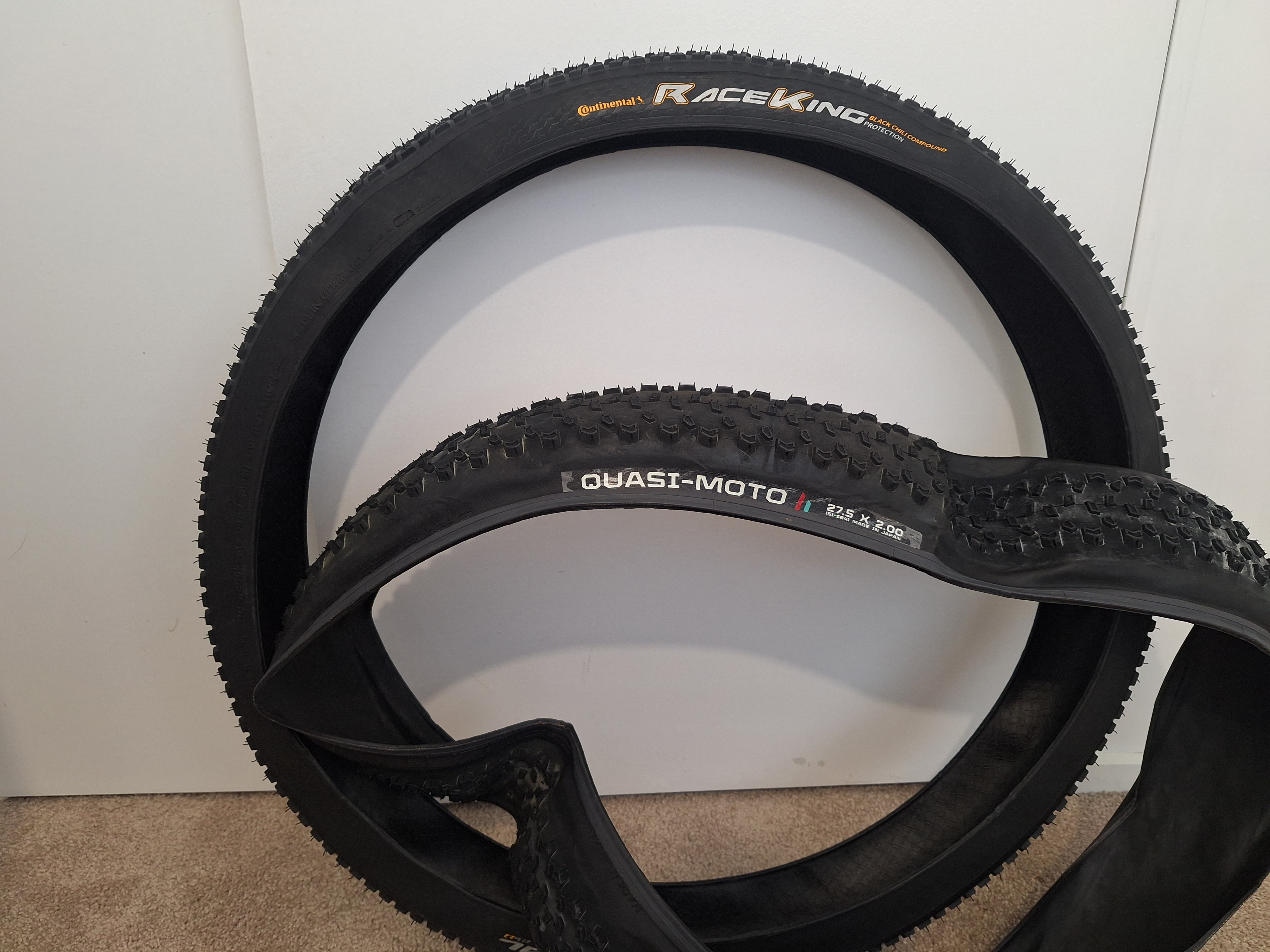

New tire day yesterday. Everyones favourite fast tire sure aint supple !
I was thinking of trying the Panaracers shown with tpu tubes.
I also just bought a set of those in the 26x2.2" sizeway and agreed that they are STIFF in the hand. That said, they’re significantly lighter than the Maxxis Ikons I have in the same size, despite the Ikons performing better in the garage-door-test. Maybe supple is a lie, we’ll see how I feel when I stick these on the bike.
Every conti tire I’ve ever used has been kinda stiff feeling but then rode nice.
This is my first chilli protection one. I think I heard they tend to wear faster.

Put a new chilli raceking on it with 140 mls of stans. Crazy fast feeling tire.
