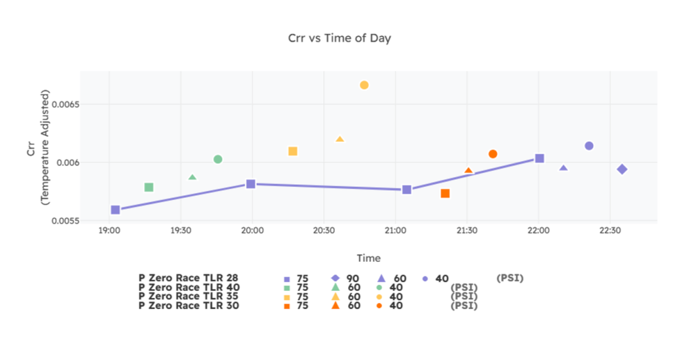

Pirelli sponsorship for this round of advertorials (going back to last year) has introduced significant noise into the data. Their line of lightweight to demi-balloon road slicks features modern advancements in compound but not in construction with the largest tire size much thicker than the narrowest - opposite best practice.
Jan has made the fastest tires but performs some of the worst experiments. Ronan has performed a series of very good experiments except he failed to account for a significant variable and doesn’t address it at all. Which makes me question the value of those experiments?
Pirelli told his this, or he assumed it himself, but it’s not true.
It was about taking a single, (mostly) consistent tyre family and using it to stress-test our test protocol.
P Zero 40: 3.6mm thick
P Zero 35: 3.4mm thick
P Zero 32: 3.2mm thick

Ronan’s process seems pretty thorough , and I’m not sure there’s any other tire family that spans that size range with the same tread?
:jan:
the thought of running any Jan tire tubeless at 75psi is terrifying
I don’t think it matters so much that the first set of tires he chose have this weird inconsistency across the size range. I wouldn’t put much faith in any sweeping generalizations about tire size, or pressure, or anything else if the source was one test, or one brand, or model of tire.
The point of the exercise, as I understood it, was to demonstrate a testing procedure that would let him compare tires tested on different days, in different weather, etc. I think he did a good job there, but the real payoff will come after he’s tested more tires.
