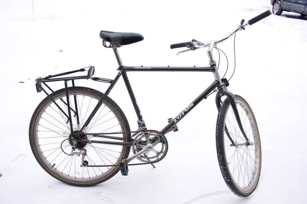

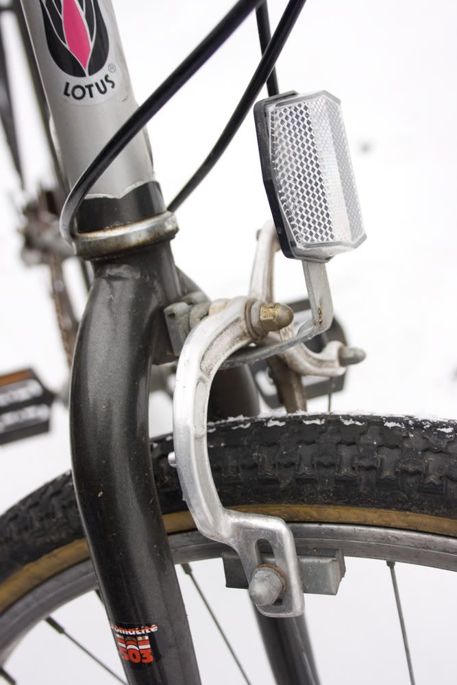

I recently acquired this from my grandpa who wants to get a new one but hasn’t ridden this in years. It’s just been garaged basically, though he did ride it quite often in it’s prime. It’s gotta be from the late 80’s / early 90’s, and if you can’t tell the brand and model are Lotus “Commuter”. The frame seems to be in decent shape with little patches of rust but not really that bad. Almost all the components are either filthy or rusty though. For some reason there’s only a front brake. And a few dorky attributes aside (like the monstrously wide handlebars), I think this could be a nice little rain bike for me if I throw on some fenders and what not.
So basically I want to clean it up, and replace / tune up all the components I can to get this in better shape. It is going to be a beater / rain / visitor bike, so I wanna do this on the cheap, but I want it to run well and not sound like a janky piece of crap.
I’m gonna post some pics, and can you guys diagnose what needs to be done? And if you have any parts you wanna sell off from your various extras lying around, let me know. I’m not as perceptive as some of you at picking up on what shit is so I don’t really wanna make 15 threads asking if something will work.
Thanks! Once this gets underway I’ll keep everyone updated on the progress.
New wheels ,chain, cables, brakepads, and tires.
Overhaul everything else and replace what you might need to(that headset and BB are probably grosso).
Ride. It’s kinda nice for an old weird thing.

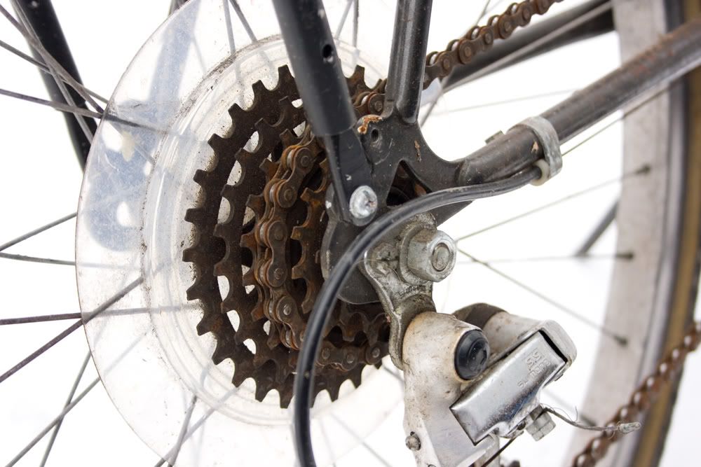

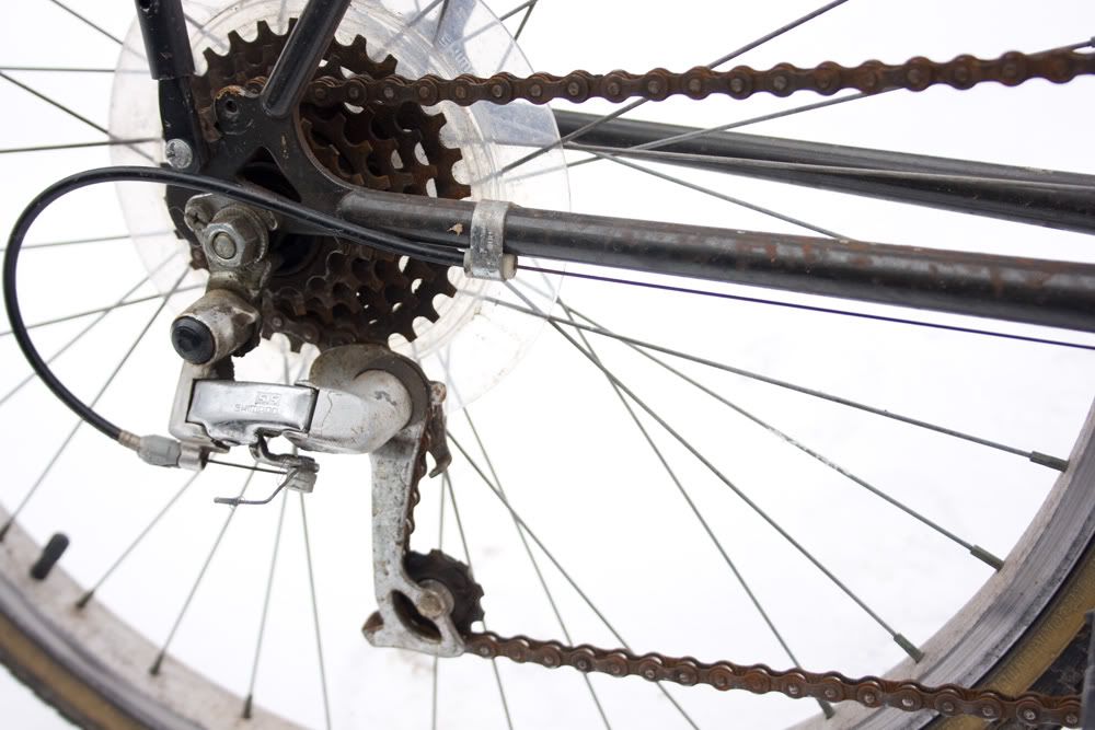

What about cassette and chain ring? Or should I just try and clean those?
[edit] By my count, this thing has 6 rear cogs and 2 on the chain ring… Do they even make [freewheels] like that anymore? I thought 7/8/9 was standard.
Looks like a freewheel rather than a cassette. If you keep the wheels, just replace the freewheel, they really aren’t worth trying to clean up.
oops yeah i’m fucking up my terms now. word though.

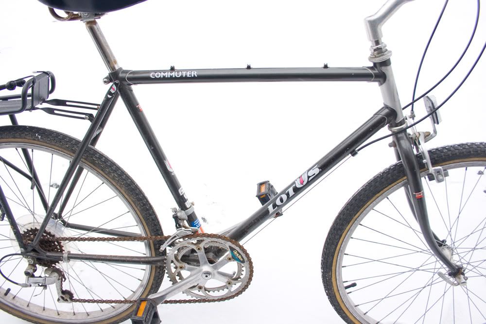

wheels: cxp22’s or something off bicycle wheels, cold set to a 7 speed cassette possibly? could be a good wheel choices.
your chainrings look fine, replace the chain.

CXP22? That’s 700c. Bike looks 26". Want a cassette? Pick up some cheap v-brake wheels.
Yeah the wheels on this thing look so tiny… I mean I’m used to looking at 700’s every day but they do strike me as little.
If this is gonna be a beater, all I’d do is get a new chain, rear brake, and clean it up. But that’s me in all my cheap-assness.
I don’t really care about cassette vs. freewheel, I’m not trying to do a time-period accurate restoration so I would assume cassettes are easier to find these days.
Haha well that’s definitely gonna be my first step before I do anything else…
Cool. It may just work okay after these simple steps.
Is it just me or is it hard to find a fucking 12-speed chain?
this is because chains are sold in sizes based on rear cassette/freewheel size.
so, a 12 speed chain is really a 6 speed chain.
Also: they are 6/7/8 speed chains for shimano.
edit:
http://www.cswestbikes.com/servlet/the-494/Shimano-LX-5,-6,/Detail
get down.
that’s what i figured must be the case. thanks for the heads up.
this is why i need you guys.
It would be listed as a “6/7/8 speed chain.” KMC makes several, and the cheapest is like $7.50
For the rebuild, this is what I would do:
  1. Dismantle completely and throw away nothing. You never know what random parts you’ll need. Wash the bottom bracket, headset, crankset, etc in the sink with Simple Green, toothbrush, rags, etc. Soak if necessary.
  2. New chain, cables, housing, brake pads. Maybe new tires, grips, and saddle.
  3. Prep frame with Simple Green, then Goo Gone, then Mothers polish, then touch up paint with color matched nail polish where needed, then a few coats of car wax, then boiled linseed oil on the inside.
  4. Rebuild with marine grease, it’s waterproof, available at most gas stations, and lasts longer than bike grease (albeit with more friction but it’s a commuter so who cares)
  5. If the hubs spin smooth you may not have to rebuild them, same with pedals.
You’ll need a metric allen key set, a bottom bracket tool, large adjustable wrench, metric socket set (8, 10, 13, 15 at least), pedal wrench, heavy wire cutters, grinding wheel/dremel, several clean rags, bottle of Gojo. Also a set of metric cone wrenches if you rebuild the hubs.
All the better if you have access to a bike co-op.
Everything on the bike looks decent enough. I would swap out the bars for some moustache or northroad style bars and set it up as a single speed. Also, replace that front brake with something nicer. A coaster brake would be nifty. If you have hills, wind or big cargo do a 1x6 or something though.
Super Villian: Thanks a lot, that’s a good little list. I appreciate it. I wanna start accumulating any supplies I need before I disassemble so that it won’t be out of comission for too long, plus it just snowed so I might wanna use this in the winter weather.
Kemmer: I was thinking about making it a single speed, definitely swapping the bars… We do have hills but nothing insane, nothing that ever daunts me on my fixed. I might just keep it geared though… I dunno. I kind of don’t care either way, just wanna do whatevers easiest.
[quote=Scalawag]
Kemmer: I was thinking about making it a single speed, definitely swapping the bars… We do have hills but nothing insane, nothing that ever daunts me on my fixed. I might just keep it geared though… I dunno. I kind of don’t care either way, just wanna do whatevers easiest.[/quote]
Ok then, if the cables are good and it shifts ok after adjusting it and replacing the chain just run it as is till something gets fucked up. Honestly though, converting to single speed is as easy as replacing cables.
