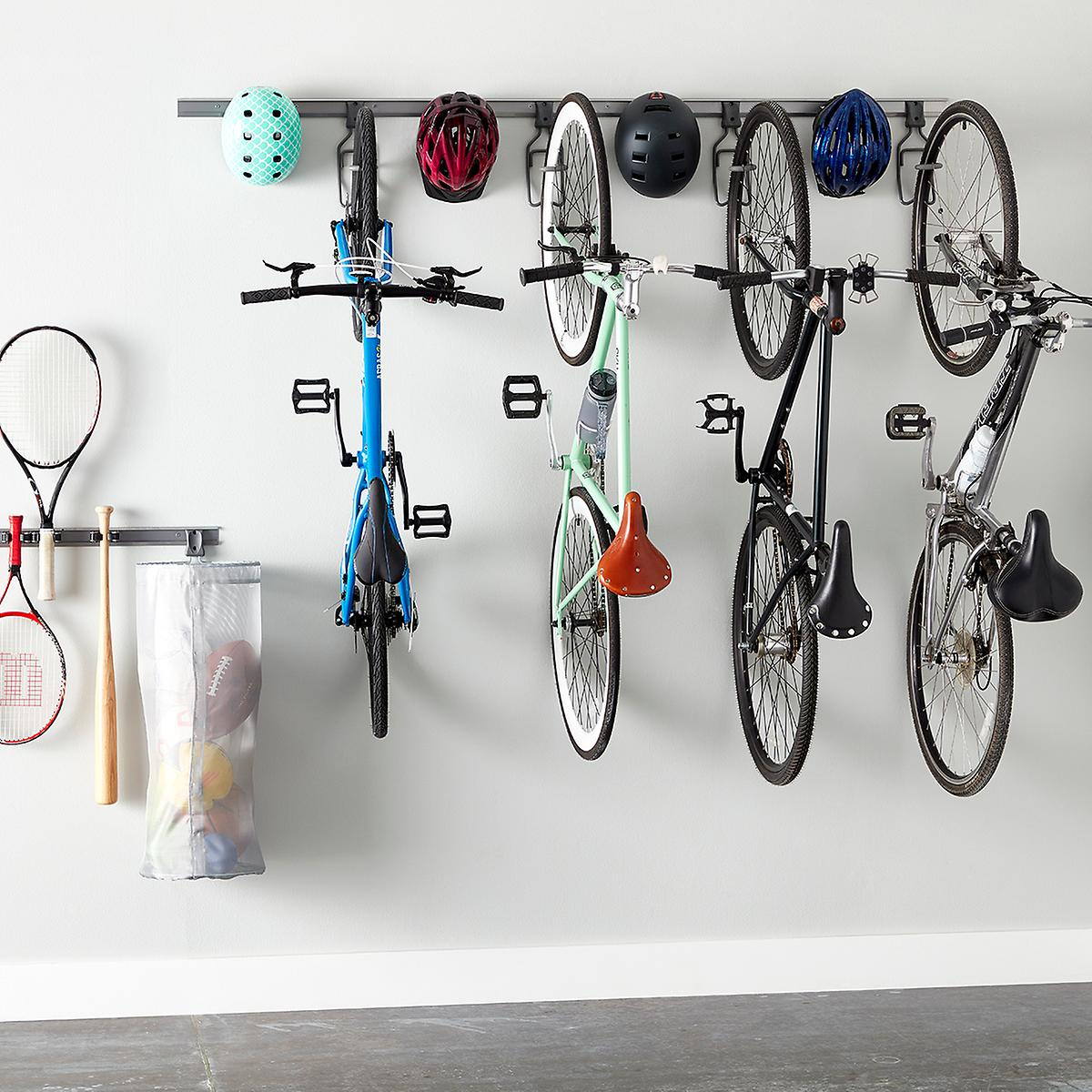

Haven’t seen any recs for prefab bike storage for like, 8+ bikes in a garage. Hanging all over the place like bats is not an option.
See the howbikesyouown thread for context…

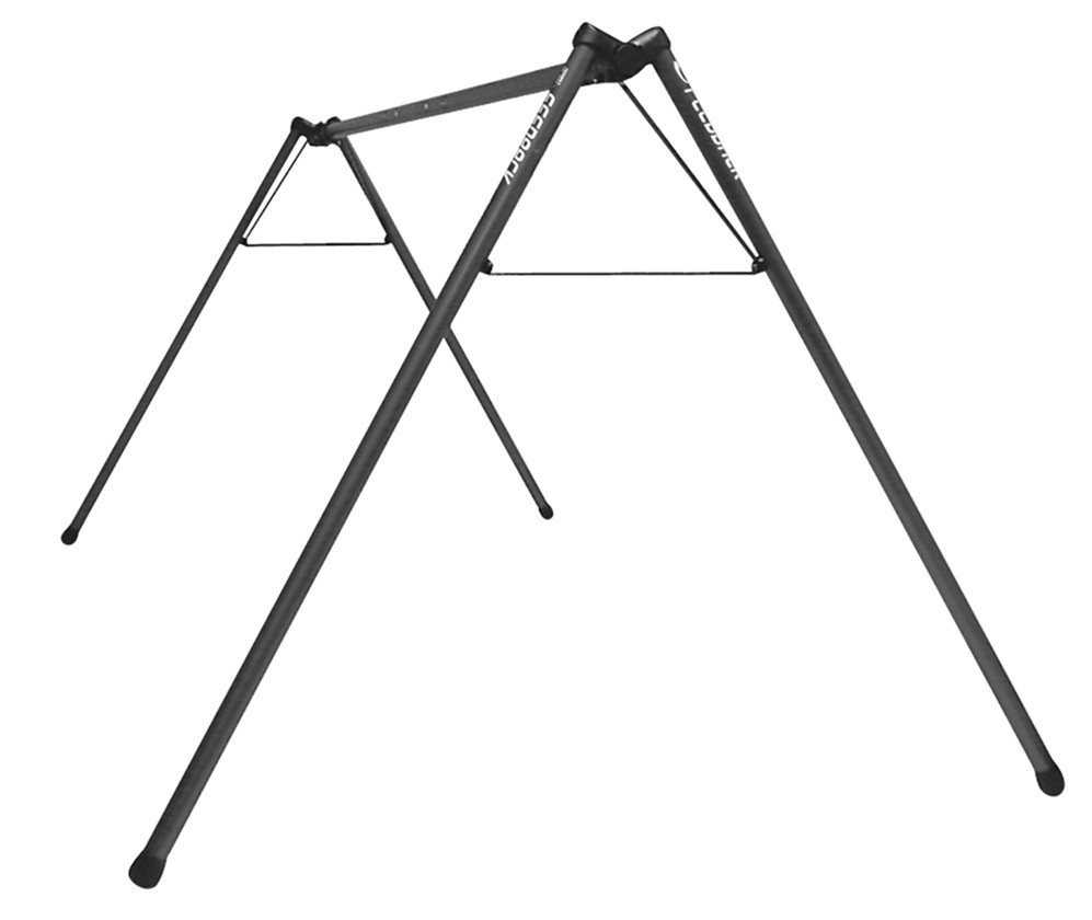

Or something like it. I’ve got a contraption I made from conduit and 2x4s. Gonna go legit once I figure out how long I need it to be.
So get four of these and some surplus pipe?
https://www.simplifiedbuilding.com/pipe-fittings/kee-klamp/10-single-socket-tee

I’m on my 3rd iteration. 1st was 2x4s and saw horse brackets, which weren’t exactly up to the task of holding a 10ft long 2x4 with like 8 bikes hanging off of it.
Currently using 1/2" rigid conduit, which is horribly undersized, but had a stick sitting in the garage so I went with it.
Plan is to buy that feedback stand I posted earlier or to make something if I need it to be longer, which I think I might.
The Feedback is a good portable stand I have some experience with. A group I know in Madison did manage to break one by loading it down with an unremembered number of hambieks at a hambiek-specific event, but they made good with free replacement parts and friendly service.
The site says “up to 8 bikes.” I put on 7 with my personal hambiek in the middle and it seemed to be flexing more than I’d like. Still a major improvement with minimal dithering for me. Will try additional measures to break it and report back.
