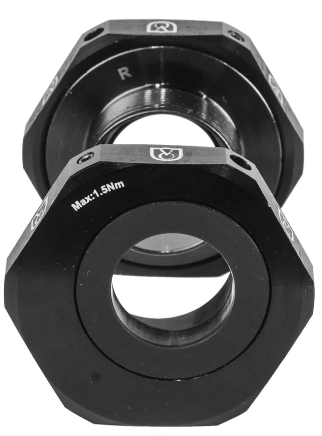

Is there any way to run a square taper spindle within these V-O BSA eccentric 24mm spindle bottom brackets?
Maybe if you get a press fit reducer made for the spindle? That seems like a major failure point though, and I don’t see how you would account for any preload
about as successful as any other external BB for a 24mm spindle. how you gonna get your cranks on? you’ll have the widest stance.
Phil centric?
yes there is definitely a way
these cups will have 6805 bearings at 25x37x7 with delrin sleeves down to 24mm

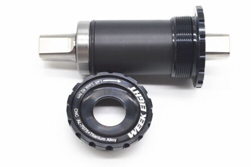

the artisanal and/or aliexpress square taper BBs all have a 6903 at 17x30x7, normally preloaded naively by spindle having shoulders for the inner races

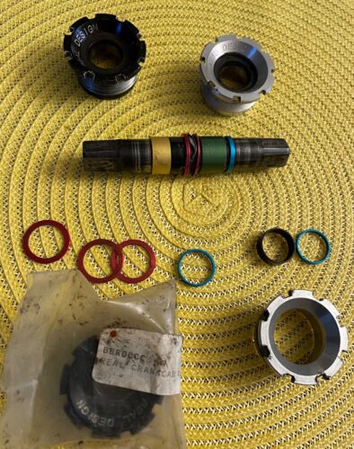

there isn’t naturally a 17x37 bearing available, so the right thing to do would be to turn some press-in 30x37x7 sleeves on a lathe, while harvesting the spindle and bearings from something like this or a Phil/White/etc:
given that the bearings are likely spaced further apart you’ll likely need to shim the spindle inside to locate it properly, and this would give you a whole construction kit for that if 107mm is the spindle length you need:
