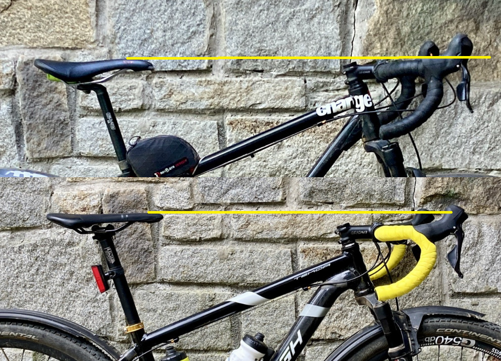

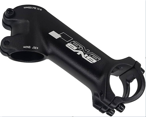

Anyone use a -35° stem to get position lower in front? The yellow bike is the best handling bike I have and I think mainly bc the relatively large bar drop puts a lot of weight forward in a way that feels good and improves front end grip.
The top bike handles ok but not great and can certainly be improved. Thinking I’ll try a -35° stem which will be about 25mm lower and 15mm forward and maybe shift handling a little closer to the other bike.
I’m not a fit expert but I might try a longer stem before a deep drop stem for this

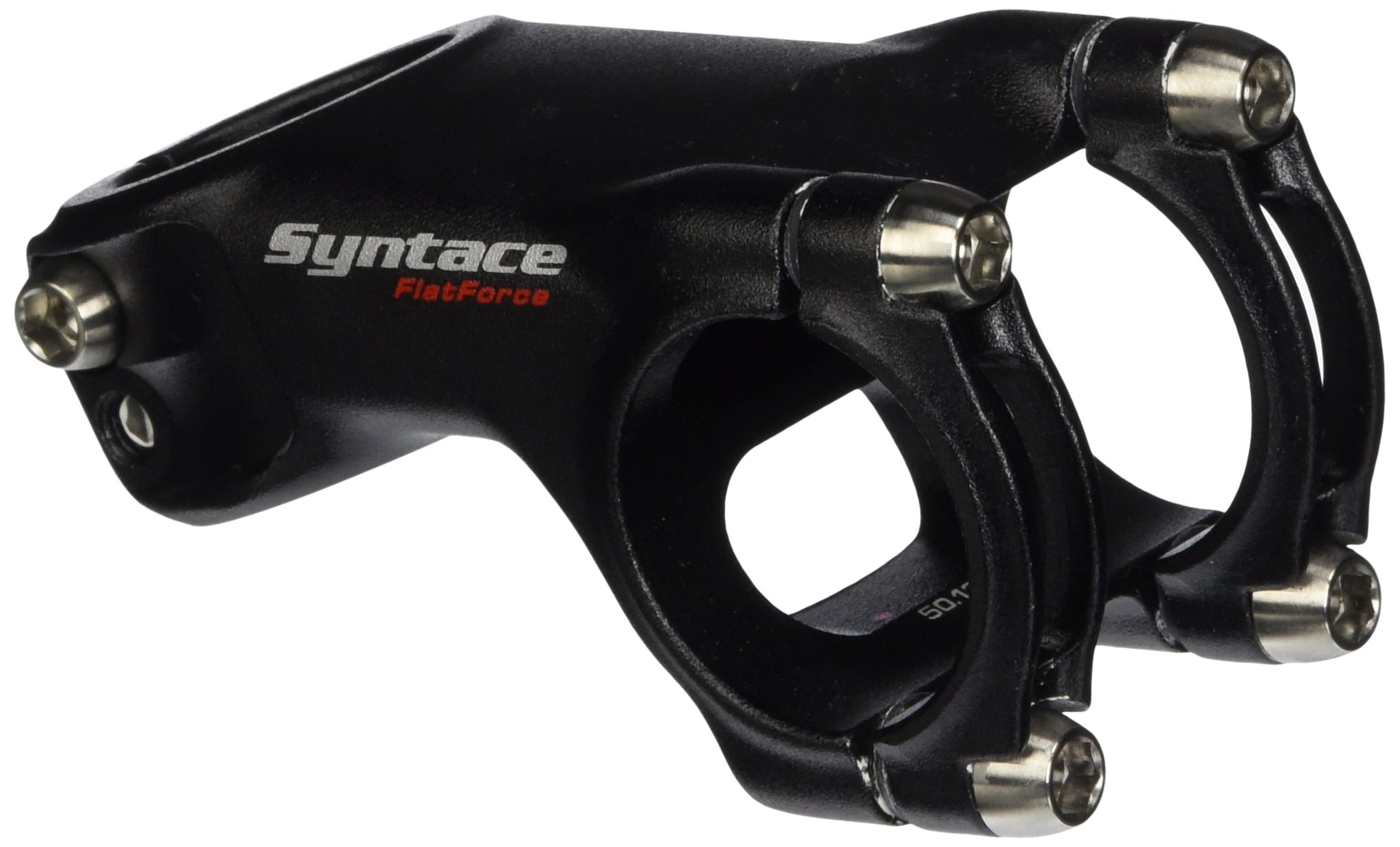

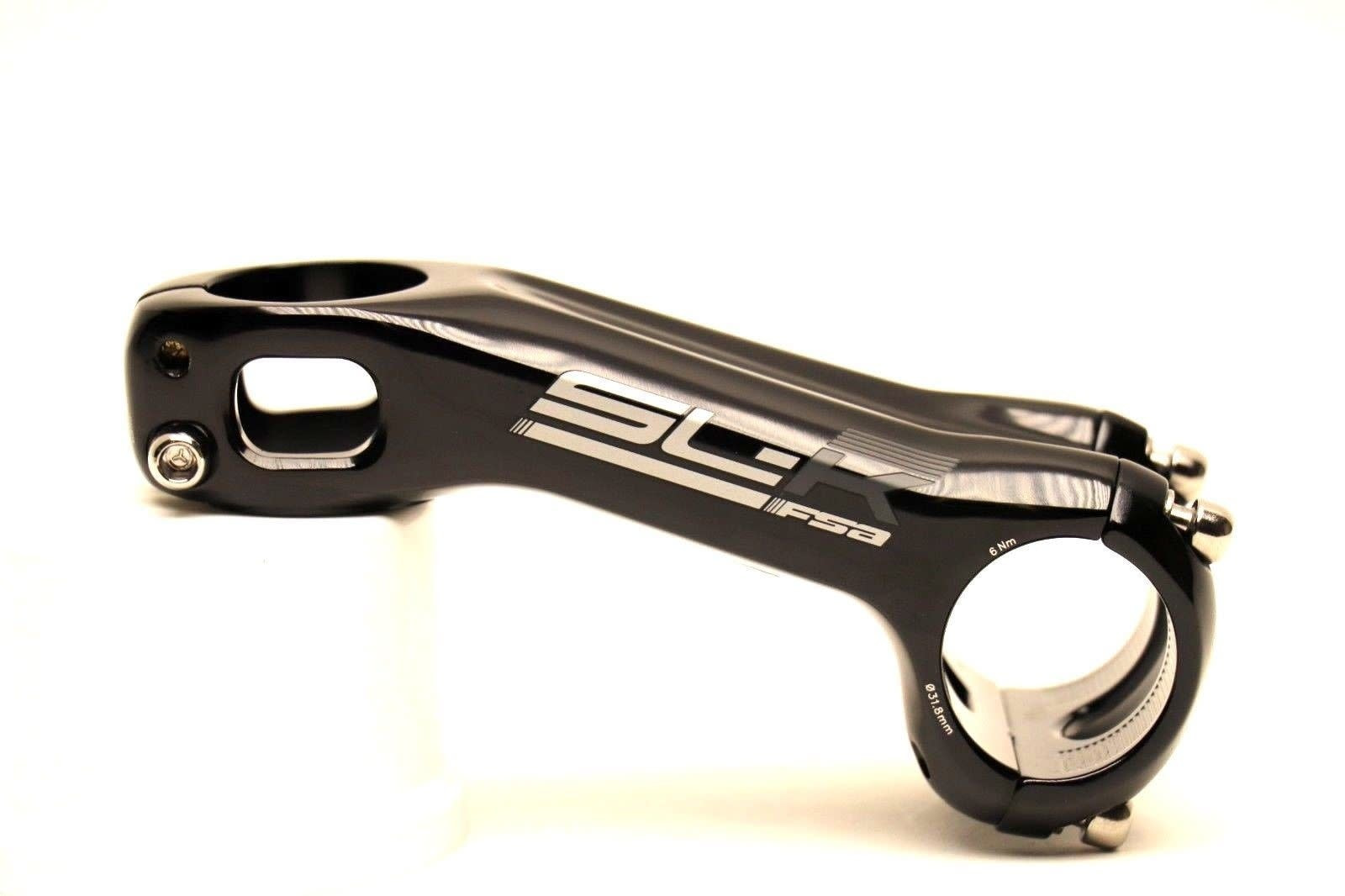

syntace flatforce or FSA sl-k drop

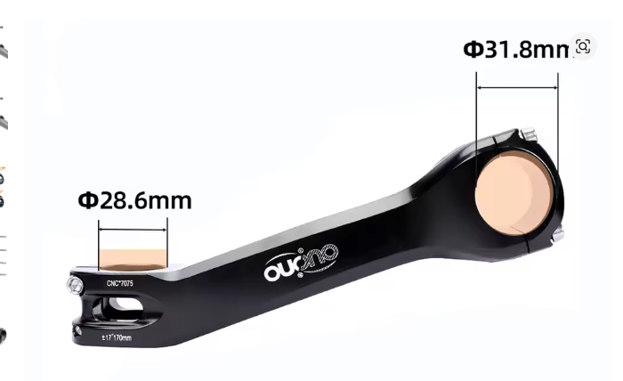

https://www.aliexpress.us/item/3256806384204349.html?aff_fcid=ea04a0acc9934f2eb3faa9a92735f99e-1778197501946-04335-_c3XddE9d&aff_fsk=_c3XddE9d&aff_platform=api-new-link-generate&sk=_c3XddE9d&aff_trace_key=ea04a0acc9934f2eb3faa9a92735f99e-1778197501946-04335-_c3XddE9d&terminal_id=d3b526b0984f4c968aa5c5d5efac9978&gatewayAdapt=glo2usa
Yellow bike also has the saddle on a straight post, that might contribute, presuming seat tube angles are similar?

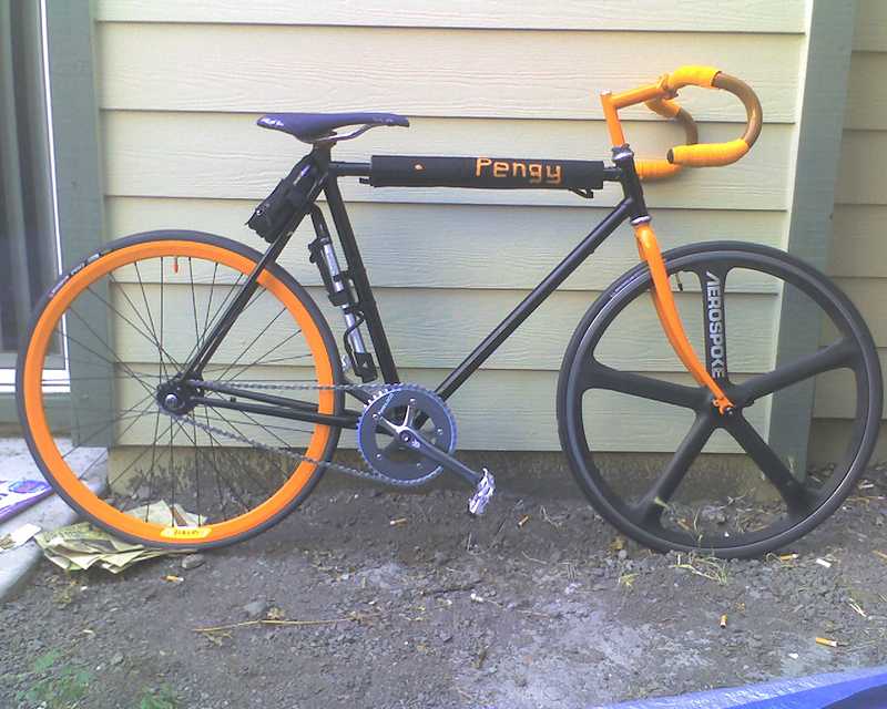

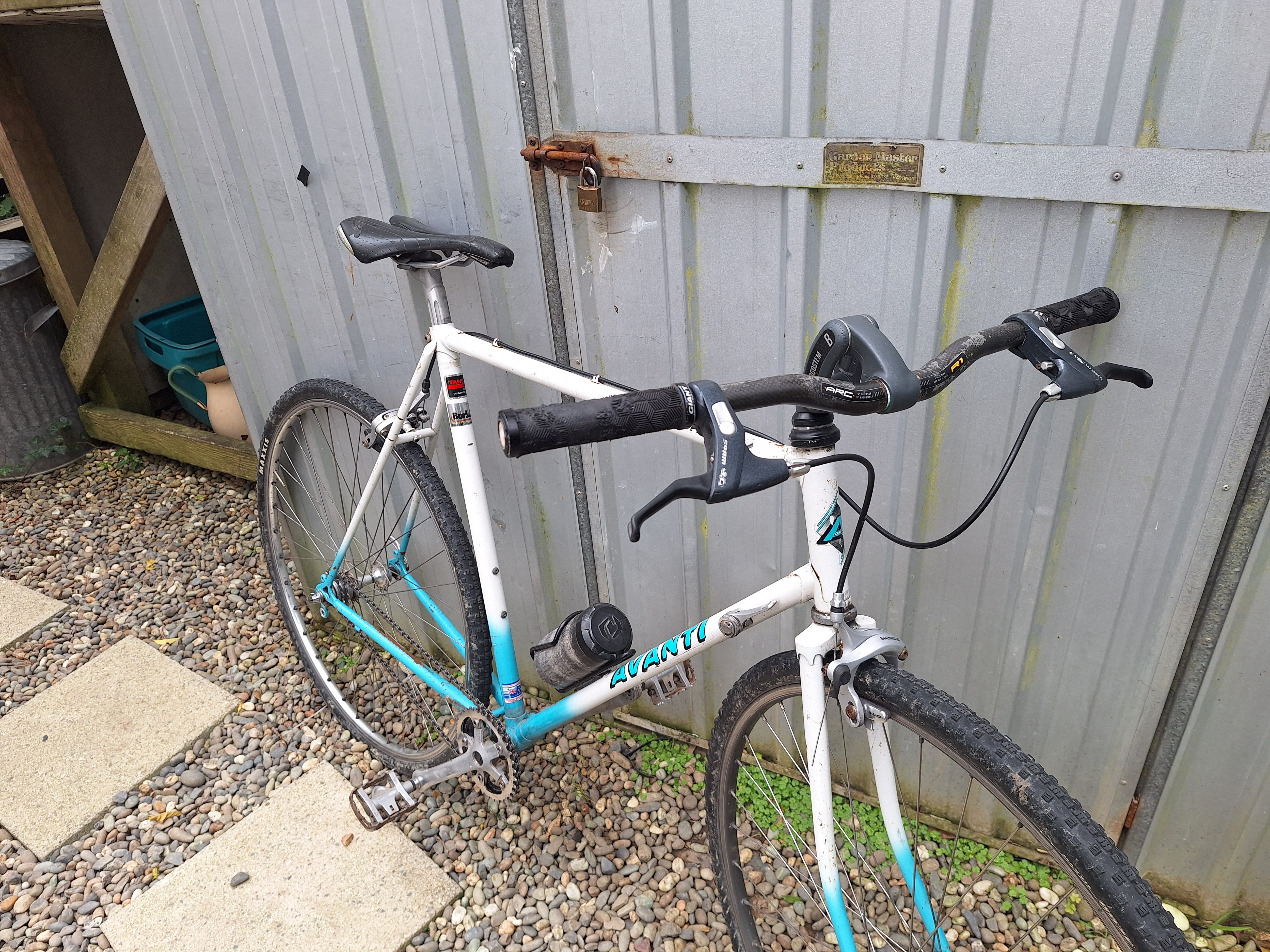

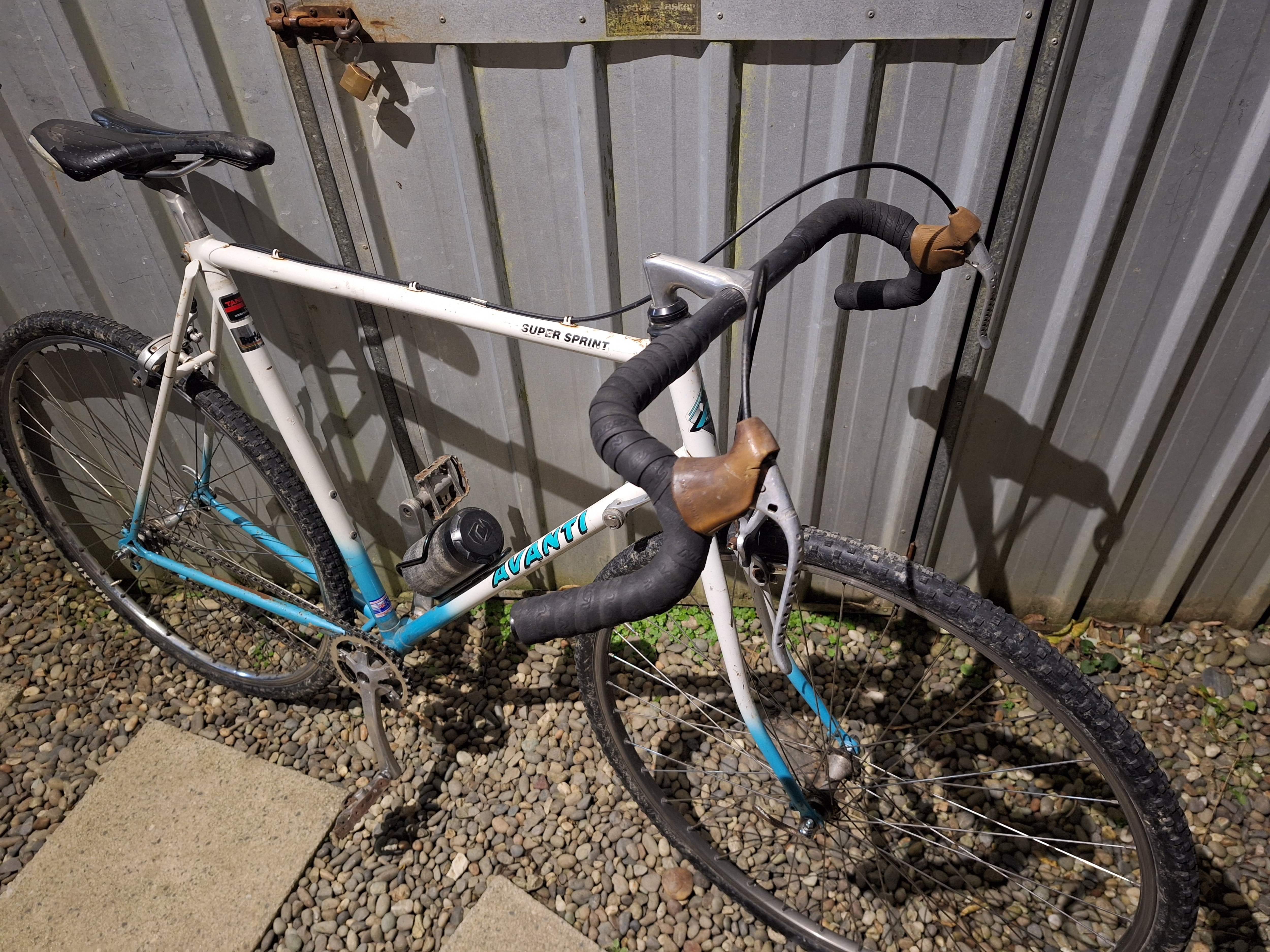

Ok. Finally stopped dithering. Took the ergo off and went with the woodchipper otherwise I will be categorized as a non-CX bike. Ordered a fixed 17 cog so I can go proper tracklocross.
