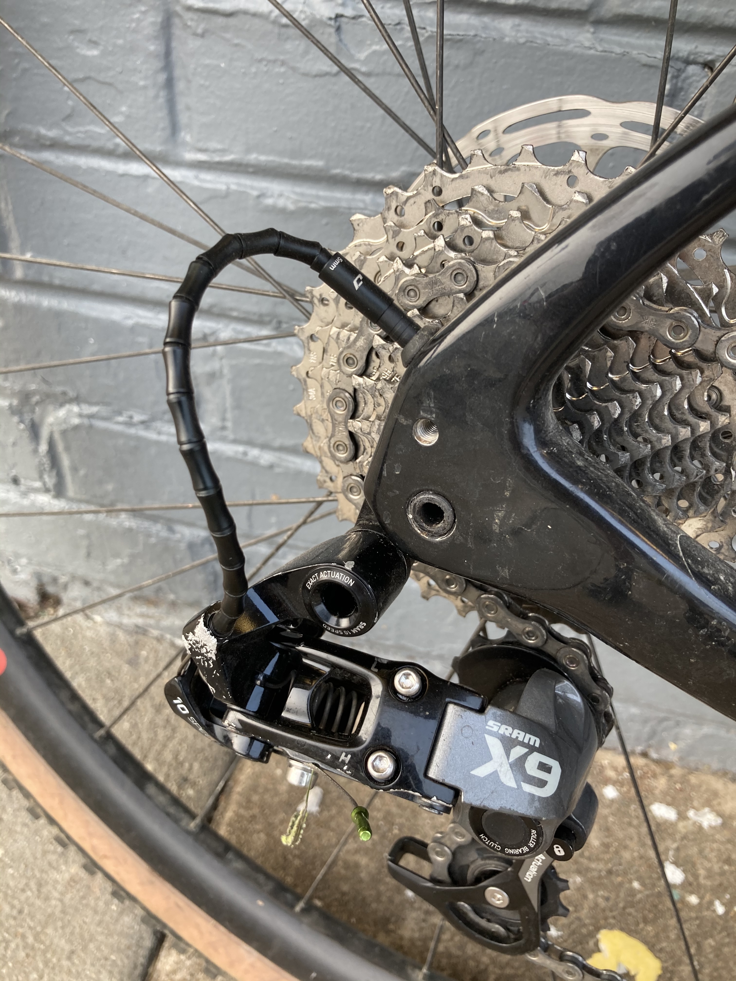

Two rides on this mess. Works great.

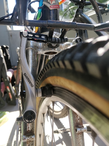

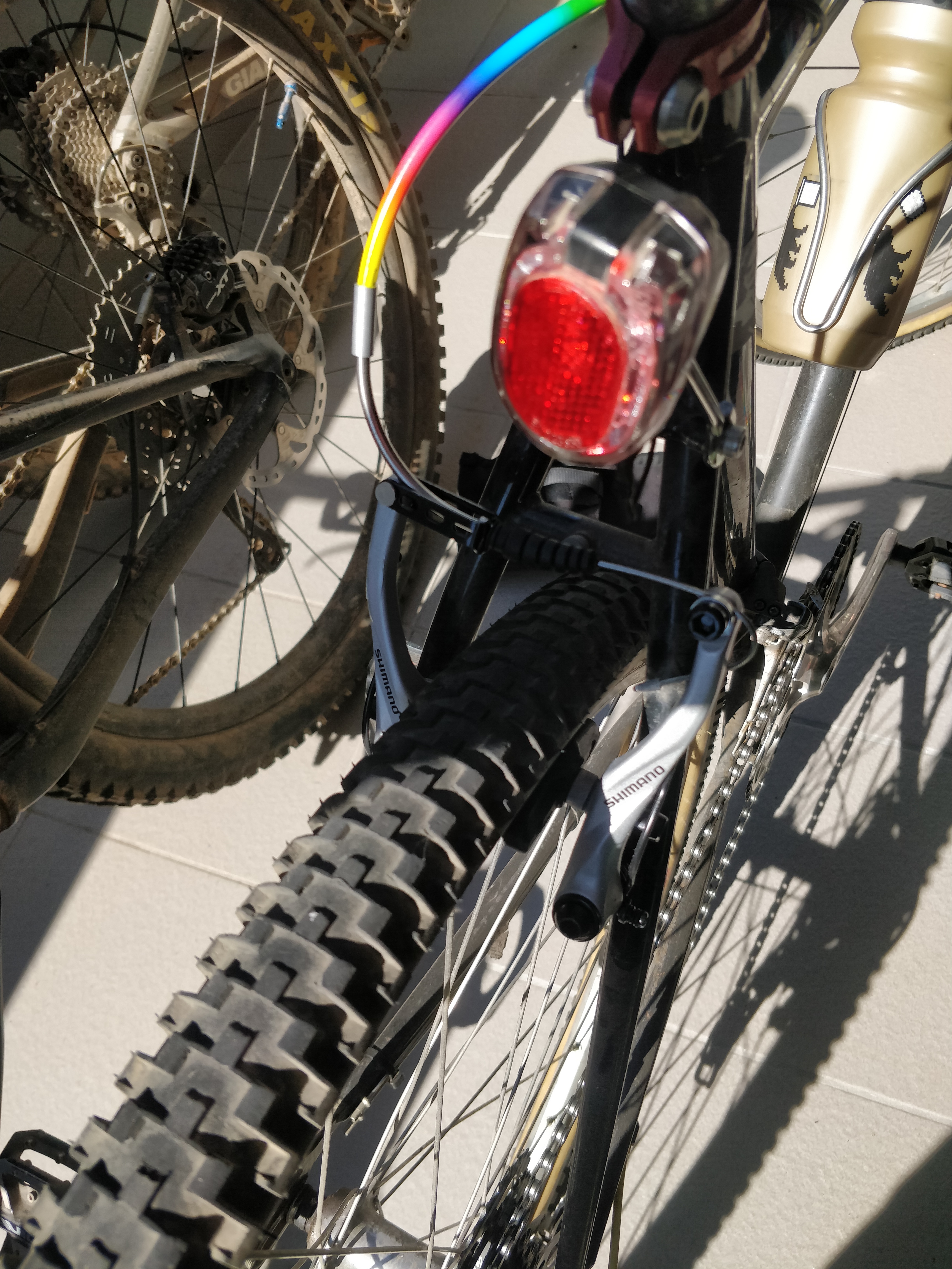

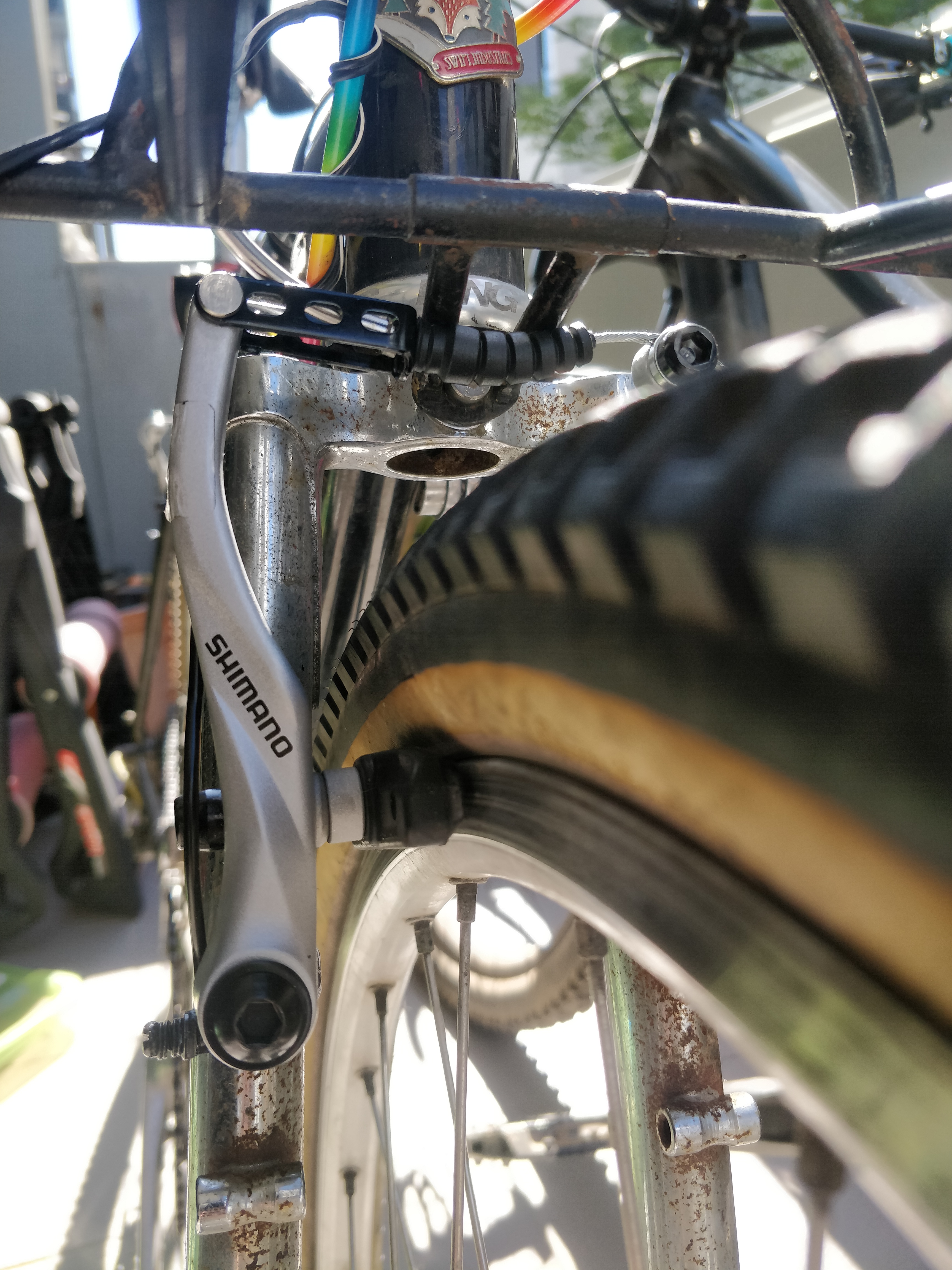

Put a front disc on my sweetfixiebro

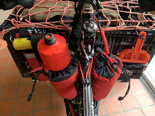

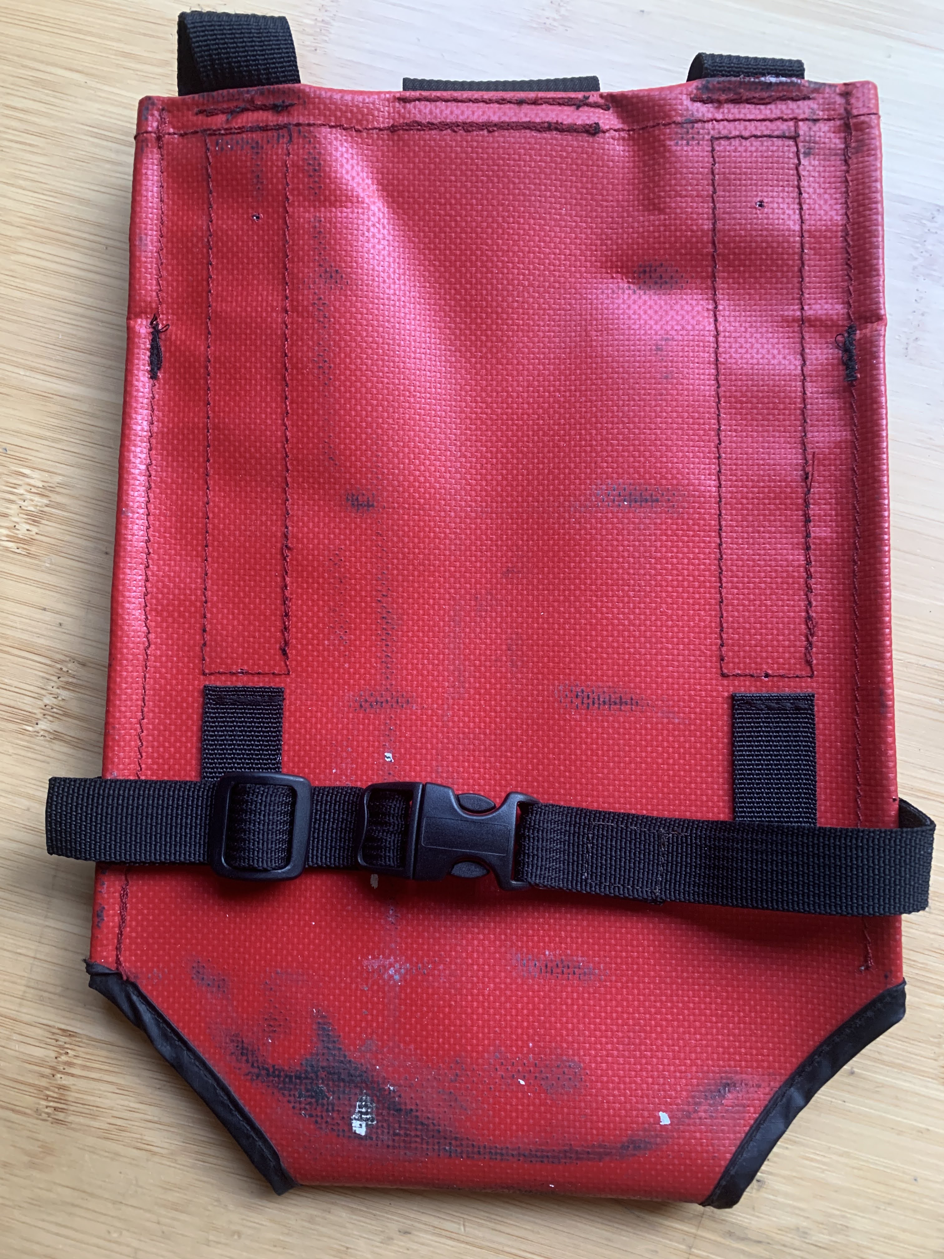

Speaking of that holster while I was doing 10 sewing projects last week I replaced the anti-swing strapping on it. The original design is terrible and loosens so easily from vibration so my lock was always loudly slapping the basket when going over bumps. I cut the webbing in a few places, moved the slide and added a buckle which combined shouldn’t let any slack out.

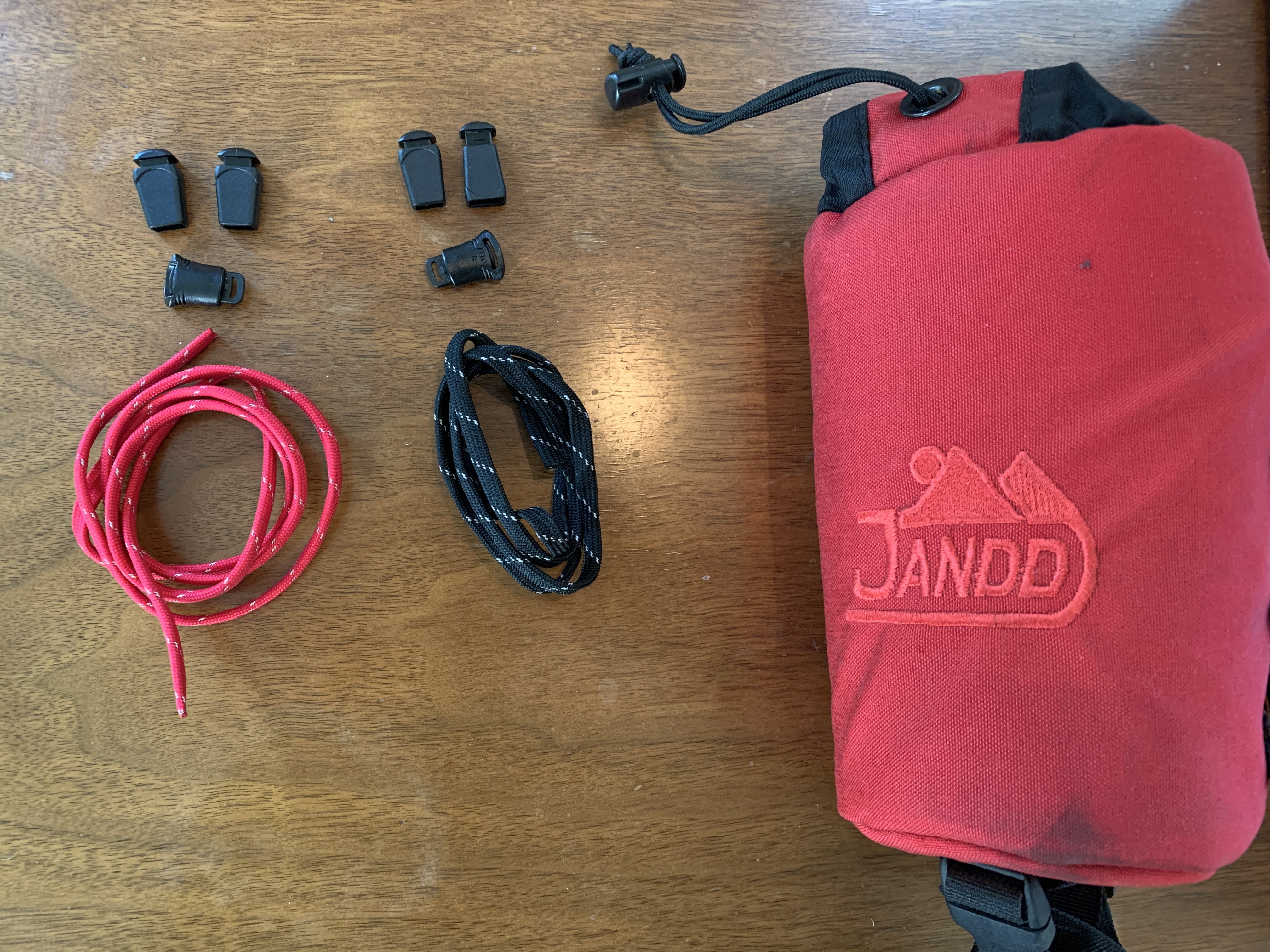

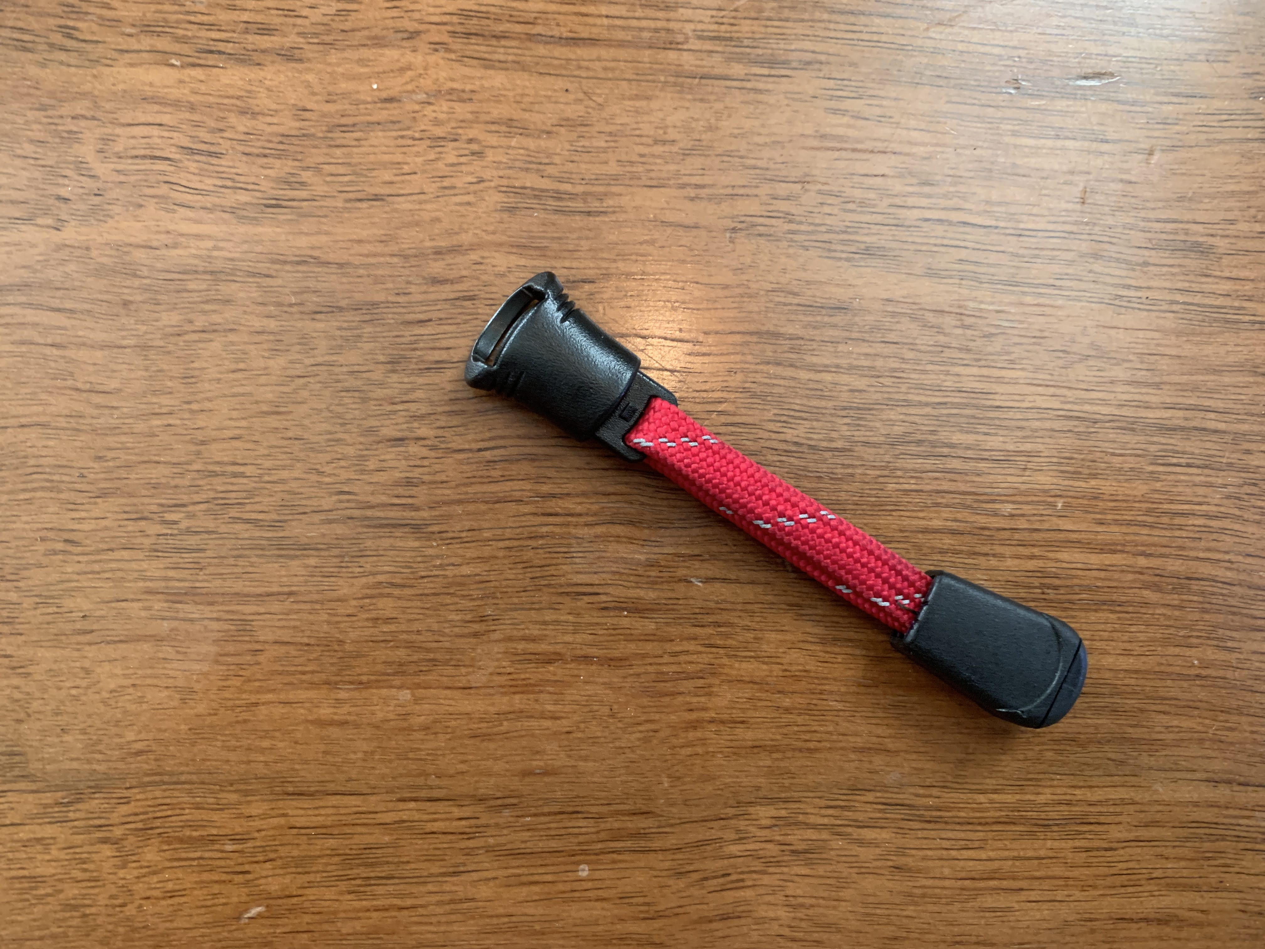

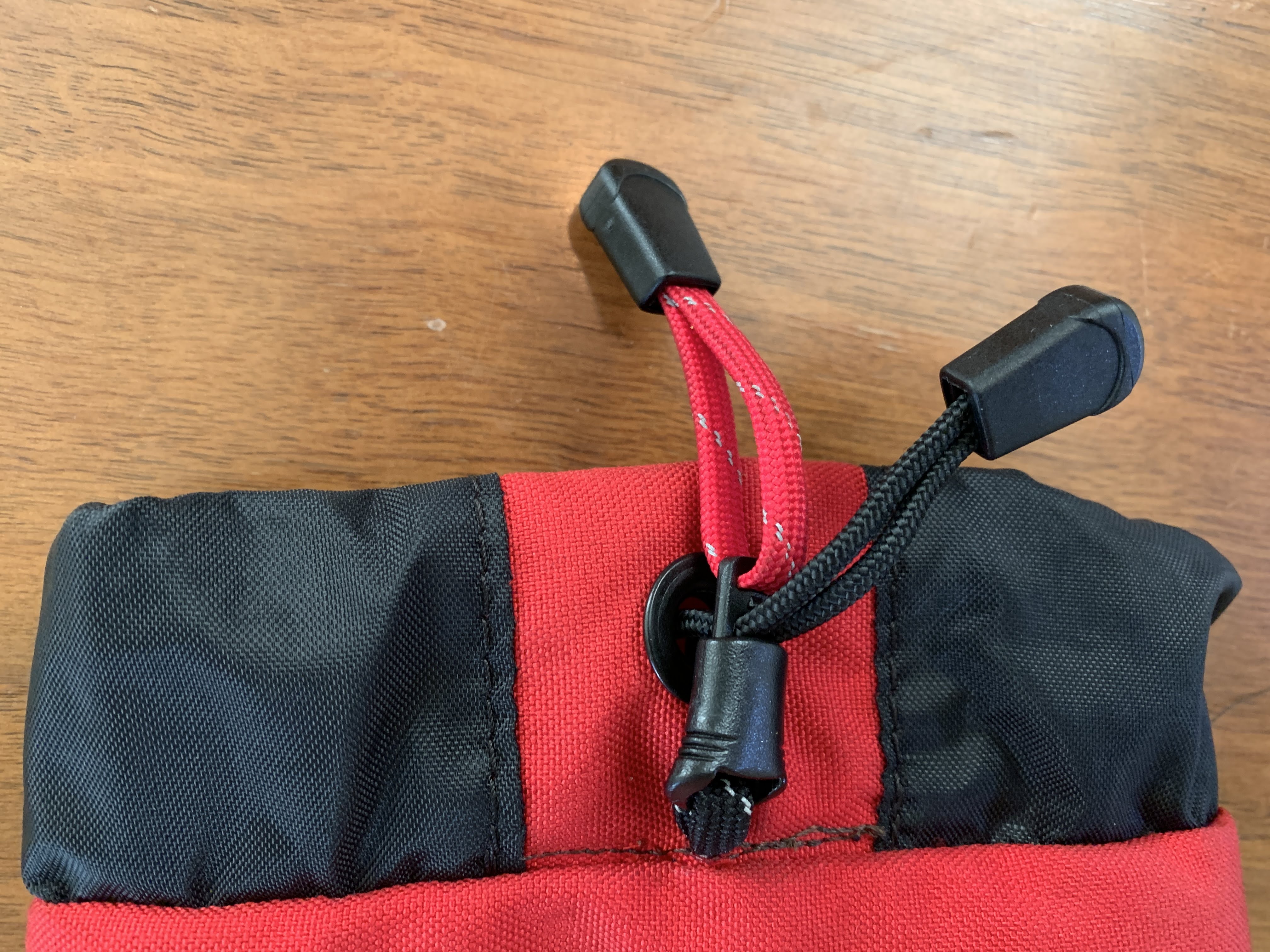

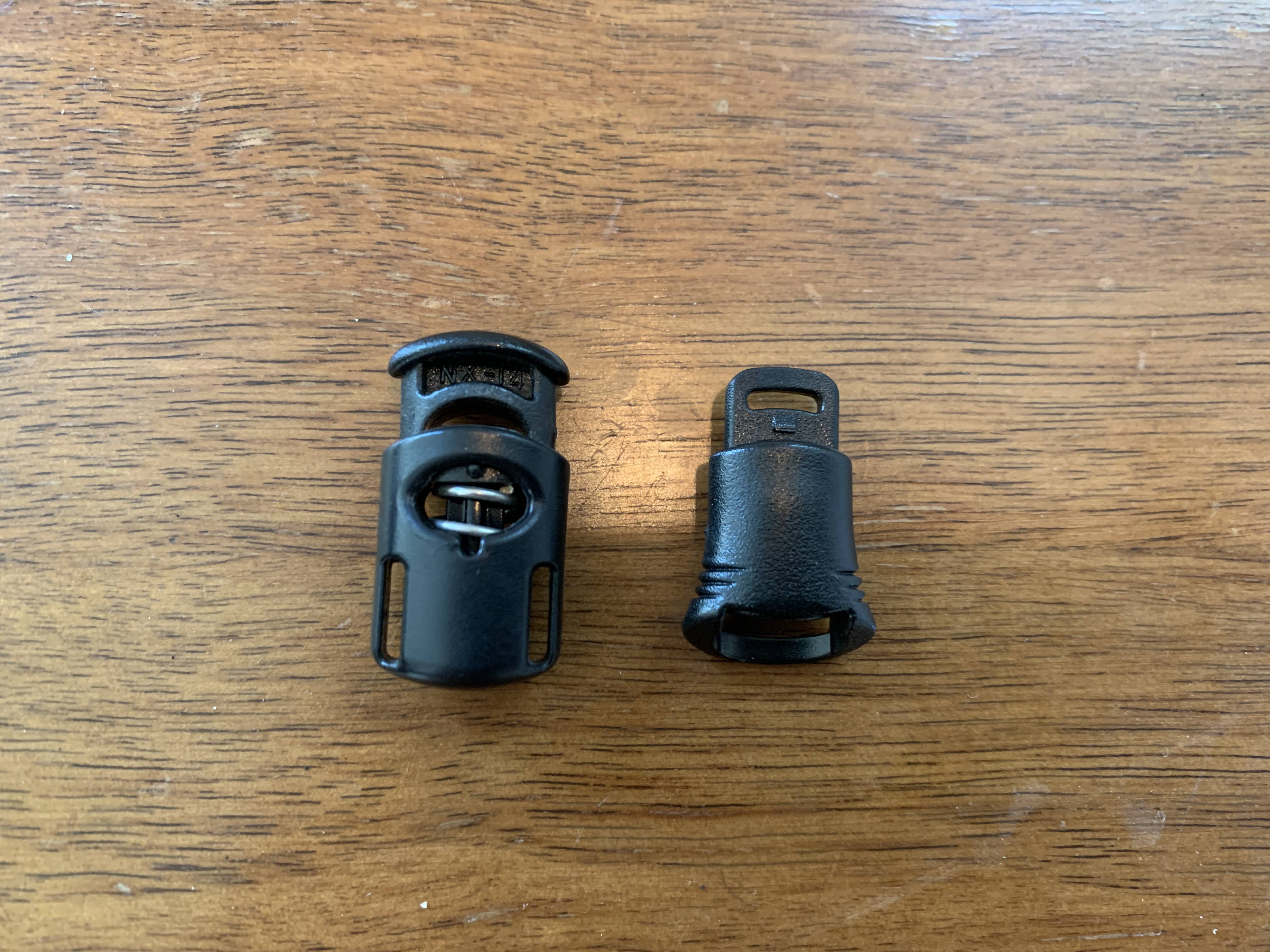

Another project I finally completed was retrofitting some on-sale Jannd feedbags to be one-handed operation like the Revelate feedbags using some Cyberian Cordloc.
Long time ago I picked up some 1/4" Medium Reflective Polyester Lacing & Plastic Zipper Clip Extension from Seattle Fabrics.
This is probably me not paying enough attention to the product photos before buying, I was very surprised it didn’t have a buckle on that strap when I went to play with attaching it to the crate.
Jagwire elite link.
Very good, at this point I regret not putting an inline adjuster in my right-side cabling… stupid really, given my potential to dither.
