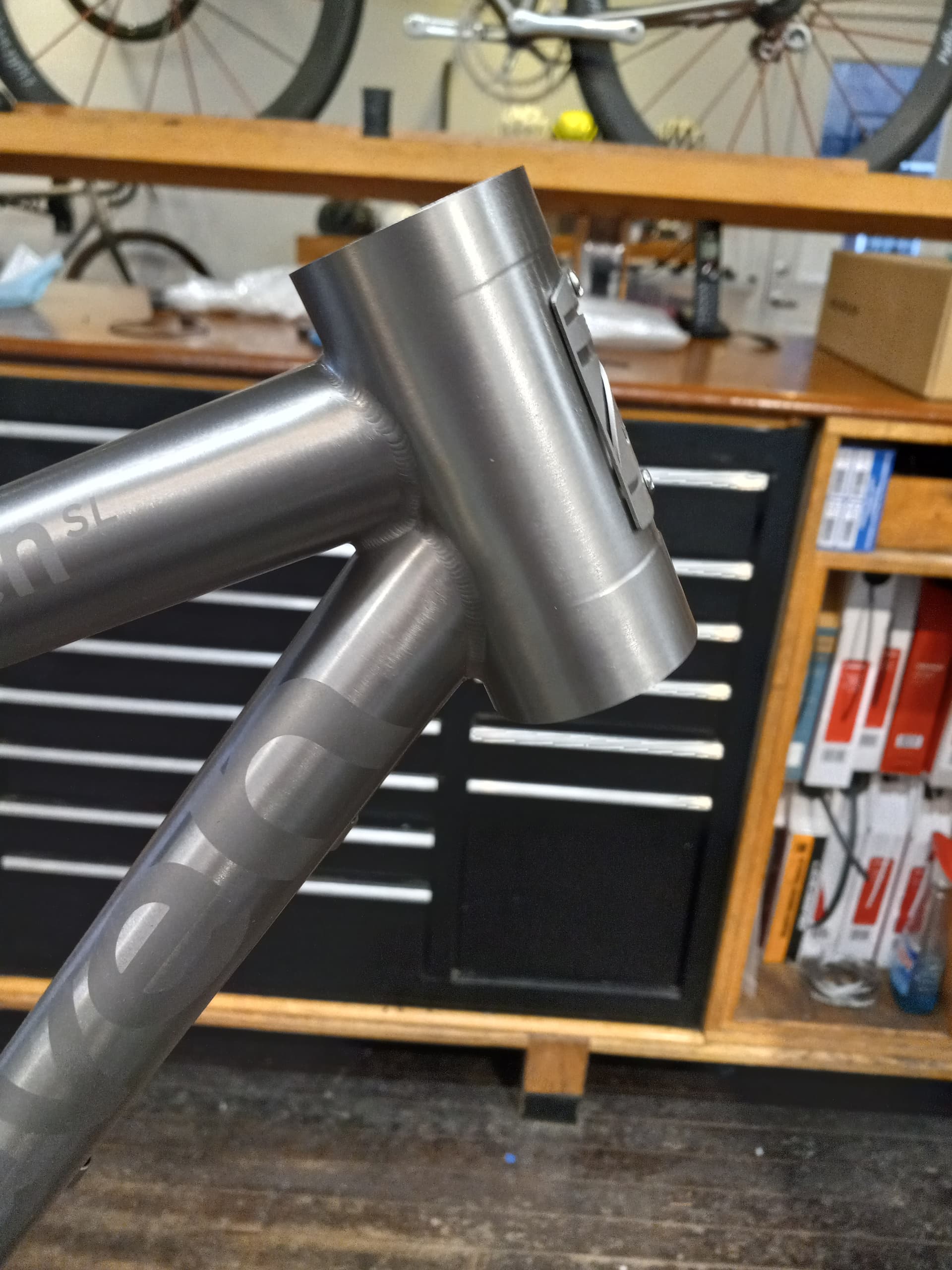

I pulled it out of the box today and started to inventory the build kit. I will mock it up tomorrow. I don’t remember the woman being super short, so she must be flexible AF and have an extremely aggressive position.
That’s the smallest head tube I’ve ever seen on a seven
