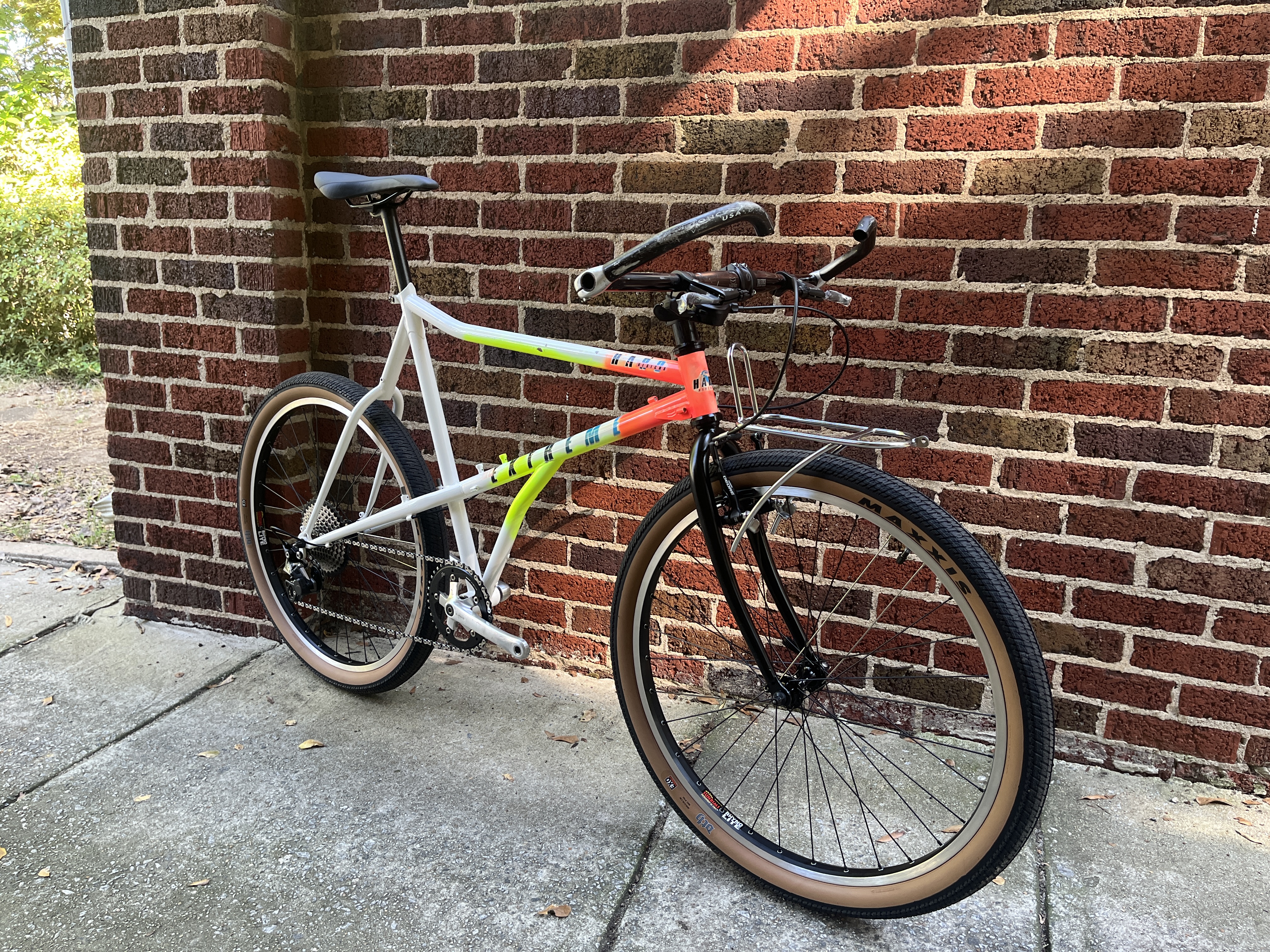

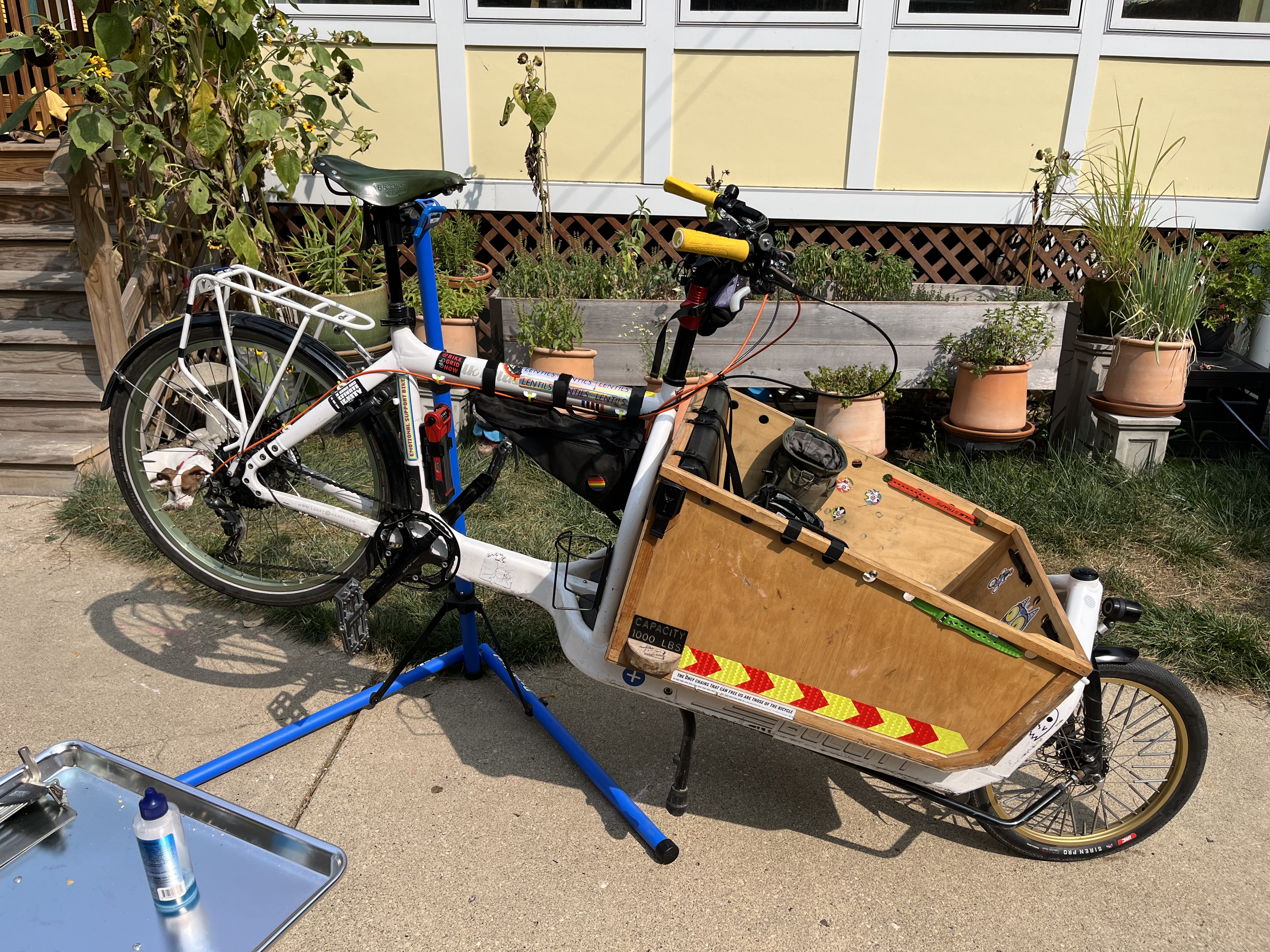

Cleaned and did some maintenance on my filthy filthy bakfiets.
Clemmy helped.
WTH: I forgot to replace the frayed dropper cable that I put the bike in the stand for in the first place! What is wrong with me?!?
Drivetrain and front brake is on so I actually got to ride it around a bit.

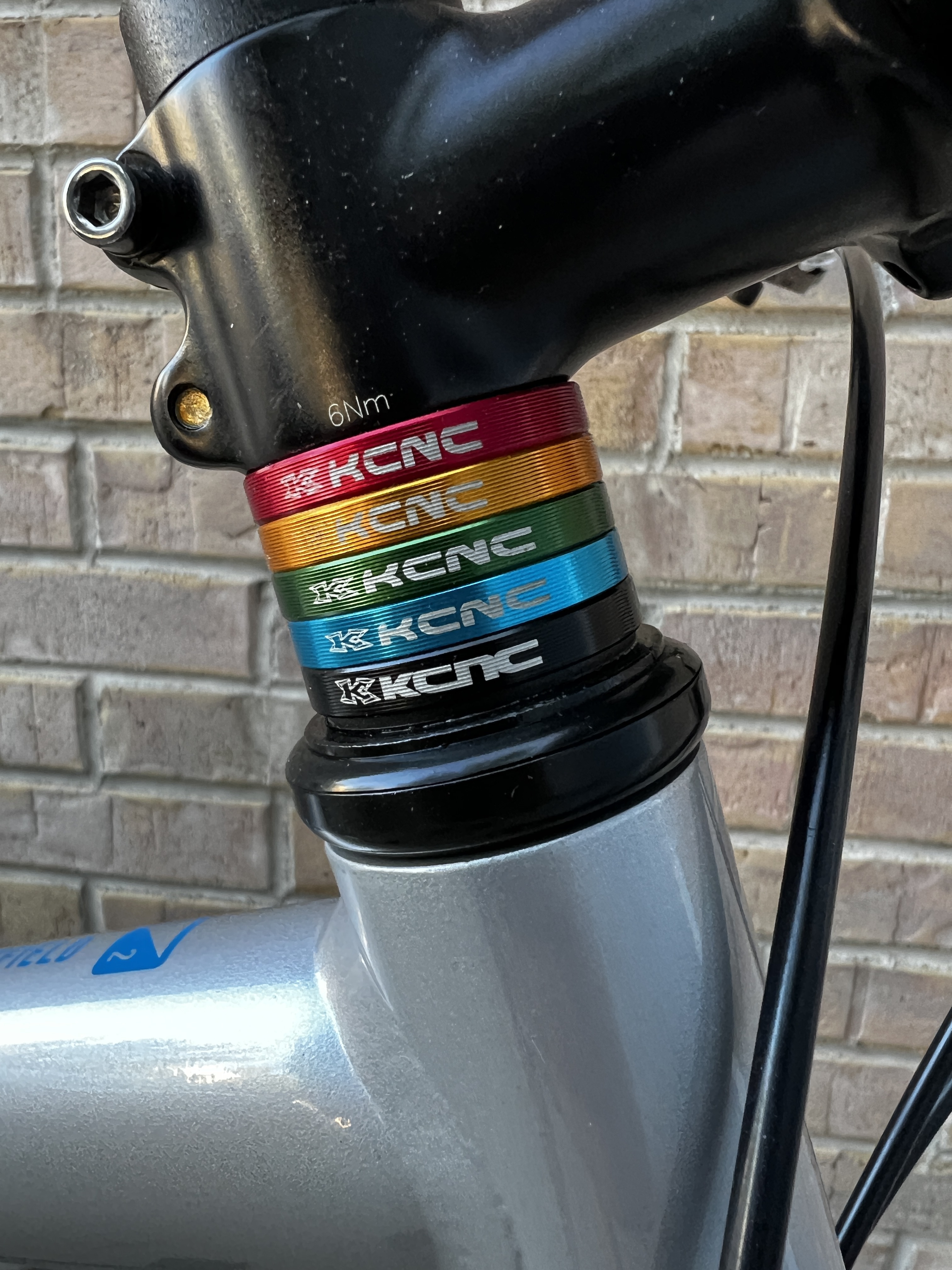

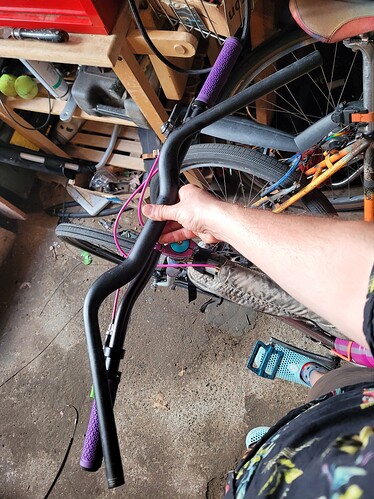

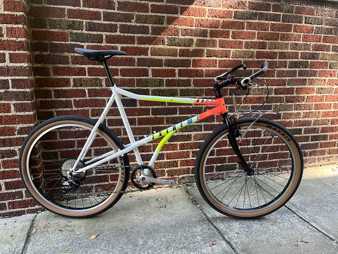

Confirmed that the handlebars are indeed way way way too low. Trying to decide between getting a new fork with a longer steer tube and keeping the sweet original cockpit or just buying a set of Surly Sunrise bars.
Sunrise bars will give at least 76mm of additional height, and if I remember correctly the Sunlite forks at JBI have 250mm steerers so that would give me 65mm additional vs the fork I have now.
Here’s alternatives to the Sunrise bars with the same vibe, with butted tubes that are probably lighter:
Stooge Junker 85mm
Stooge Junker 100mm
I’ve got a set of bobbed surly clunkers I could measure if you’re interested

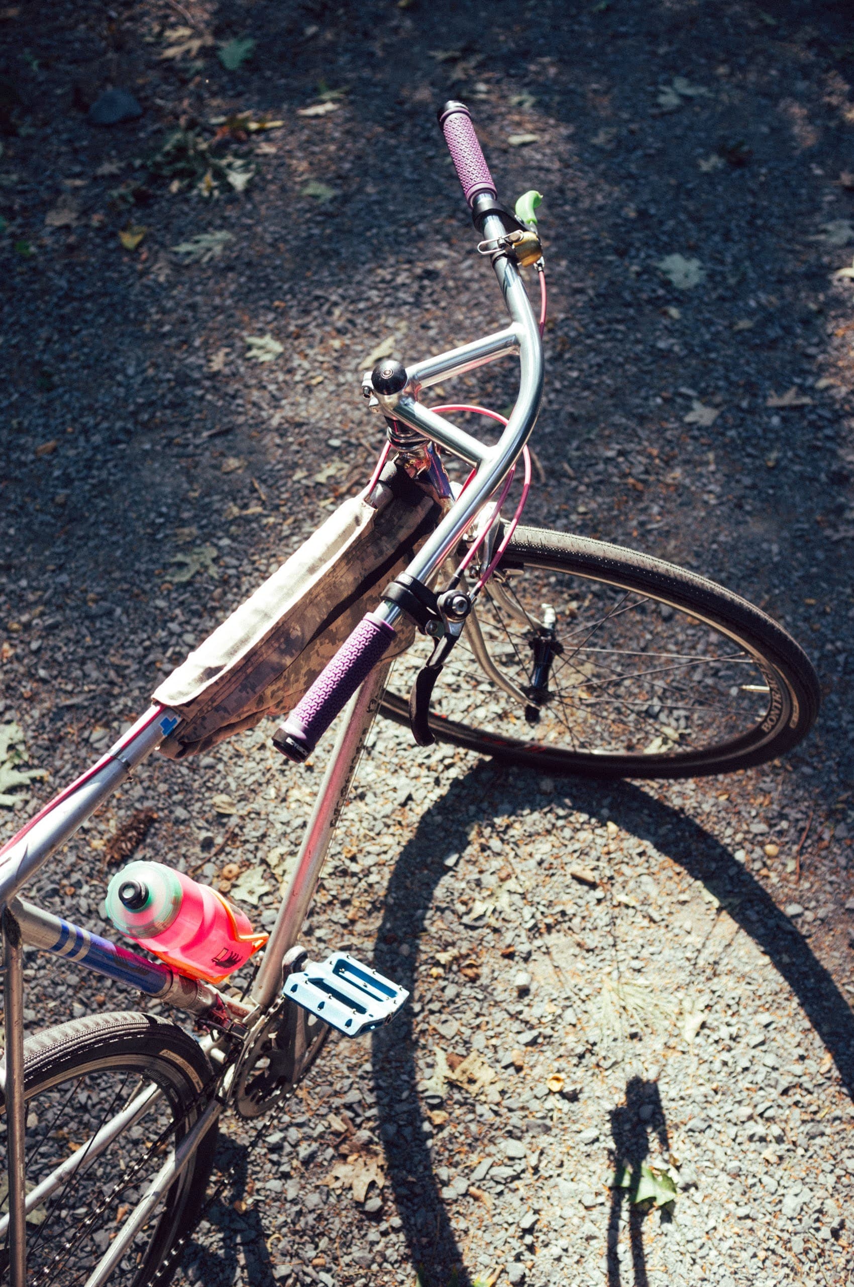

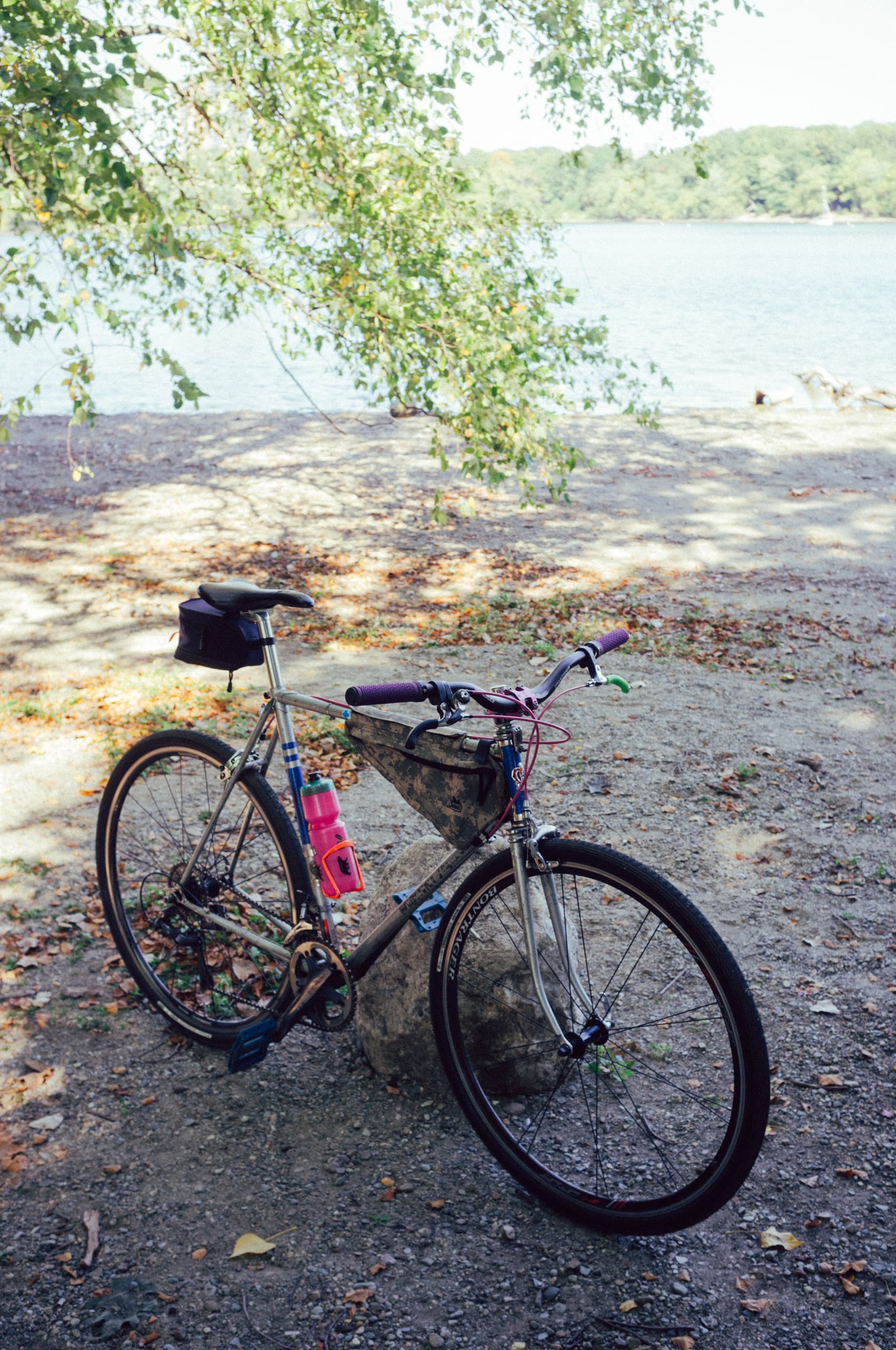

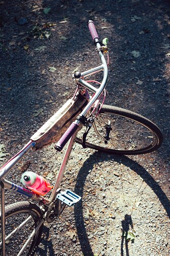

That’s looking damn good. It’s really hard getting old school forks with any height to them too. Crank looks mint too.
Thankfully this frame takes 9/8 forks - I ended up having a cheap unicrown CRMO fork ordered so I can get the bars up a little higher but still keep the original cockpit.
Rumor has it the fork might be here today, so I can finish everything while it rains all weekend.
They have some fun clamp colors available too for adding flare.

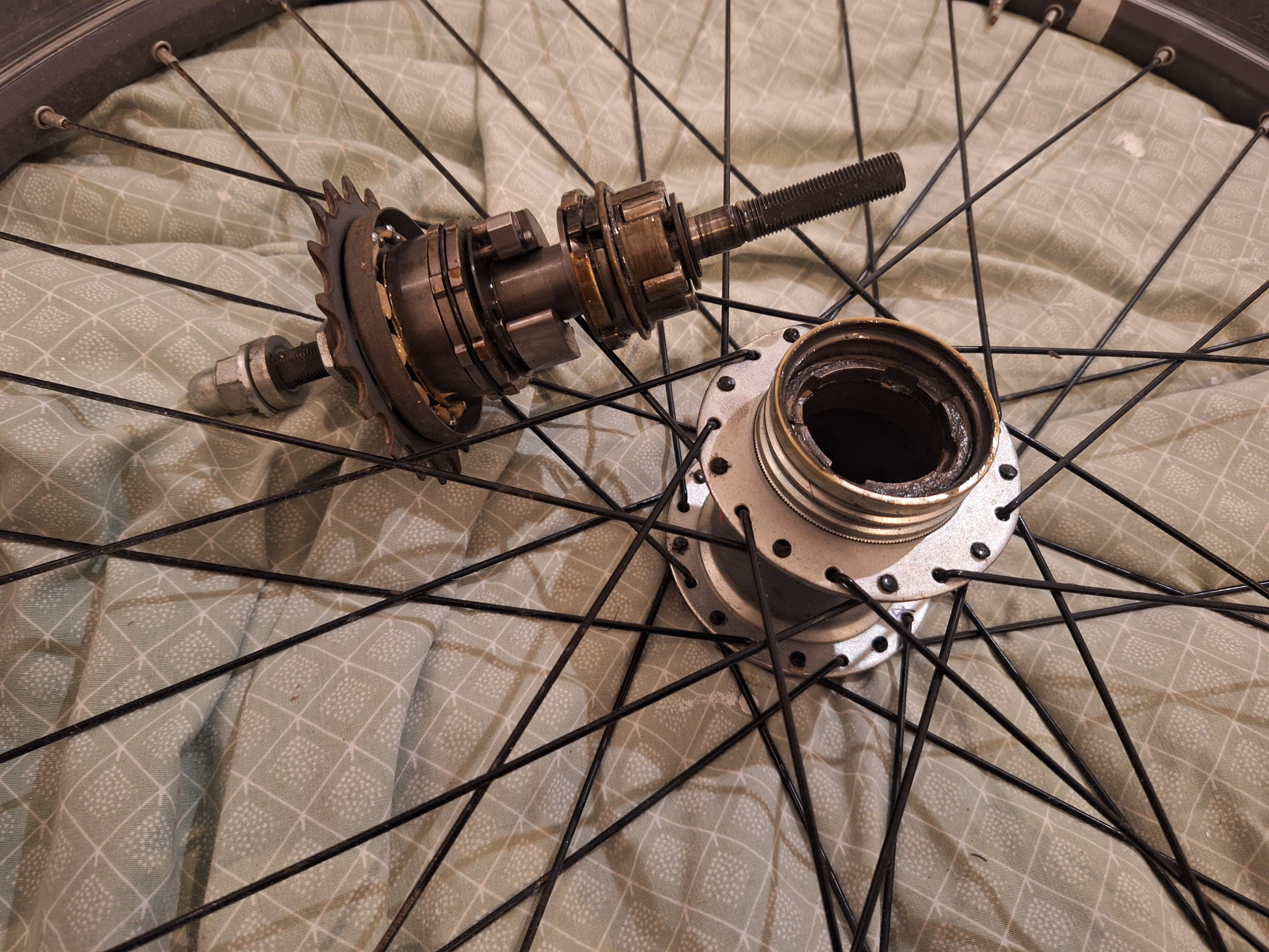

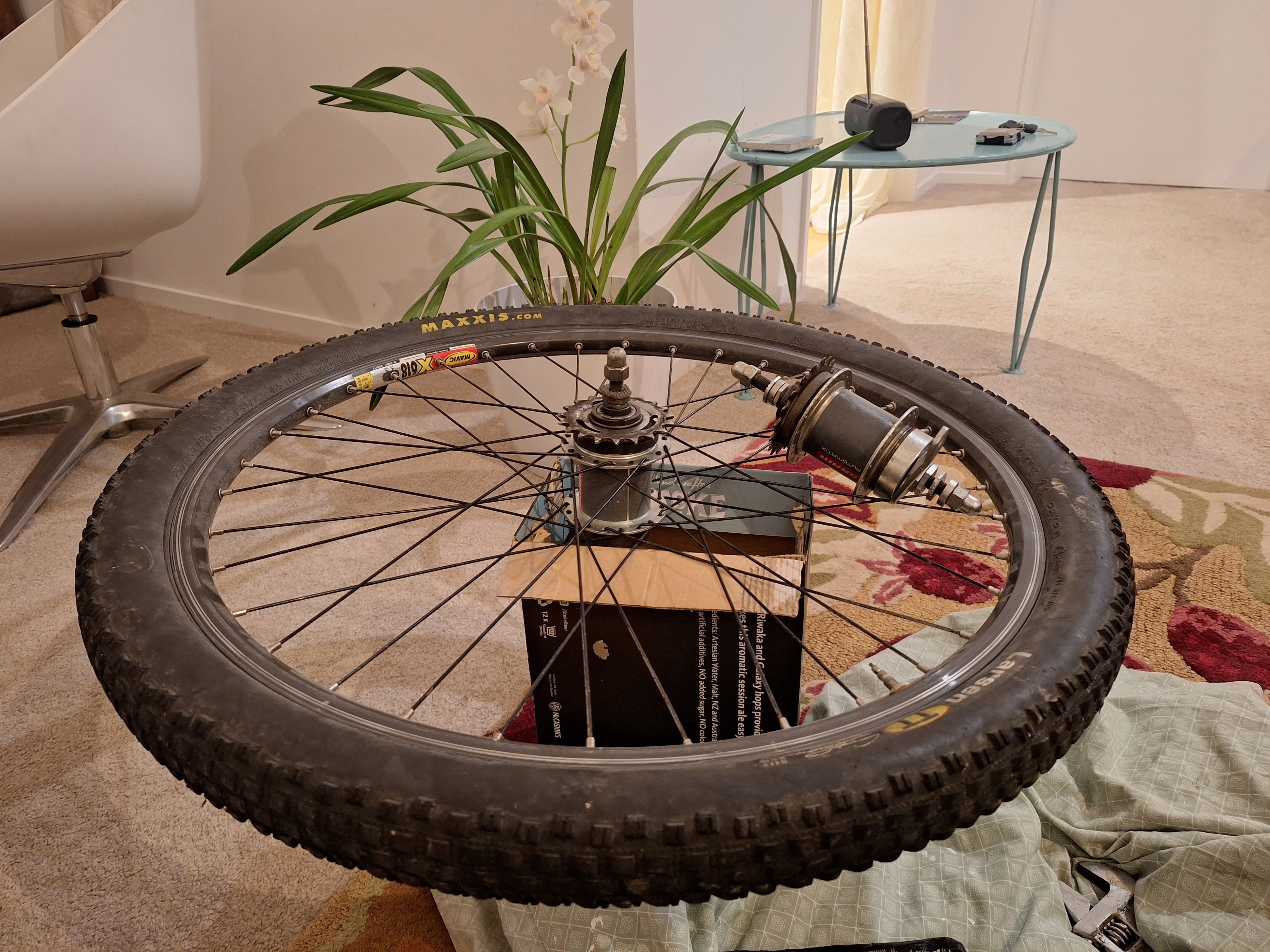

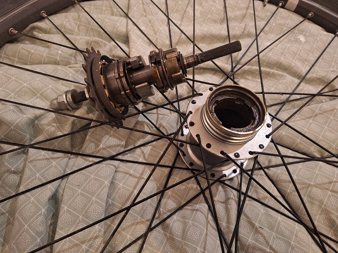

Transferred the guts from a non coaster 2 speed auto hub into my coaster hub wheel. Will give the donor hub back to the person who gave it to me, as all he wanted was a coaster anyway, and I didnt. Very straight forward, hub bodies are identical.
Your partner is very tolerant.
It cuts both ways. She had a melt down last night because apparently after 38 years of marriage I still dont know she doesnt like flavoured potato chips… that was before I got my wheel out. I dont normally do that kind of stuff inside.
edit: already changed them again
