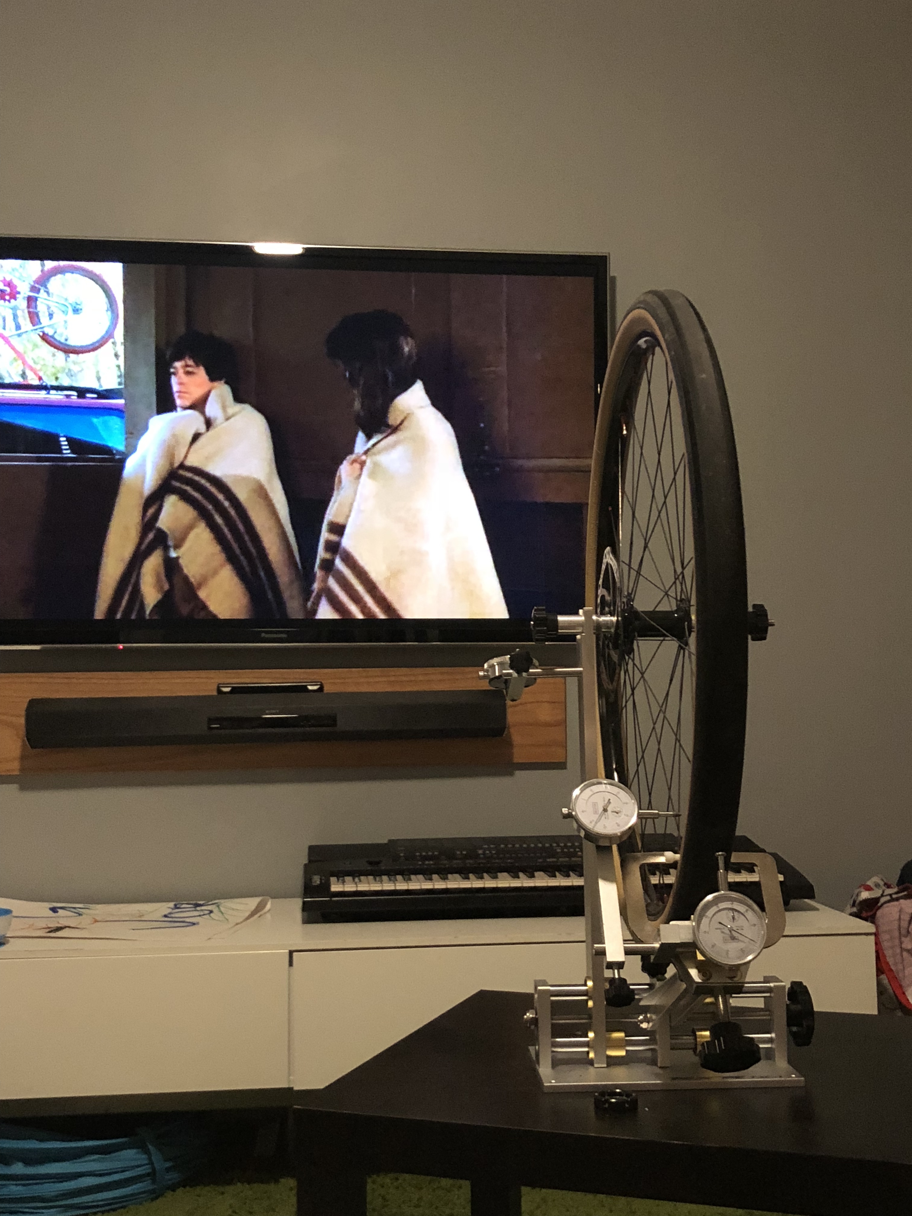

That is one bad ass truing stand
So do you like the new stand so far?

Yes. It is pretty fancy. It’s easy to see if it’s centered because the arm comes off a rod on the base and you can just measure it left and right with calipers. Assuming none of the arms get bent.
