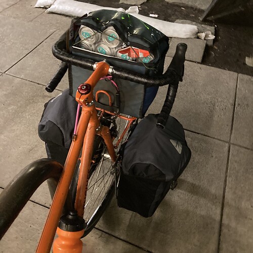

I love that bike
I’d love it a little more without the 2008 pursuit style bar drop
