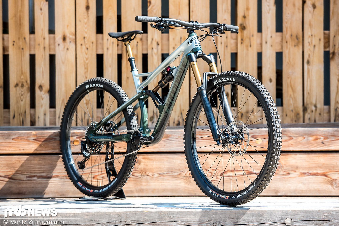

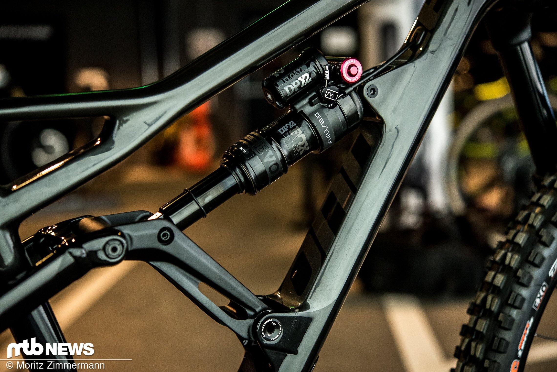

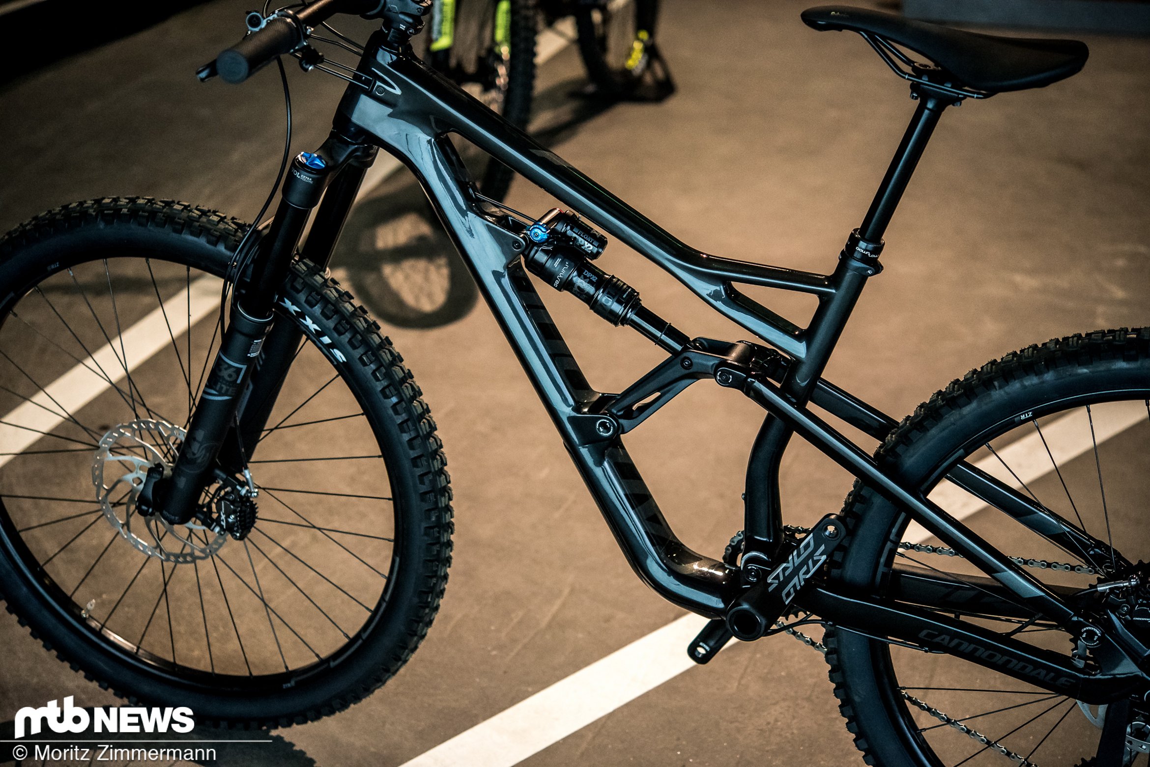

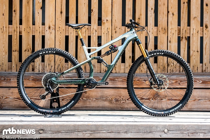

So the Germans are already posting about the new Jekyll 29er.
150-150, rear shock can be cut down to 120. 65hta, 75sta, alu cranks across the line. Stans flow rims.
Interesting spec on middle one, with their own drooper, and xt 4-pots. Don’t really dig the color of that.
Changed rocker looks like you could fit a larger water bottle now.
Seattube still same on xl.
Wtf…
That fork would look cooler in kashima coat atmo
