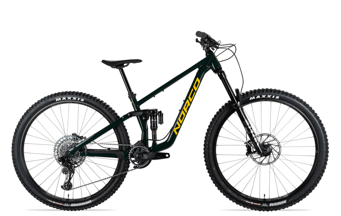

Norco Sight A1 for similar travel/spec to that S
