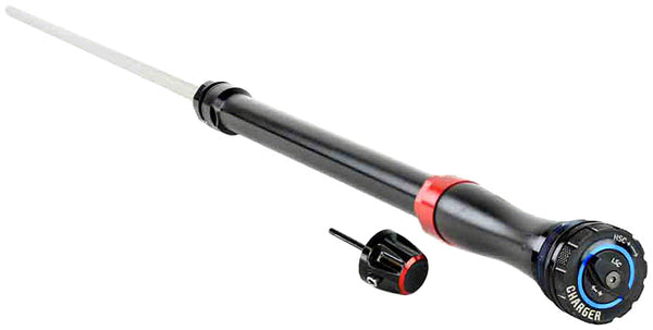

I have a few years old Yari that I think is not really upgradeable and am not impressed with the sweet spot on it. Sometimes I can dial it in to feel OK but am generally not digging it. It could be that it just does the job and doesn’t get in the way, but I feel like I could do better.
Yeah, I think most Yari forks have the motion control damper, not the better charger, which are up to charger 2.1 or something now. So, understandable that it ain’t great or easy to dial in.
you still have a sentinel from a few years back?
pretty sure you can put a new damper in that.
Ah yeah maybe I have seen that but at that price I’ll just buy a take-off better fork.
yeah it’s much less on qbp… but still not the cheapest. my now previous partner/ex put on in his fork after blowing up the damper twice in his yari and he had the same bike or similar as you i think? (2018 alloy sentinel with nx).
the rtc3 one is cheaper and still way better than what’s on the yari.
