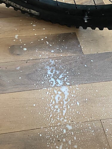

But also my puncture just above the bead seems to have sealed after some psi and shakes of the tire.
