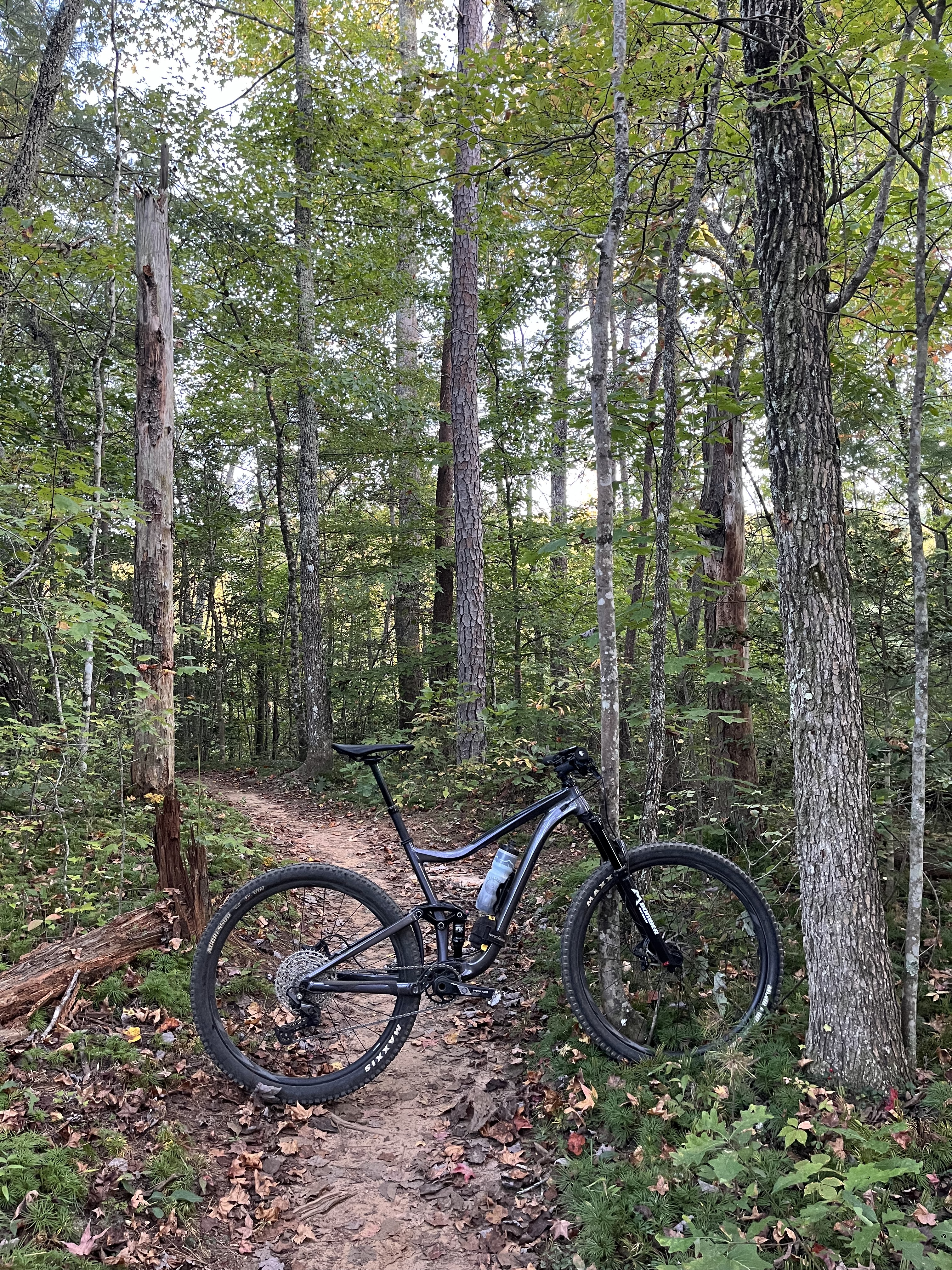

I rode my MTB tonight - ironically when I’m seriously thinking about replacing it I set lots of PRs on a 5 mile loop trail. I’ve never ridden a MTB as well as I did tonight. I did try really paying attention to my position on the bike and what felt good and what didnt.
Climbing and flatish seated sections, the bike feels good. Out of the saddle with dropper down on a little pump track-ish section on the trail the handlebars felt really low especially as I was really focusing on leaning the bike over through turns. Downhill I have a bad tendency to let my weight get too far forward especially under braking. Overall I wanted handlebars higher and occasionally a bit farther away.

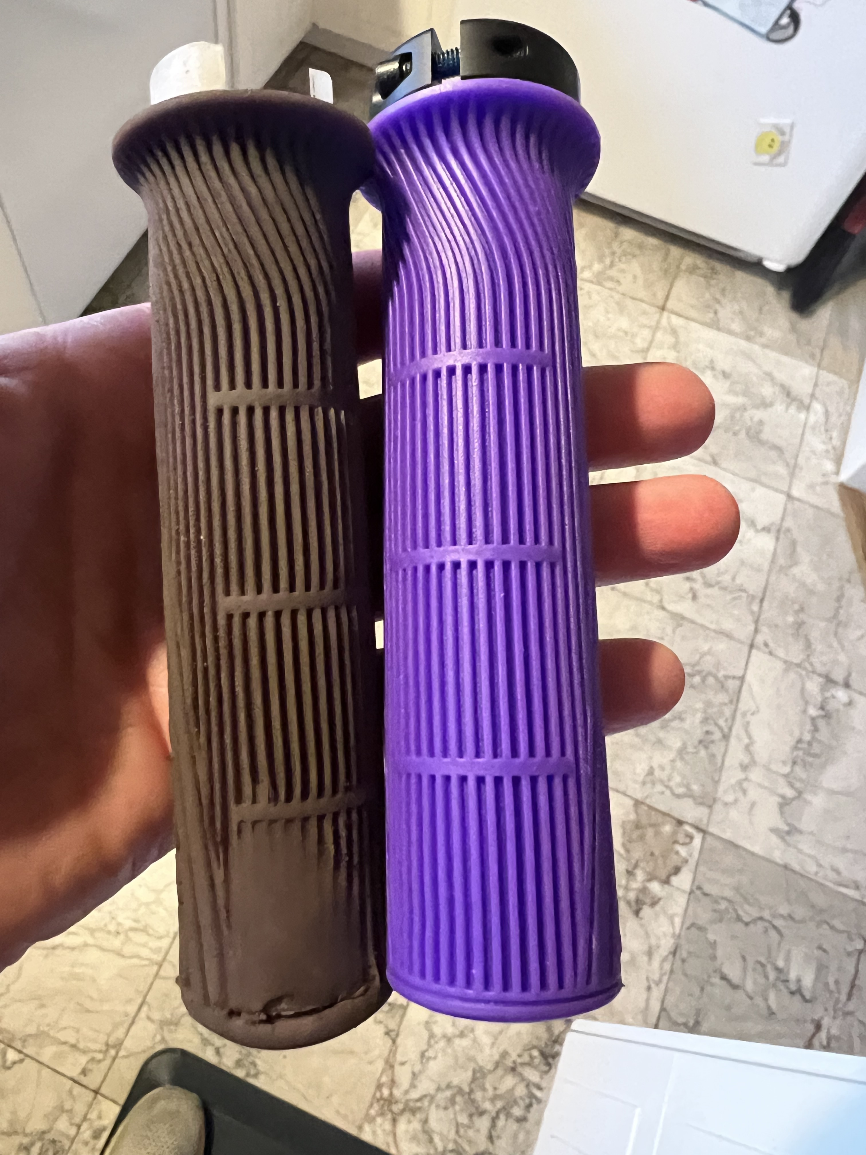

1 season.
I think I installed them backwards before. :man_shrugging:
Also hit some Cush core zen with a 15 minute tire change and zero swearing needed.
We need to talk about proper grip rotation
