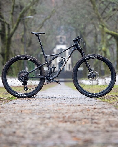

Congrats @ProCracknfailBro and the rest of the crew. This looks amazing.
Everything but the headset cable routing.
Also, is it true no lefty fork options in US (okay the 14k lab71 version)?
Was stoked to read about the threaded BB and ditching the ai lacing/offset, then totally lost interest with the headset routing.
I know through headset routing is probably not that bad but I’ve sold bike for lesser things that bugged me.
I’ve watched a few build videos of bikes that have headset routing. It seems like fishing the cables/hoses is a lot easier than trying to go through little ports on the downtube.
For a road bike, I could see it being a headache to drop the fork out. On a MTB, you’re taking the fork out to service it anyway.
i just like how thin the tubes are
Biggest complaints I’ve heard is from mechanics saying it provides a funnel for water directly into the headset bearings, and swapping a stem can now be a much more complicated task.
