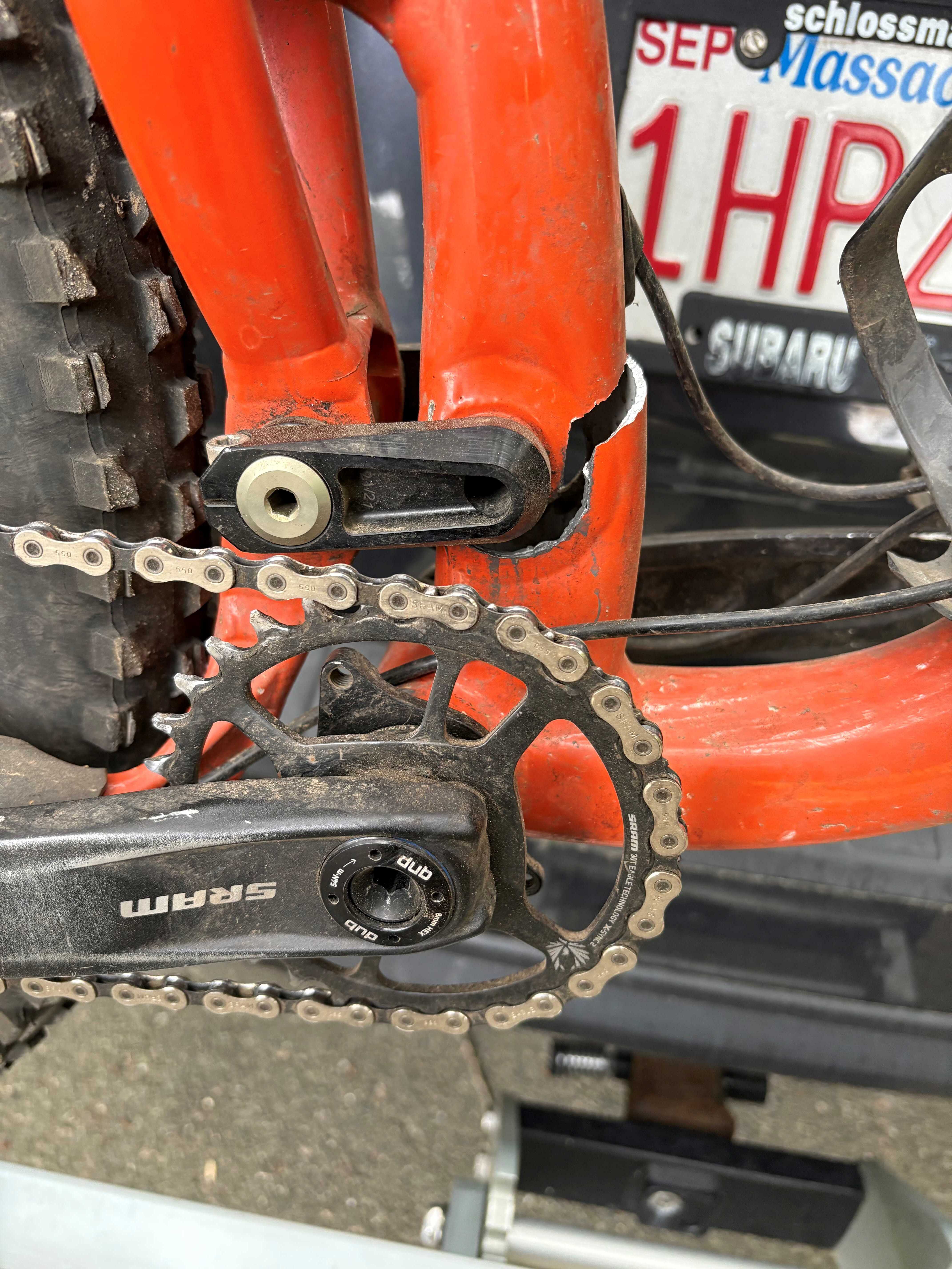

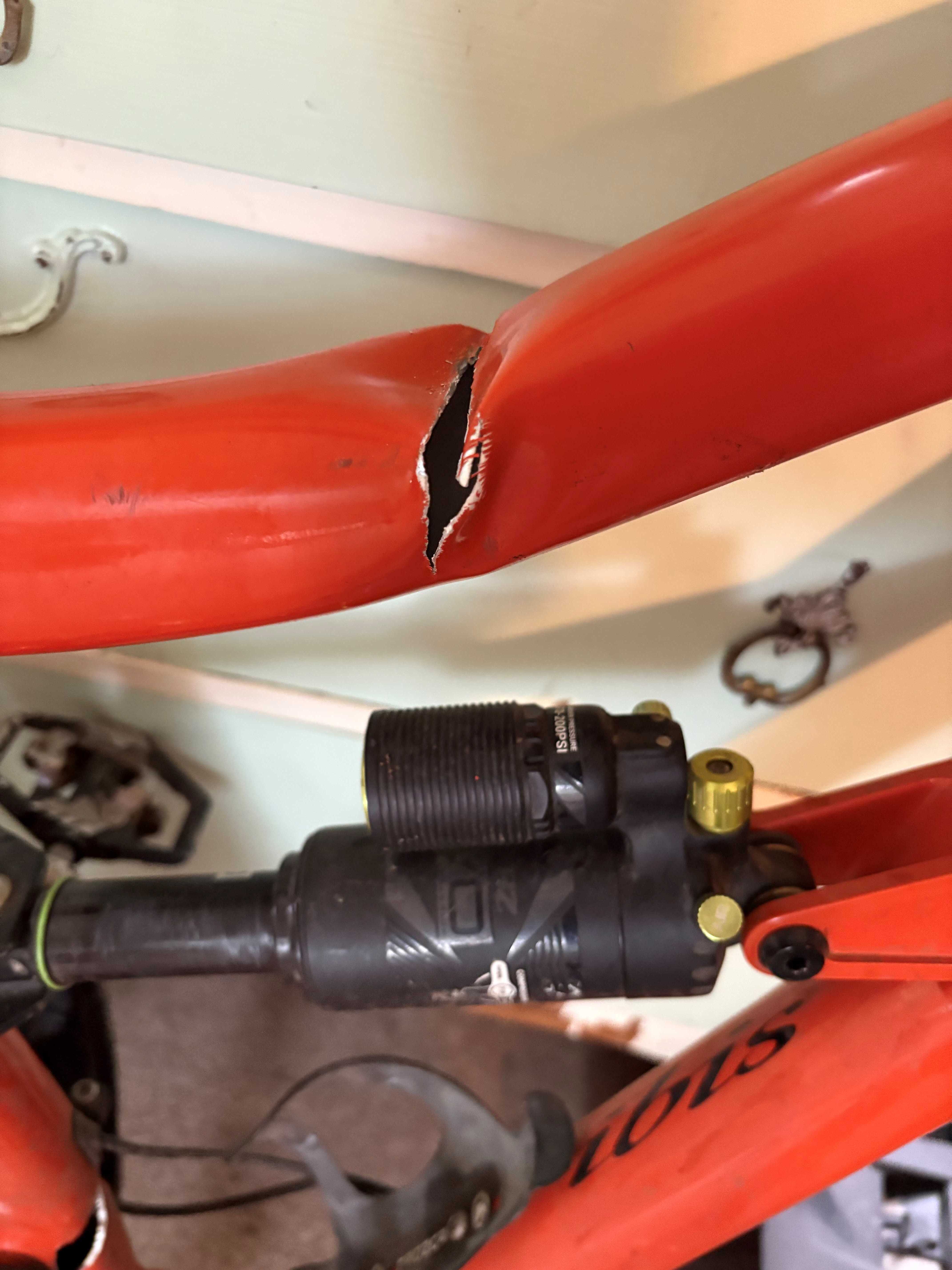

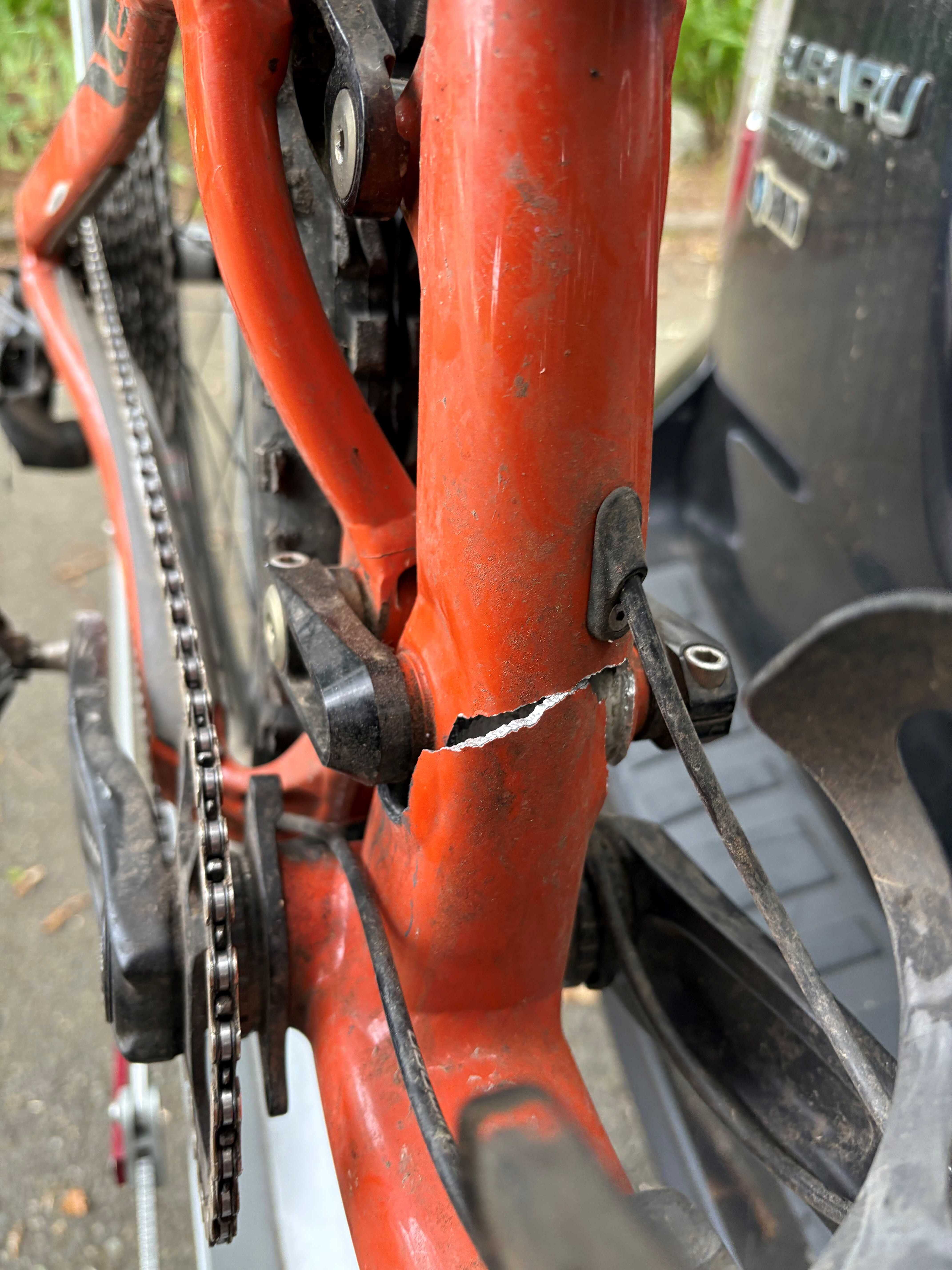

The Rimpo AF frame that I purchased back in November of 2021 gave up on me last week. It probably has around 1300 miles on it. Ibis is sending me a new frame HY, but I wonder if this is going to happen again. I would say my riding is spirited, and as my skillset progresses, so do the forces exerted on my bike. I do small drops and the frame has seen maybe 5 park days. As far as maintenance is concerned, I service the suspension and bushings about once a year. I am a big dude who weighs about 230 when I ride with my pack.
During the last ride, I could feel something on the drive side. It felt like the springs on the pedals were loose or maybe like my cleat was slipping. When i paused to look at it trailside, I did not notice anything out of the ordinary and just figured I would deal with it when I got back home.
The frame buckled after hitting a small drop, not the largest one i did that day, but it was the fastest one in the loop that I do. I am so thankful Ibis is sending me a new frame, but I wonder if I should think about getting a burlier bike to handle my size and my progression. I am in new england, so i never thought I needed an enduro bike, but I also dont want to break frames every 4 years. I feel pretty lucky to walk away from the failure without issue, pretty sure that could have been bad.

Where were people talking about frame warranties?
mo’ rip

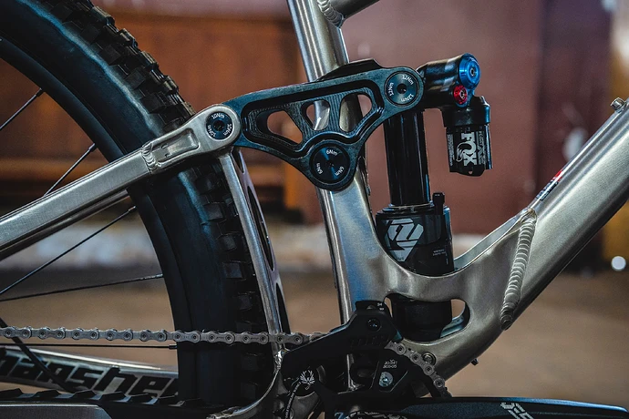

Banshee Titan is something to look into - the Phantom is burly enough for me at almost 300. The leverage curves are favorable towards heavy riders, and the cradle area for the shock is something to behold.
I forgot too, but when the tarck crowd suggested a frame lasting four years, it made me think.
I showed this to a mechanic and he thought he saw that bike here in Bellingham. Evidently a very similar point of failure on same color Ripmo AF.
Banshees are real sweet, and the raw color fucks. And framesets are on sale pretty much everywhere.
was looking at the Rock Lobster website, specifically the MTB frames and Paul writes this on the XC (hardtail) web copy:
I’ll be frank here- Aluminum for a mountain bike frame is really great in that it is very stiff and light. The drawback is that it has a finite fatigue life. Mine lasted eight years, through a season of racing and many crashes. I’m old man. I think that if I were in my 20’s racing every weekend on this frame I would get two seasons it.

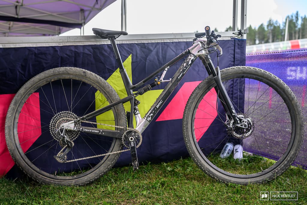

If 29" is wagon wheel, does that make 32" ferris wheels? BMC prototype
what is goin on with that fork??
