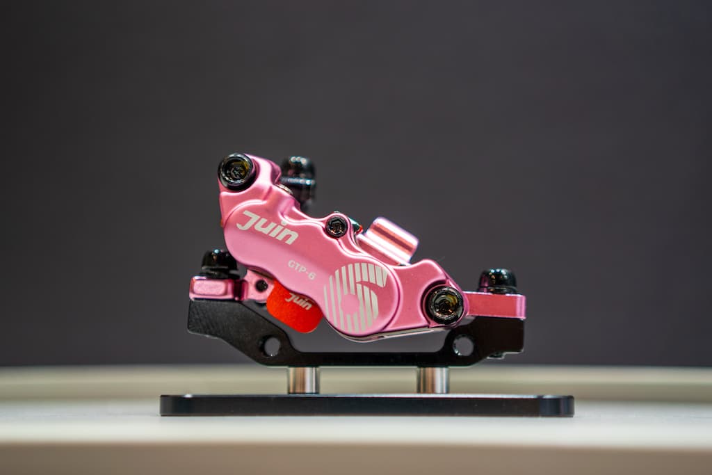

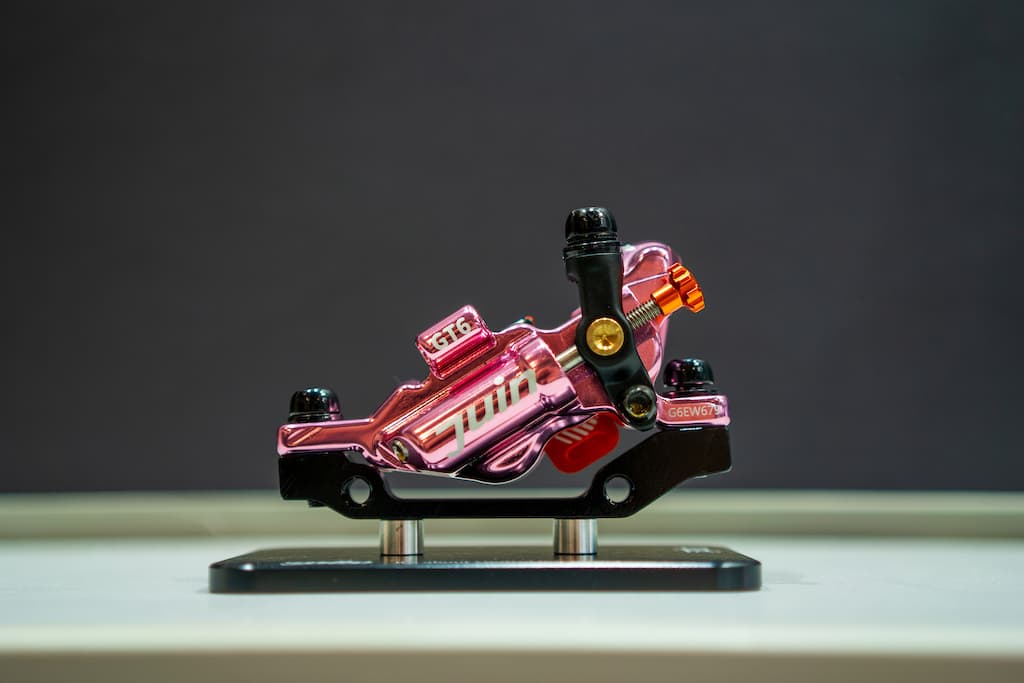

Juin as well, in their famous cable to hydraulic way
i’ve never even heard of this brand
pretty common budget option for making cable brake levers do a disc brake

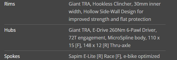

The specs say it comes with Sapime “E-lite” rear spokes and Sapim Race front spokes. But both front and rear, the thinner section of the spokes measures like 1.52-1.57ish on every spoke (my calipers are pretty cheap so i checked quite a few). Sapim race say they’re 2.0/1.8/2.0. Is there anyway they just used the wrong spokes? ran out of the right ones?
Just feels odd to me. They’re thinner than the spokes on any one of my other bikes. I can’t find any info online about Sapim e-lite spokes existing, so must be an OEM thing.
I’m not sure what spokes came on my reserves, but they are def 1.65 in the center and consistency measured 1.63-1.68 on my calipers. Those have been fine for me for trail use, but I am sure they would fair differently on an bike.
When did you buy the bike? If it was during Covid supply chain problem times, I can easily imagine an on the fly change to the wrong spokes because better than nothing.
‘Sapim E-Lite spokes with 2.3mm heads and brass nipples for added durability.’
Weird they don’t have them on their site, but maybe because it is an OEM thing.
