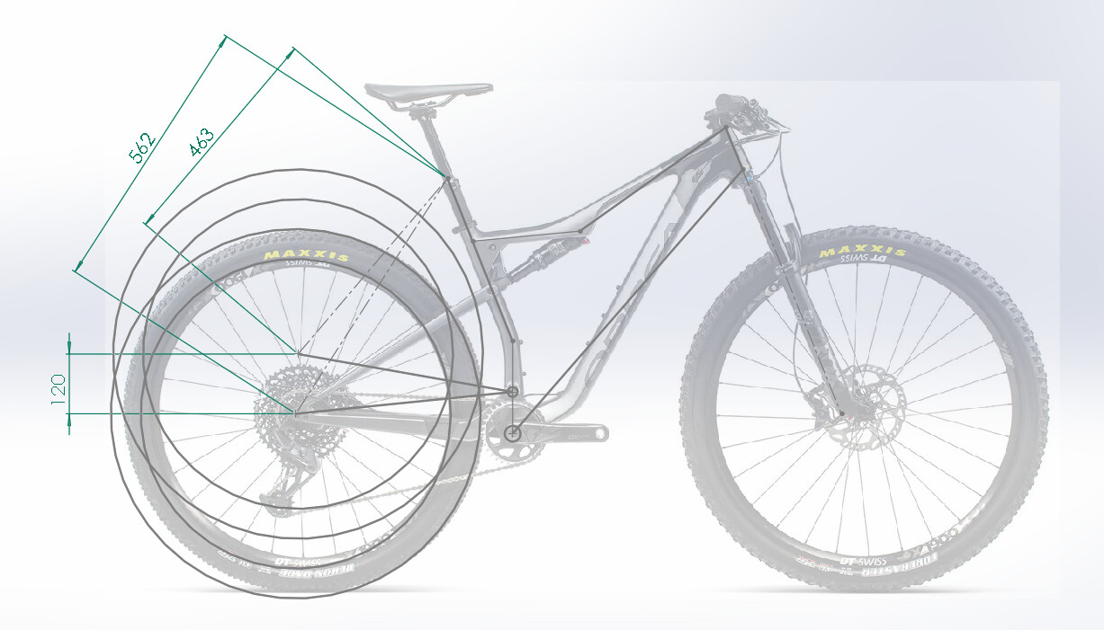

I decided to throw away some more money on a digital sag gauge. In the 20 minutes I dorked around with it while the rice was cooking, the only revelation is that my Orbea Oiz TR that is billed as a 120 mm frame only has 100 mm of rear axle travel. It’s a little quicker to use than measuring the distance the O-ring moves and adding some pressure.
When I have some more time, I’ll run through the numbers on the Marino and see how much my tune changes.
Great dithering.
How did you measure rear axle travel?
Edit: What I mean is if that sag gauge is attached to a saddle or seat post that, depending on how the suspension moves, I could see how 100mm difference on the gauge translates to 120mm of vertical rear axle travel.
Yeah, I have the “virtual fender” clamped to the chairpole. The box itself has a magnetic doodad that sticks to the thru axle bolt hole.
To calibrate it, you dump all of the air out of the shock and then fully compress the bike. Once it’s compressed, you zero the gauge. Then you lift the bike up to extend the shock and record the value. I did it a few times for repeatability, but it was 100 mm +/- 2.
When I do the Marino next, that should be another datapoint. 20 mm isn’t a big deal. That’s just the first thing that jumped out at me. Though your drawing shows the axle travel vertical, too.
That’s wild though, almost 20% difference is well outside manufacturing tolerances or whatever else they might try to claim! I was trying to figure out how maybe some quirk of geometry would allow them to call it 120 travel, measured at the BB or anywhere really but not sure how else they could get there with it being 100 to the virtual fender.
Wrong spec shock?
I’ve seen a few brands do 120 and 100 versions of the same frame with the same eye to eye on the shock but with different stroke.
That’s something I’ve checked. But, that reminds me that the shop warrantied the linkage when I had it in for a bushing replacement. I bet the wrong part number for the linkage was used.
I stashed the old linkage in my parts bin. I’ll have to measure it against what is in the frame.
