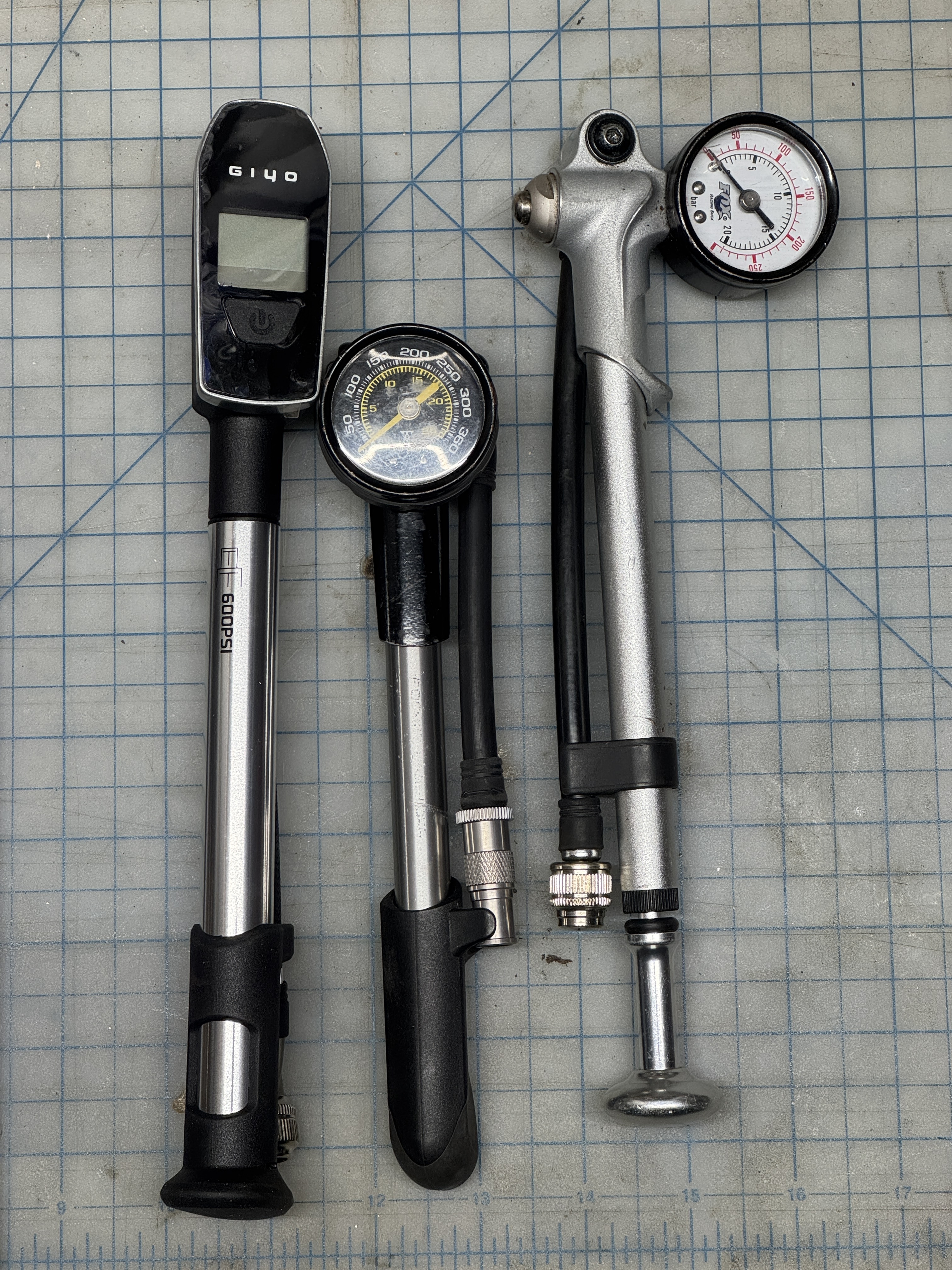

Three pumps, pretty different psi readings. Sample: Topeak at 60, Giyo (afaik the oem for both fox and rockshox) at 65, Fox over 70. Kinda sucks as I believe the Fox to be the most accurate based on experience.
I pumped the test fork up to 80 on the Fox and it read as 72.5 on the Giyo. Pumping it up to 80 on the Giyo read as 87 or so on the Fox.
Rear shock: pumped up to 225 with Fox, read as 212 on Giyo when attached.
Pumping up to 225 on the Giyo led to a reading of 220 on the Fox (which takes a lot of air when connecting to rear shock, seemingly less so on lower pressure fork).
You have to account for some air loss in the hose but I’m still kinda unhappy with the discrepancies. I was expecting the Fox and Giyo to be close. I suppose that as long as the digital pump is consistent, I just have to recalibrate myself to using its numbers over the trusty analog pump.
My experience with tire pumps is that the actual accuracy doesn’t make so much of a difference as much as using the same one for relative consistency. I imagine this holds true for shock pumps too?
Yeah that’s what I said at the end. It’s just kind of annoying with forks and shocks because if I were to, for example, dial in a new piece of equipment with the Topeak pump, it would (and has) result in a terrible ride. That’s how I figured out that the Topeak was utterly fucked earlier this year.
@Crustradamus does the Giyo pump have a quick release to tighten around the valve? My Giyo does and I swear it will lose about 10 psi when I remove it.
Yes. I believe that when you unfasten the lever, you are no longer connected to your fork/shock and just measuring hose pressure. You then press the button behind the digital head and release the hose pressure before fully unthreading.

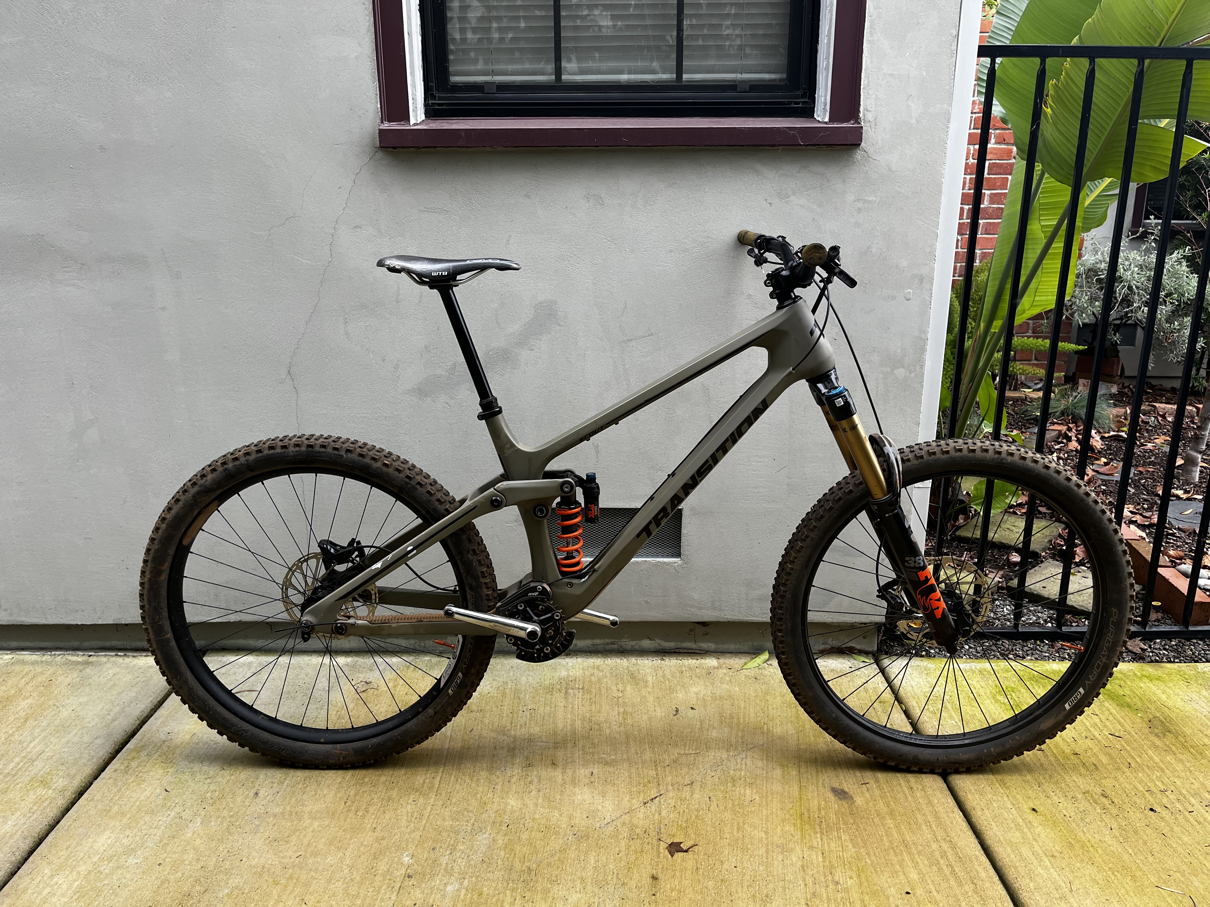

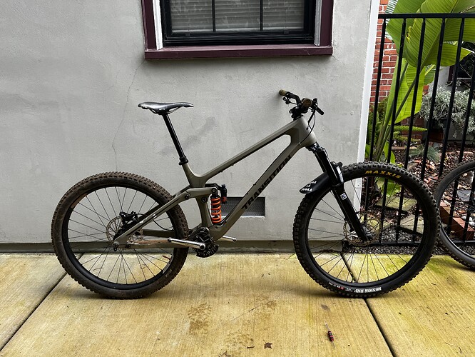

If I remember on Friday I can take some pics with a 140 29er front since I can pull the fork/wheel off the evil
Top photo is 27.5 x 2.6 with a 160mm 38, bottom is a 29 x 2.5 with a 140mm pike. Unfortunately the steerer on the pike was too short so I couldn’t thread the top cap/bolt. Had the effect of slacking the fork a bit due to the play in the unloaded headset.
The clinometer app on my phone only does whole degrees so couldn’t get very exact results but seat angle remained unchanged (71* actual). Head angle differed by 1 degree (63 vs 62) but I’m assuming that’s due to the loose headset. Bb height was approximately the same (343mm +/- 2mm)
I’m honestly surprised it’s this close. Seems like it’ll work a treat for a winch and plummet style of riding
