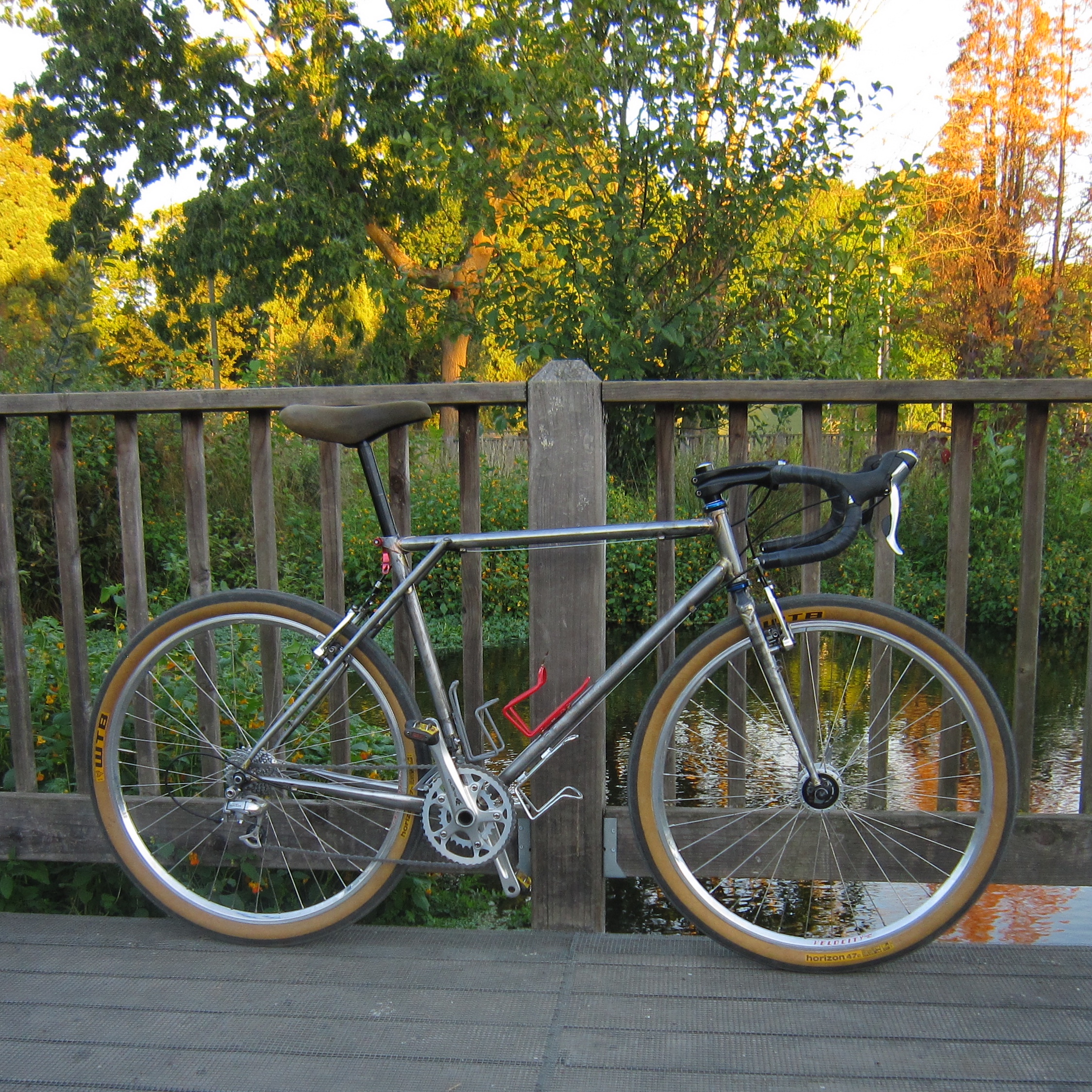

Another day, another bespoke fop chariot (during a short test ride to see if the frame would disintegrate under load, and, failing that, to see if anything on the build needs to be tweaked.)
That’s a nice fop chariot. Is it low trail, will it get a front rack?
It’s medium trail (45-ish offset; The fork’s got an angled crown so the rake got baked in when I cut the fork blades to length) but the ETT is ~600 so the wheel gap makes it look like more.
When the headset showed up at the LBS yesterday I was in such a hurry to assemble the thing that I didn’t stick a rack together or glue fender mountpoints onto the rear dropout, but it’s going to get a rack sometime in the next day or so.
