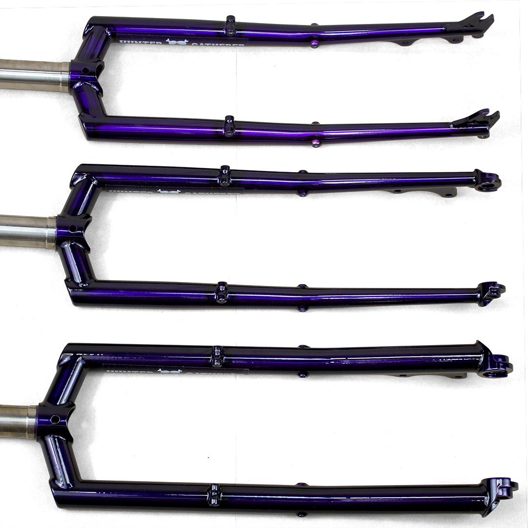

Is there any particular reason that they chose to go unicrown on the newer forks? It seems like the lugged crown has nothing to do with the failures, and it certainly does look nice.
that particular lugged crown is the exact Root Cause of the failures
it has an oversized nonstandard socket for the blades, with only the one option for them, that’s butted to the same lower dimensions as classic 531 or Columbus SL
for many years it was also the only option for a wide crown with a 9/8" steerer
Pacenti had exclusive distributorship of his design so when he failed at another business you couldn’t buy it outside of east asia (only became available again this year)

The unicrown fork, while of questionable aesthetics, is both lighter and stronger than the old one due to the new fork blades. I really wish they could do a fork with a fabbed crown similar to the lightning bolt though, that thing is pretty dang attractive.
It’s a special crown with a 25.4 blade. There’s only,one blade for it and I don’t think glen copus has the clout to have a better one made. Also I believe the unicrown forks started before the pacenti mtb crown re entered production, which is I think the only other crown with that kind of clearance

Two if you count the 25.4 tandem chainstay. It’s thicker, but I think that’s cancelled out by the shorter taper. I haven’t had one in my hands to be sure.
A fork made with those blades would be way heavier than a unicrown. To my memory, the taper wasn’t much shorter when I used it, but the upper section above the taper was much longer. I can measure when I get home. It would have also been a lot more work for glen to fit it in the crown.

Two if you count the 25.4 tandem chainstay. It’s thicker, but I think that’s cancelled out by the shorter taper. I haven’t had one in my hands to be sure.[/quote]
yeah it looks pretty weird especially after bending, is waaaay heavier, and it doesn’t really fit the crown sockets without some blacksmithing
