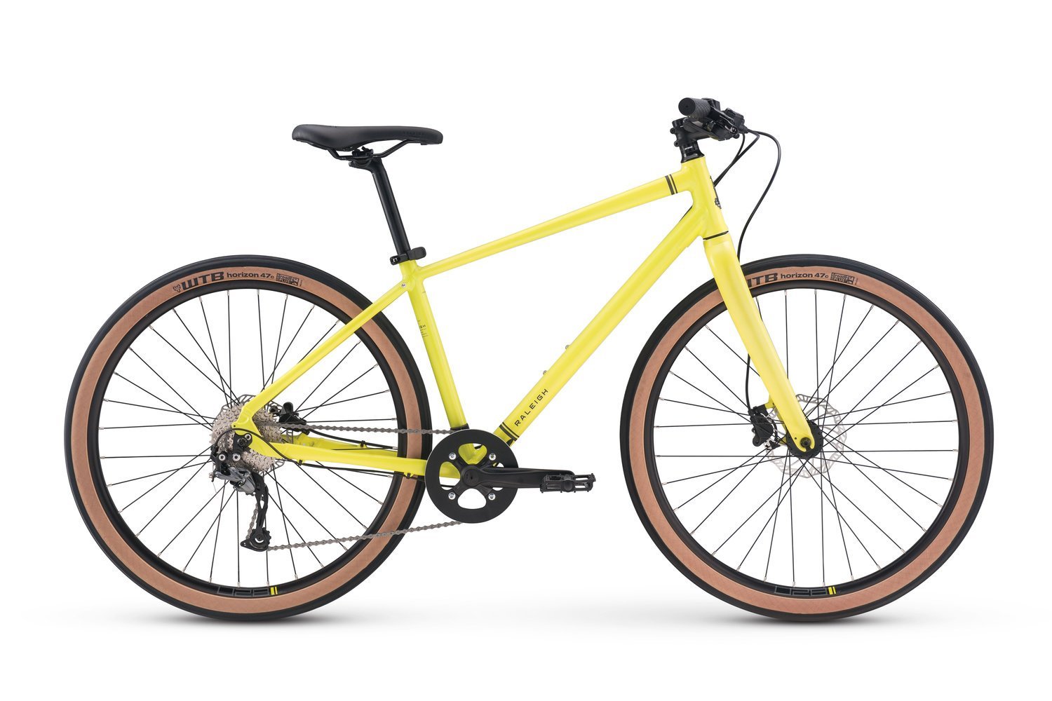

I really like what raleigh is doing recently.
evidenced by my almost buying this:
https://www.raleighusa.com/redux-2
before I decided to spend that money on mountain bike stuff and front end racks for chasing the ghost.
sweet hybrid
The Canadian website may have a pre production version. It doesn’t appear to have the rear rack mounts that allow you to flip the front rack and put it on the back. Hope they sell racks as an accessory for maximum cargo capacity.

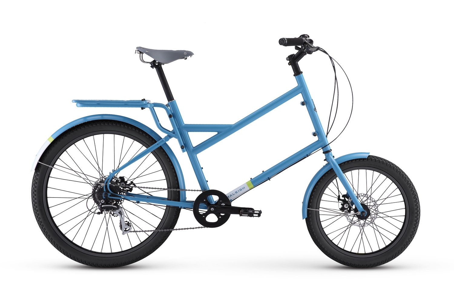

I wonder how much they had to compromise the geometry on that Lorry to get the rack to fit both the head tube and the seat tube upside down.
Doesn’t look very low trail to my eye, way too slack of a HT. Bright side is that your handlebars don’t interfere with the load as much.
The dropouts on the lorry look cool too.
yeah the headtube is suspiciously very slack
but that fork could hide enough offset to make up for it
it has a 50/50 chance of being a usable cargo bike
You still have to lift the load to straighten the handlebars no matter where the load is attached
Cantilevering the load from the headtube actually adds to the number of affects on steering. It’s especially noticeable in low speed turns and/or in grade changes — the load is projected forward and to the opposite side from the rider. Because it’s not “in” the bike or attached to the steering you have to counterweight it instead of countersteer to accommodate.
Having the load attached to the steerer/fork is almost always better than that inverted pendulum problem, but fork-mounted loads don’t scale well to large volumes or weights.
You need low flop (lower trail) geometry for either system to work well
Based on specs on the CA site, 46mm.
