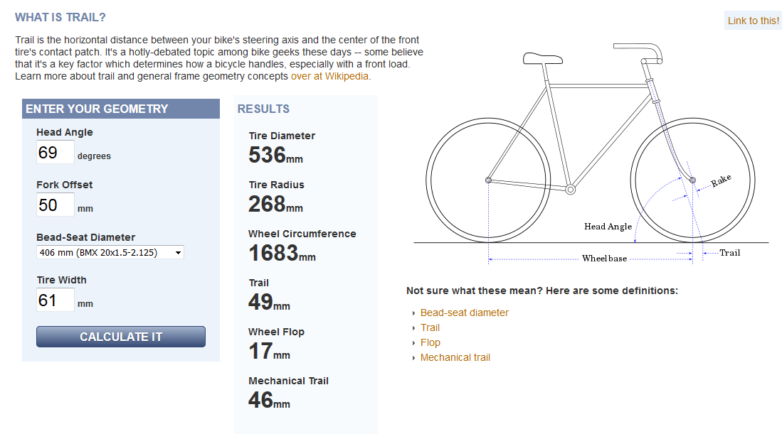

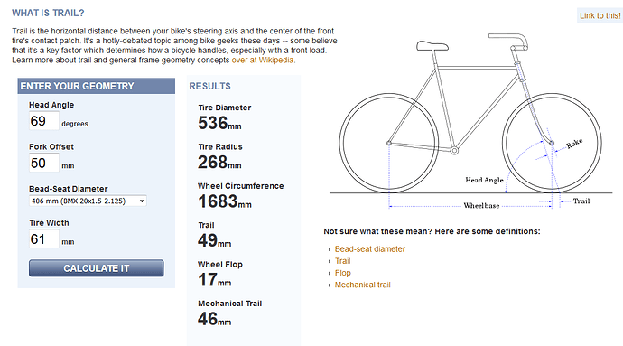

When you refer to trail do you usually use the Mechanical Trail or just Trail measurement? I never know which one to use.
I’m guessing that the mechanical trail is the bare rim trail, and the actual trail accounts for the height of the tire? (If I set the tire width to 0, the trail reduces to 2 mm more than the mechanical trail (which may be a case of “no, that tire has thickness” when faced with a ridiculously tiny width.)
Nope
“Mechanical Trail” is an imaginary line square from the steering axis to the contact patch, where the normal “Trail” measurement is measured on the ground
“Mechanical Trail” goes along with “Rear Trail” (same but rear wheel) and can explain a lot of bicycle handling characteristics in a theoretically pure way that nobody’s really used in public yet

Mechanical trail is the true measurement of the “leverage arm”. Regular trail is that arm projected to the ground. Since it’s a projection, over a large range of head angles it won’t represent the true value correctly. However, under the narrow range of head tube angles using one number versus the other in comparisons results in an insignificant error.

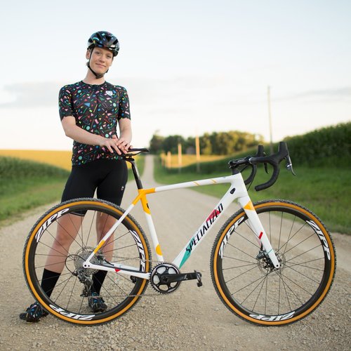

Have these bikes been posted?
So good and better in person.
It has road pedals on there, but they do have matching sworks7 mtb shoes in the same fashion. I was waiting to see when the regular shoe was going to drop, but couldn’t wait any longer to get new shoes.
Spec is killing it with paint schemes lately.
2019-Masi-Evoluzione-Ultegra_grande
As long as the stem length works this is pretty dope. Matching bar tape would make it better.

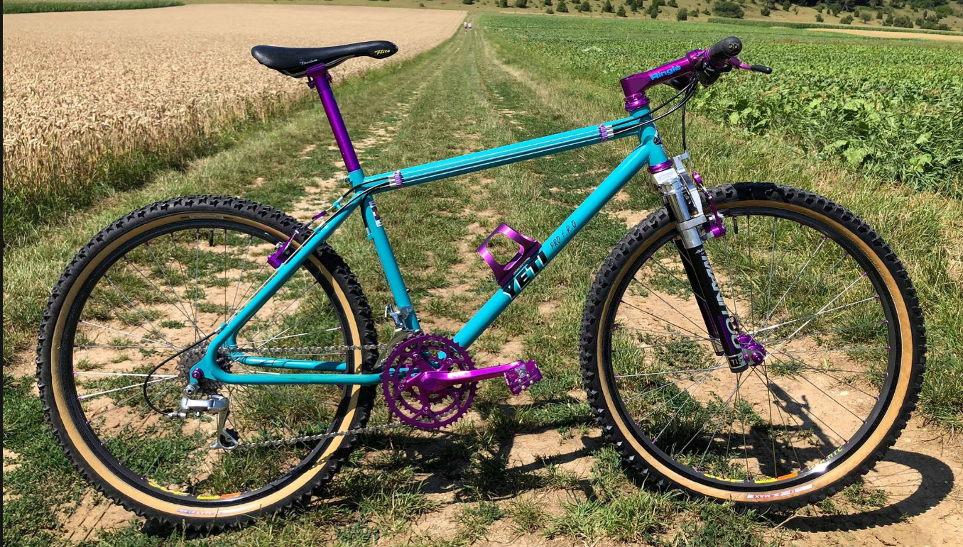

This is a pretty great paint scheme. Kind of a toned down version of one I was planning on doing. And may still do because BLOW IT OUT.

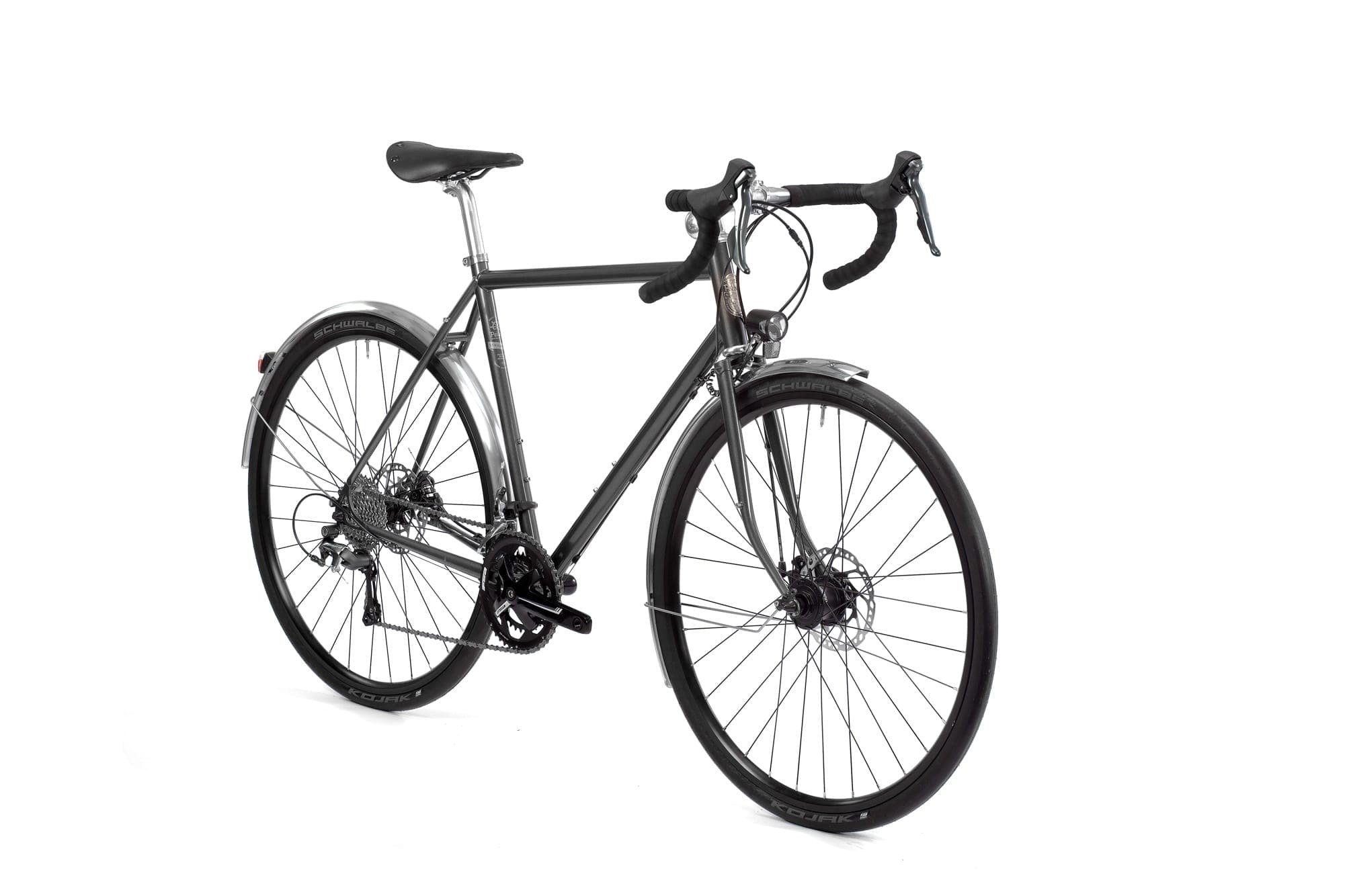

Another low-trail, dynamo’d & fendered off-the-shelf bike option for around 2 bongs. Doesn’t look too bad:
Pass
A cool historical relic, but little else.
The color scheme is cool. And everything about is it cool. I do not want to ride it.
