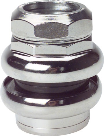

this also relates to what @rancid_burple is saying which is that I believe those Tange 27.0 cup bearings are 30.2 on the bottom:
https://www.velomine.com/index.php?main_page=product_info&cPath=87_93&products_id=3179
also noted on Sheldon:
which makes me think I could just jammo an ISO bottom in (I have no clue what reaming would cost me at a bike shop) and file the top to fit.
Also I could just buy the VO one, scotchbrite it, and paint it black

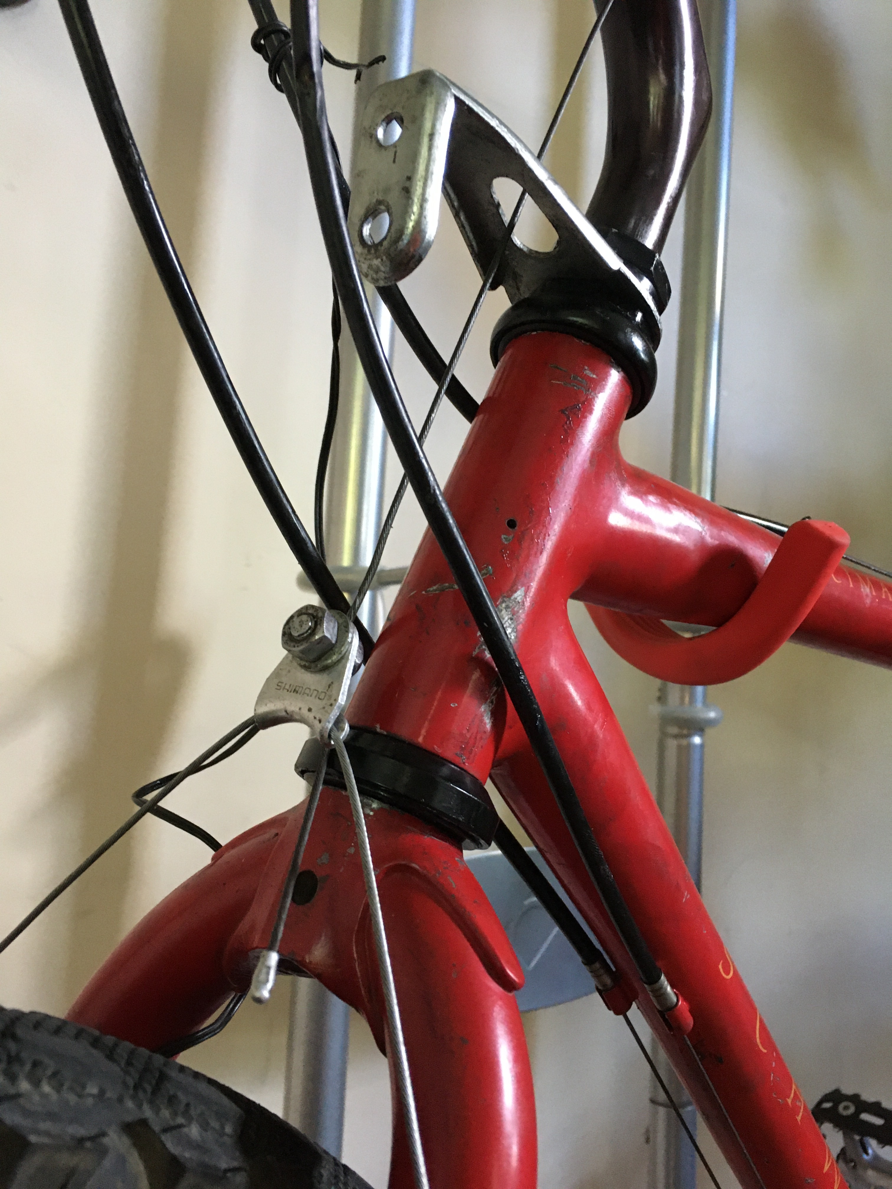

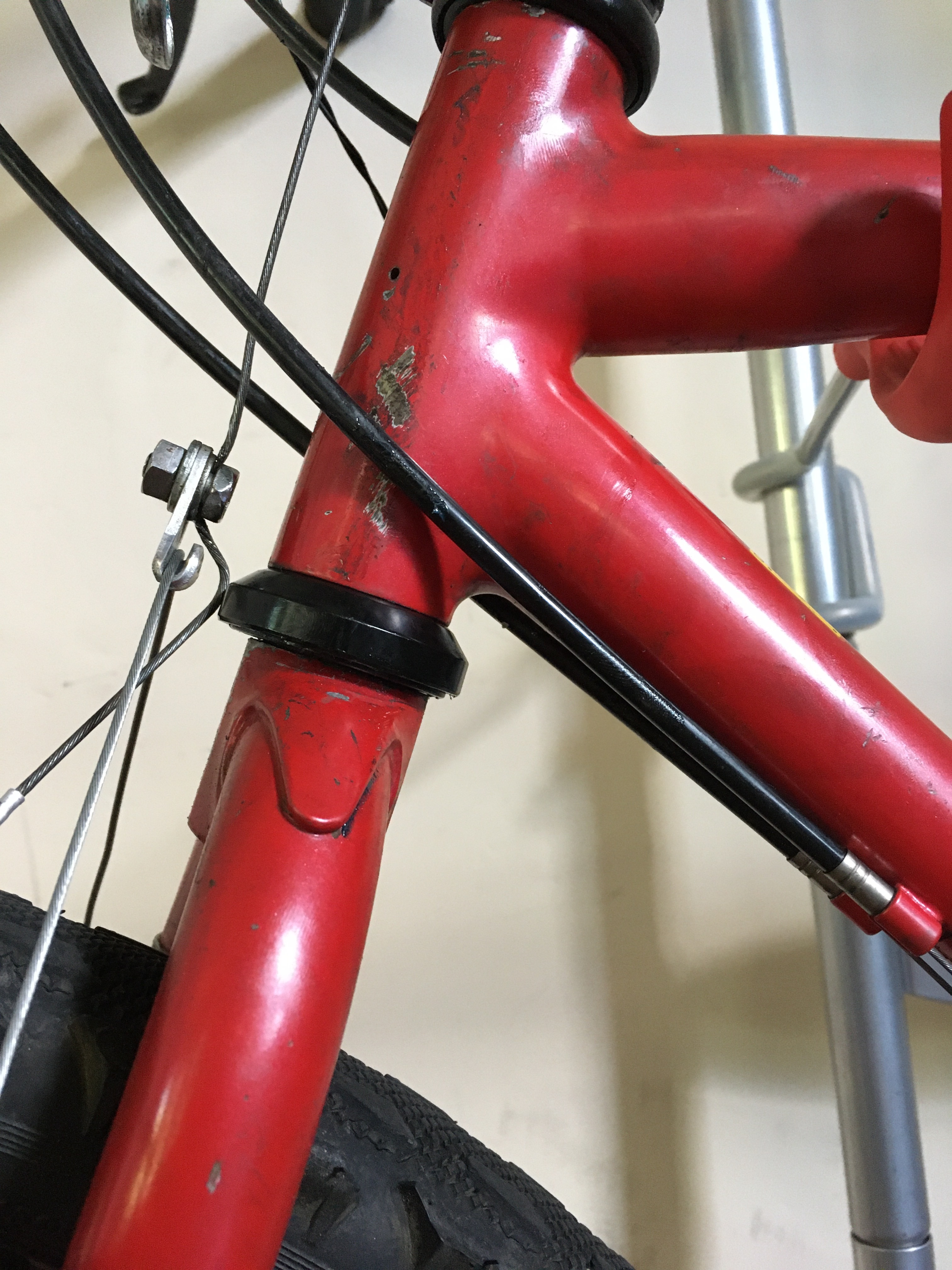

OK so my bike is back on the road with a new headset, after some entertaining drama with my VERY local bike shop near my new apt. The dude said he had a headset for it and then… pulled out a no-brand roller bearing headset! That is, roller bearing on the bottom, caged bearings on the top. $50 and he’d install it, he said. I was like… uh… are you sure it’ll fit, and he was sure.
Of course, within a minute they have a file out and are filing away at the fork so the crown race will fit and bashing on the lower cup to fit it in. They brought it out once. Huge gaps. More banging. They bring it out again, no gaps, but I ride it up the block and still tons of play. I come back, they adjust it up, and now I’m back on the road again.
