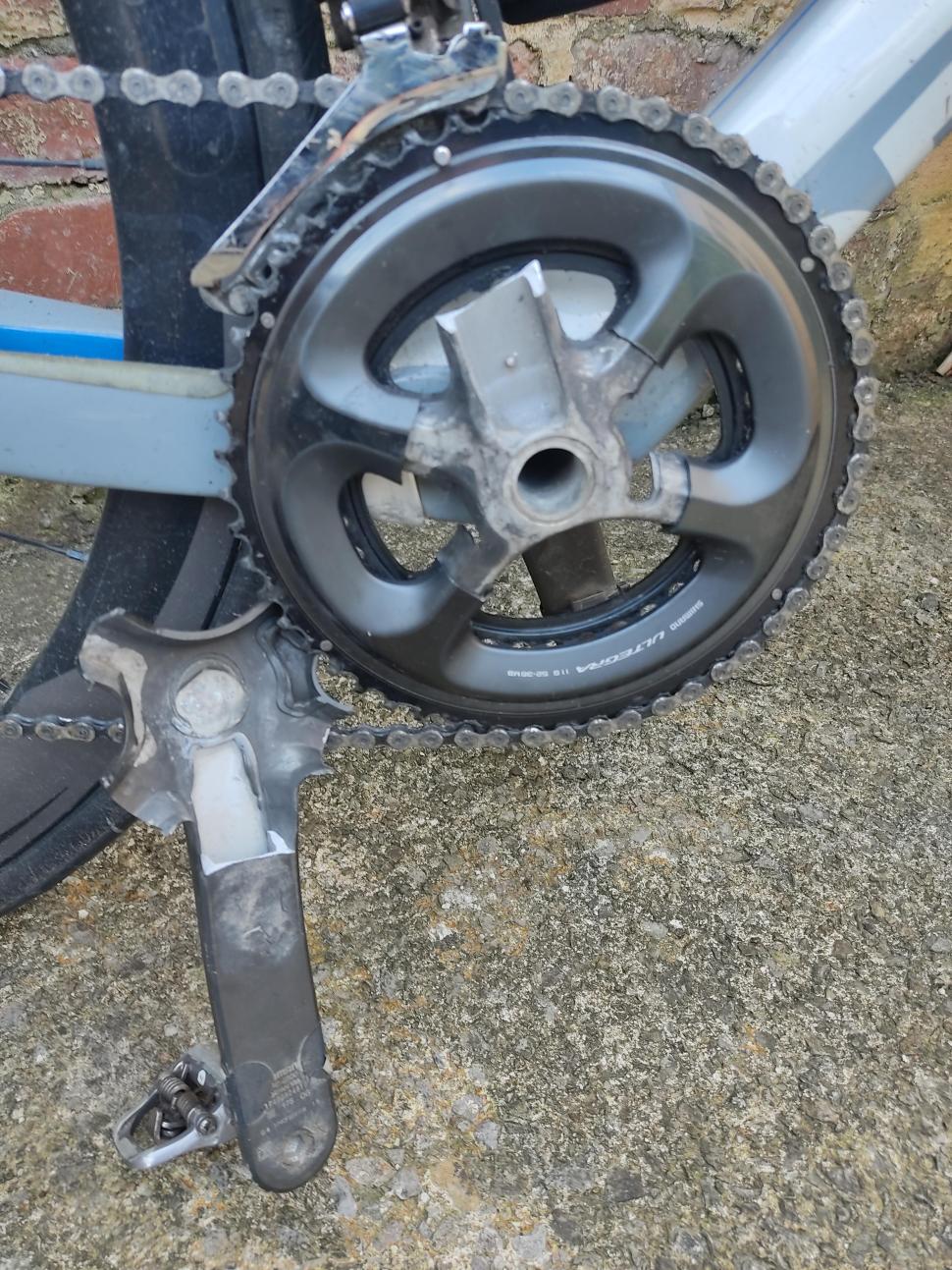

Road dot cc is going in on some hardcore investigative journalism regarding the Shimano Hollowtech crank failure phenomenon:
the comments are a class action lawyer’s dream
Not defending Shimano here, but it’s funny to me that most of the catastrophic failures seem to be preceded by some noticeable creaking, but most of these cranks are probably on bikes with press-fit BBs so riders just ignore it until the driveside crank explodes
that’s right I’m bloggin: The Trash Bike Roller-Cam Brake Project From Hell Fuji Sundance
I mean absent a public awareness campaign about the explodey cranks, I would also 100% assume that a creaking noise from that part of the bike was the bb-frame, the pedal spindle-crank, or chainring bolt-spider, not the whole entire fucking crankarm getting ready to flower open like a bloomin onion
