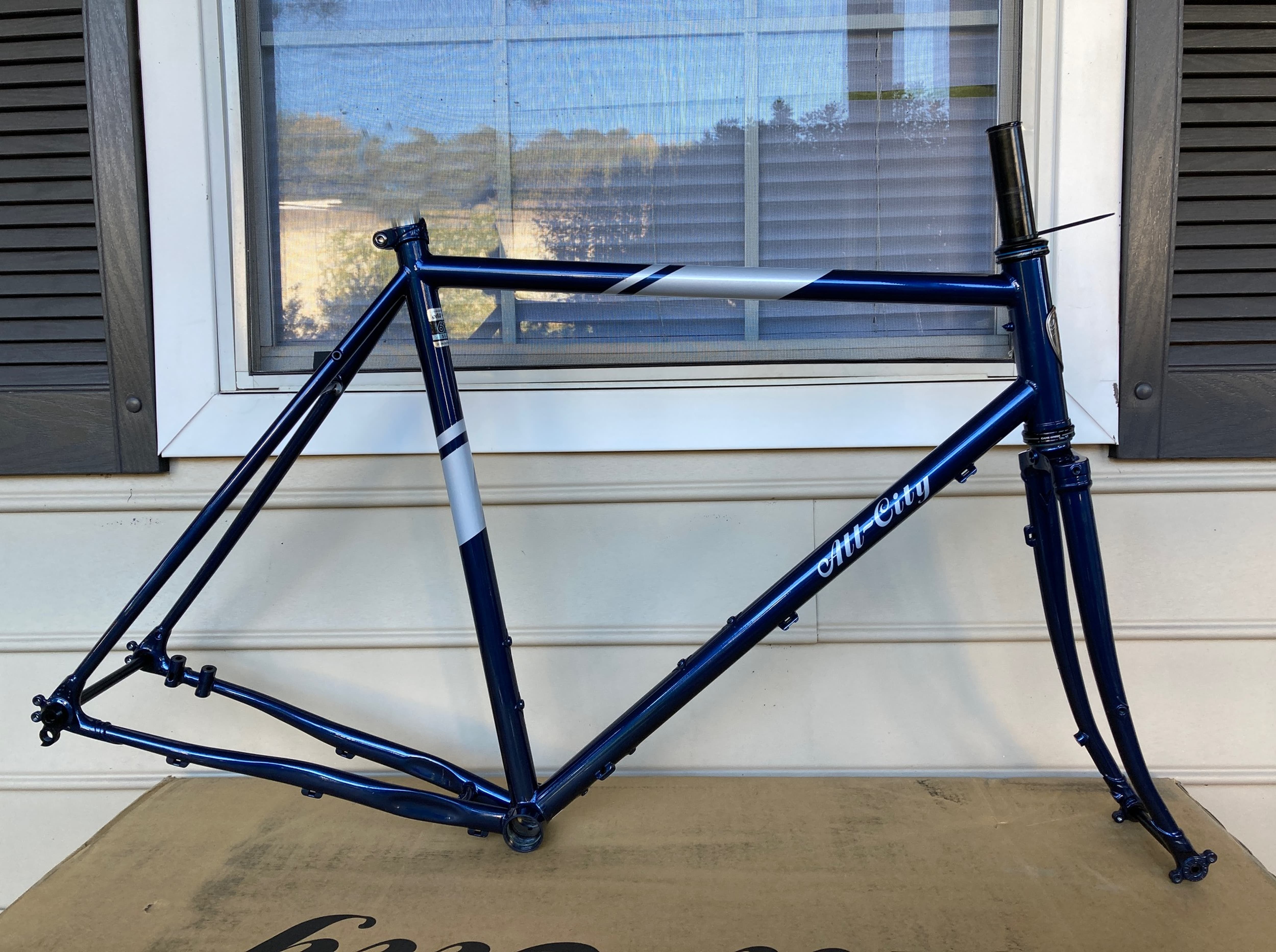

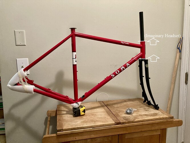

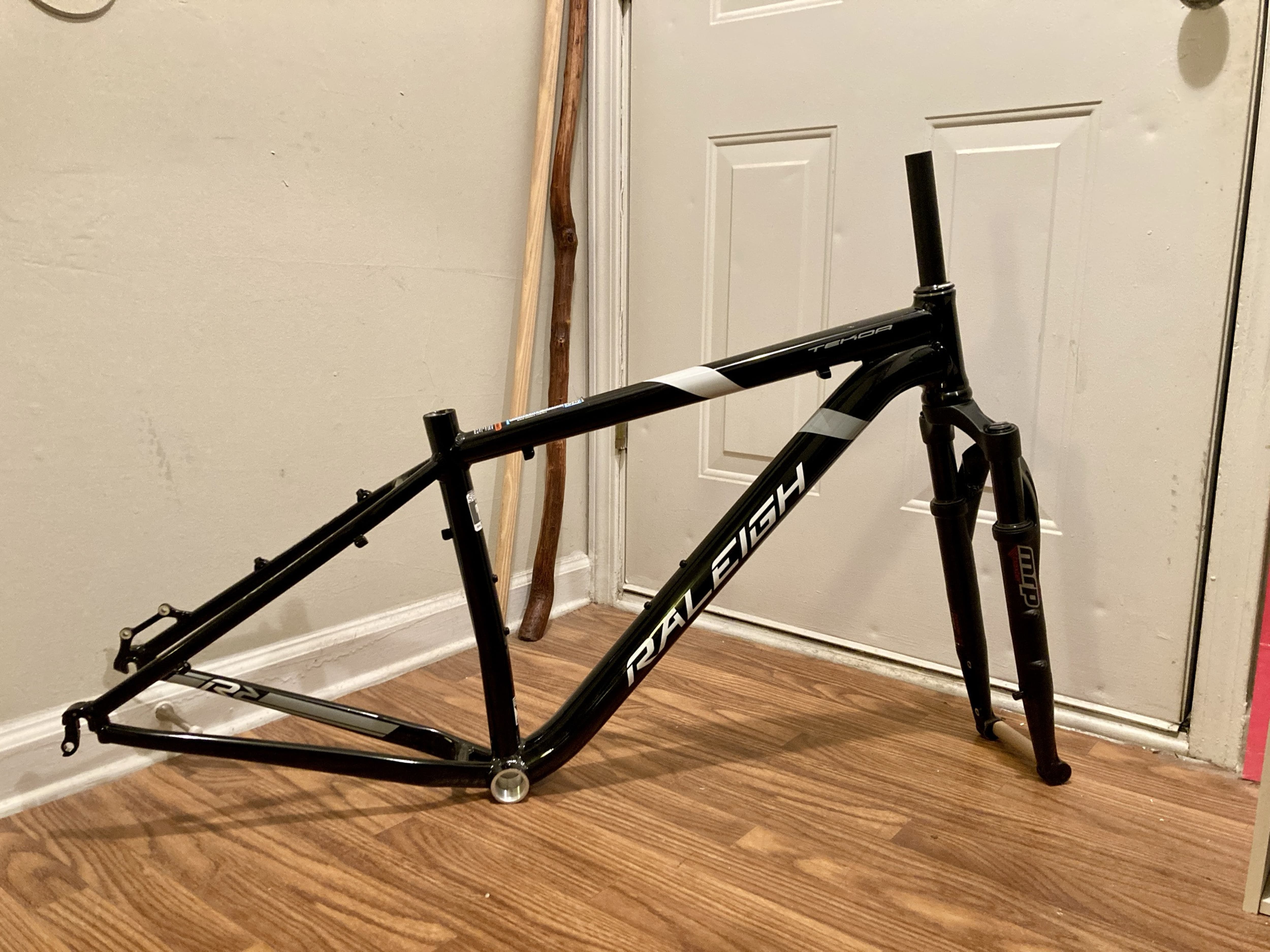

Anyone want to guess which weighs the most, middle, and least. Including headset and 40mm of steerer only.
All city, soma, Raleigh
All City
Raleigh
Soma
Most - Raleigh
Middle - All City
least - Soma
Nice job
All-City 2,550g+1,240g = 3,790g
Raleigh 1,950g+1,475g = 3,425g
Soma 1,975g+990g = 2,965g
I’m impressed by the low end Raleigh MTB frame and MRP Baxter. I think it’s pretty competitive versus a regular steel gravel or all-road bike.
1.2kg for a rigid fork is kind of embarrassing, I imagine it’s a heavy steerer and crown?
Decorative dropouts and beefy legs too. It’s heavy but still better than a lot of the monster unicrown jobs that are common now.
