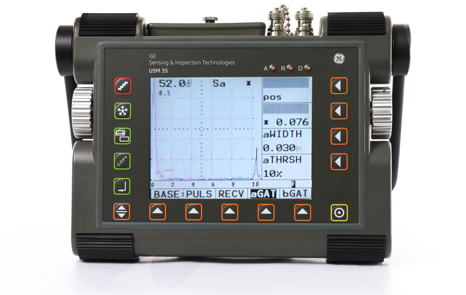

TBH I’m shocked it’s taken this long for someone to be a UT tech & bike nerd or purchase a probe and set.
Dunno how common wallpaper paste as couplant is outside of froggy & my arena, but it is super cheap and easy to get. sexytime lube will work too, water in a pinch but it runs away too fast.
Reading through paint is done by taking peak to peak echos, where you look for the back wall and front wall. Shitty operators with cheap gear will remove the paint in the area to measure, leaving a nice rusty spot.
That meter used is pretty basic, but if it’s only measuring carbon steel within it’s range it’s fine (you need to calibrate for different velocity in different materials). That unit has a low range of 0.63mm and accuracy of +/-0.1mm, so it’s not ideal for measuring artisanal tubes where you’re usually under 0.6mm. edit maybe it’s the top end model if it was super spendy, in which case the low range and accuracy are better.

sounds like an elcometer MTG8 307 based on ~2.5 bong price roughly matching the 1.9 bongz with 0.9 bong discount listed on elcometer’s website. that would make it probably not inaccurate @ ±1% or
±0.015mm (moar accurate than Blakey said, probably cos he assumed a MTG2 or 4) still lists 0.63 0.15mm minimum thickness though.
note that USM35s can be had on ebay for ~6 PI bongz
EDIT: moar armchair NDTing indicates teh 307 would actuallly be the right tool for teh job, assuming guy actually articulated his needs to elcometer (or can google)
