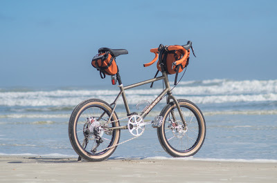

What’s on there right now? Have you thought about detuning them with a V-brake road lever and standard road-pull disc brakes?
They’re BB7s paired to SRAM S500 levers. That’s actually my fav combination for non-brifter setup. Adrian’s a very skilled rider, so I have no doubts about her ability to modulate under different conditions. I wonder if they’re stronger than I’ve noticed in the past because of the small wheels, cause they’re fairly new, and because of all the sand/grit. Probably all three.

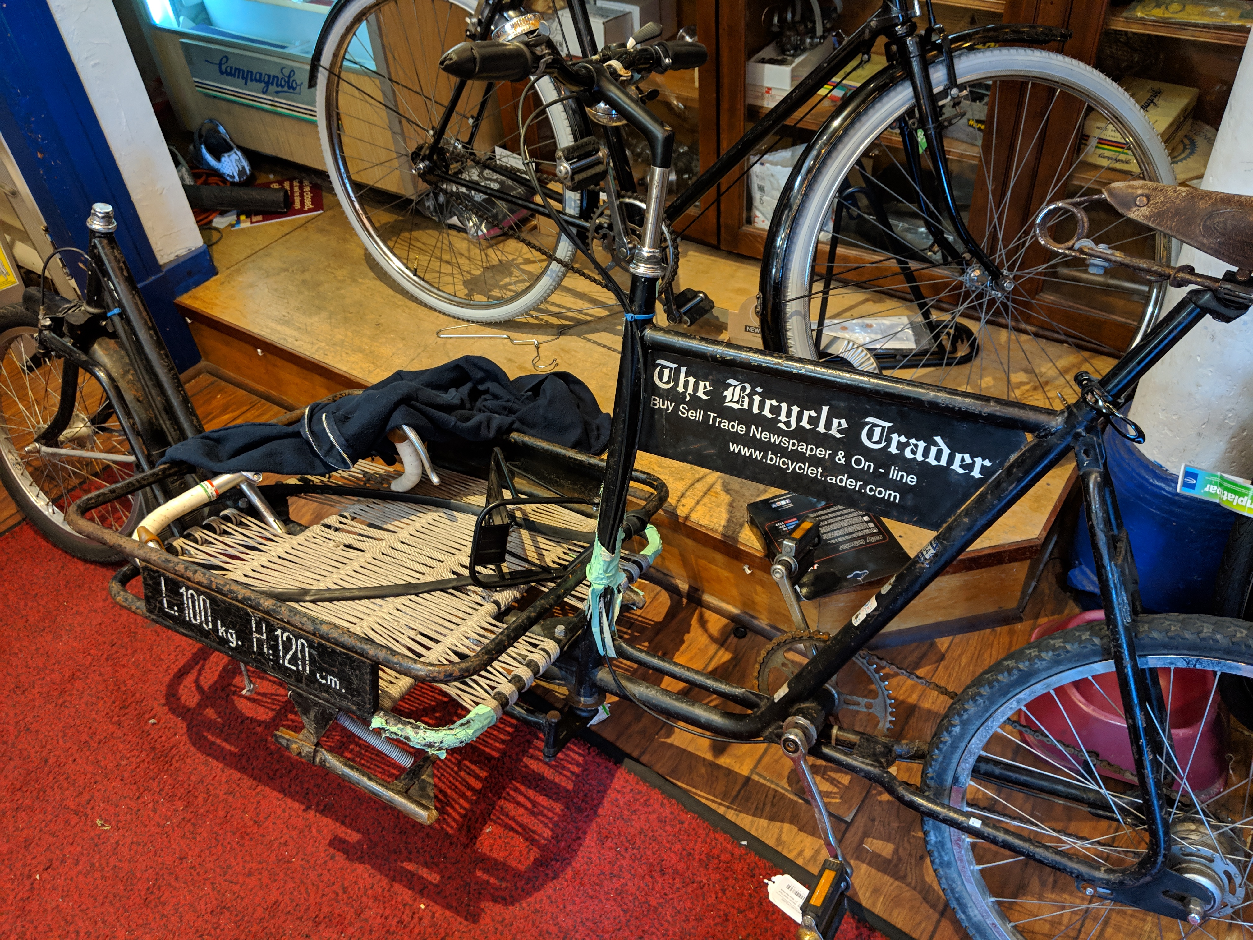

All this talk of shuttered bicycle magazines reminded me of this monstrosity that lives at my shop now.
We had a shitty Dutch baekfiets out front for like a millions years, finally sold it and then the owner brought this thing up from his house. It’s so frustrating.

Are smaller where’s really the factor? Rotor is spinning faster for a given ground speed but I’m not sure how that affects initial bite and modulation.
I bet the shorter front-center + fat grippy tires is also a factor.
Maybe go down to 140mm rotors?

I think it’s because they grab more rotor sooner since the wheels are spinning faster given the same speed. I need some Capreo rotors. Gimme like a 100mm rotor.

The ratio of braking surface diameter to rolling diameter of the tire is a major factor when calculating the mechanical advantage of yer brakes.

I think it’s the lever arm ratio between the brake disc and the tire. You have a set amount of braking torque that either gets applied to a big wheel or a small wheel, but the lever arm on a small wheel is 1/2 the size or whatever.
