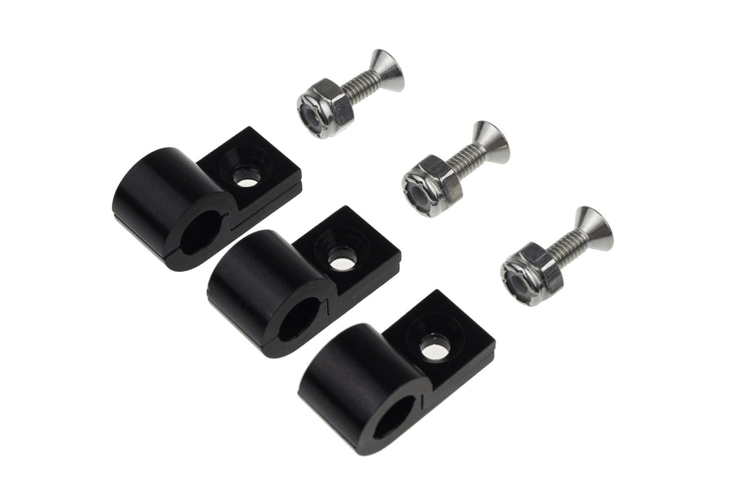

DIY Decaleur brackets (to be used with an ortlieb pannier rail on the bag)
31.8mm diam clamps with extension http://www.ebay.com.au/itm/371496312139
22mm diam mirror clamps, purple http://www.ebay.com.au/itm/400955404506
same, boring black http://www.ebay.com.au/itm/291488449118
1" diam hydro hose clamp black http://www.ebay.com.au/itm/121793968768
22mm diam clamps with brace http://www.ebay.com.au/itm/181173393857
How do you parlay that first 31.8 clamp into a decaleur that’ll fit an Ortlieb bag system? I’m having a hard time imagining this.
I’ll add:
16mm is the biggest diameter tubing that an Ortlieb pannier clamp will fit on, so I figured it was the best choice.
Then I figure it’ll fit easily into this setup, replacing the 22mm tube with some shimming.The clamps themselves look small enough that I hope they don’t interfere with the Ortlieb system.

[quote=lukasz]How do you parlay that first 31.8 clamp into a decaleur that’ll fit an Ortlieb bag system? I’m having a hard time imagining this.
[/quote]
Remove the gopro sandwich part (two bolts) (or if it works for the height you need, bolt it to the tube/rod somehow and use it)
Attach a tube/rod of your preferred ortlieb clamp diameter (10-12mm alu tube would be cheap and easy) to the extension of the clamp by either making a bracket, drilling through and bolting on to existing tapped holes or make more…
Adjust height of tube attachment on extension together with angle of clamp for offset from bar, settle on final attachment point on clamp and pannier rail attachment on bag.
Ok, that part where you attach the tube/rod to the clamp is where I don’t see a solution easy enough for my lazy self. What do you think of my idea?
Ok, except
- giant shim (22-16 = 3mm thick), not insurmountable.
- what’s the wear resistance of the carbon tube to the pannier hooks vibrating around on it, my tubus has no powercoat left where the hooks go.
- limited adjustment as rotating the clamp on your bars covers both height and offset at the same time as it describes an arc. If that doesn’t coincide with the available rail area on the bag and the required offset from the bars, you’re out of luck.
Will the ortlieb hooks really fit over 16mm diameter tube? That’s fucking huge, like 5/8" . Good to know.
One way to attach a piece of rod/rail to something else is with the huge daruma eyebolts used on some racks.
Otherwise, set your googles to “rod clamp” there seems to be a lot in the photography/videography world. Like this little babby:
I’ve been searching for a little clampy-thing that I can use on existing rack tubing to create a dyno light mount. The trick is I need to insert in the middle of a tube run, not slip over the end. Not sure what I’m going to use, but ERMAGHERD so many clampy things:
https://www.servocity.com/html/1_4__shaft_clamp_collar__62510.html#.V1o0YtkrKUk
http://us.misumi-ec.com/vona2/mech/M0100000000/M0102000000/
http://www.lsbilletworks.com/
I think something like one of these is what I want:
