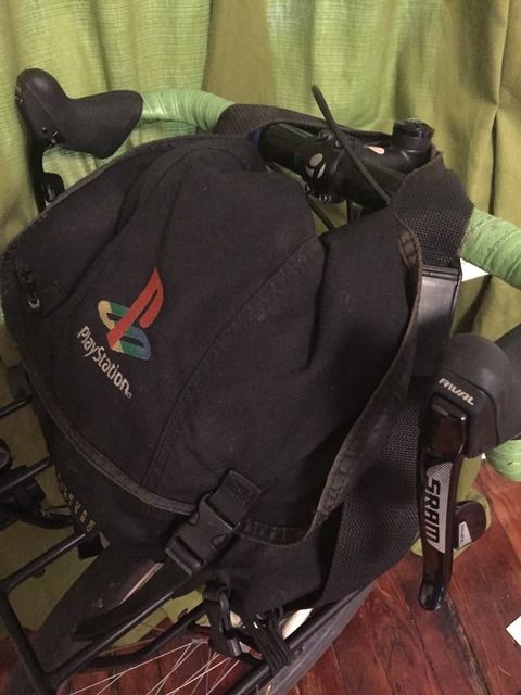

tent pole clips makes me think of what I did for my mess bag rack situation. took two delta cargo net clips, drilled for 4"ziptie and attached to the provisions for cross strap. when you have some stuff in the bag it puts them under tension and they stay put v nicely. I want a fancy box bag but this is so secure is so secure and free that I don’t want to buy something til I know it’s gonna be perfect.

I made mine so the two accessory mounts butt right up against the two Ortlieb mounts, which prevents side-to-side wiggling pretty well, and won’t let the bag fall off. Works pretty well.
