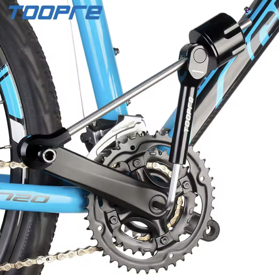

Crank bolt remover tool seen on AliExpress
Never in my life have I wished such a tool existed.

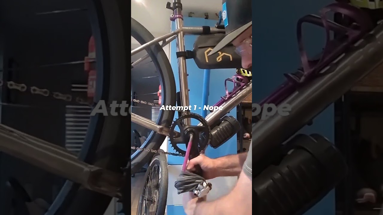

For some Dub cranks it probably comes in handy versus doing the “wrap an inner tube around the crank and hex wrench” method of boosting your loosening leverage.
I’m picturing a terrible slingshot so I need a bit more explanation
I’ve done this a few times to remove stubborn Dub cranks. It works, but if I were a shop mechanic I’d consider the special tool instead.
But… why not just put a cheater bar on your 8 or 10mm Allen wrench?
agreed, although you still need a way to stop the cranks from rotating
The inner tube thing actually doesn’t take that long and using a cheater bar means you either need another person or you have to securely strap the NDS crank to the frame.
Also it’s kind of amazing how strong a normal butyl inner tube is.
That tube method is hilarious. I can see a use case for the special tool for the kind of person that would rather buy a tool than use natural leverage.
Remove wheels. Put bike on floor. Put nds pedal on floor, step on pedal. Push down on long handle 8mm. 100% success rate.
@Elliott has seen me do this.
I hope that tool is strong enough so that when something is stuck bad enough that you really need it, some little part of it doesn’t just break instead. But I wouldn’t have a lot of faith.
Picturing it at work on a triple shows a good sense of the target demographic though.
IIRC CeramicSpeed introduced the first version of it
https://ceramicspeed.com/products/crank-bolt-removal-tool
okay now when they do it it’s fucking civilized wrenching :face_with_steam_from_nose:
