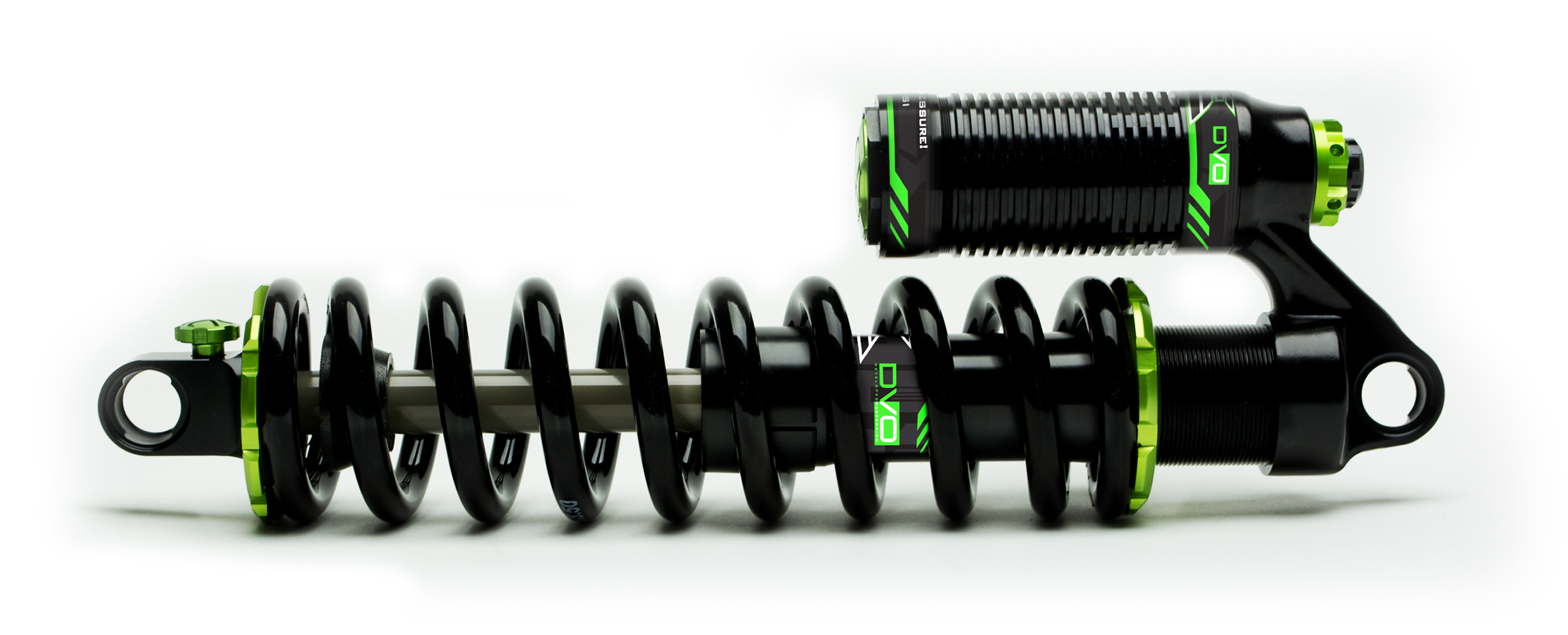

I love coil suspension. I love the feel, the ridiculous grip, the low maintenance, the solid performance over long-ass descents in heat. I just love it period.
I rode my old Giant frankenTrance with a RS Vivid and my Reign SX came stock with a Fox DHX2.
Mojo suspension was the UK distributor and pro-fiddle-gang for all things Fox in the UK since forever. Starling worked with them so it seemed like a good idea to get another DHX2. Then Mojo went bankrupt and belly up. Suddenly it wasn’t just me that had a problem, Starling did too since they where his main suspension supplier. After some back and forth and what I thinks was one really stressful times for Joe he had some new stuff going on. I could get another Vivid for a nickel and change but I was kinda hesitant. For a really silly and superficial reason. Putting a Vivid on a custom bike is really fucking boring, call me stupid but that’s my main gripe… I see Pike’s, Yari’s and Vivid’s allay long in Åre. So when I heard that Joe had stricken a deal with DVO I became curious AF.
Sure it might make great sense to put an air shock on a fairly linear dampening curve but Joe and many of his customers had great luck with running a coil on his frames. I picked the DVO Jade over the Topaz, I mean look at it! Bladder instead of IFP customisable with air pressure, LCS, HCS, rebound and pretty much everything you could ask.
A 500 lbs spring should suit me just perfect, might get a ti spring later on when everything is dialed in. For maxXx bling and also some weight saving! If this little “experiment” turn out not great I could always sell the Jade onwards with no loss and get an air can instead.
