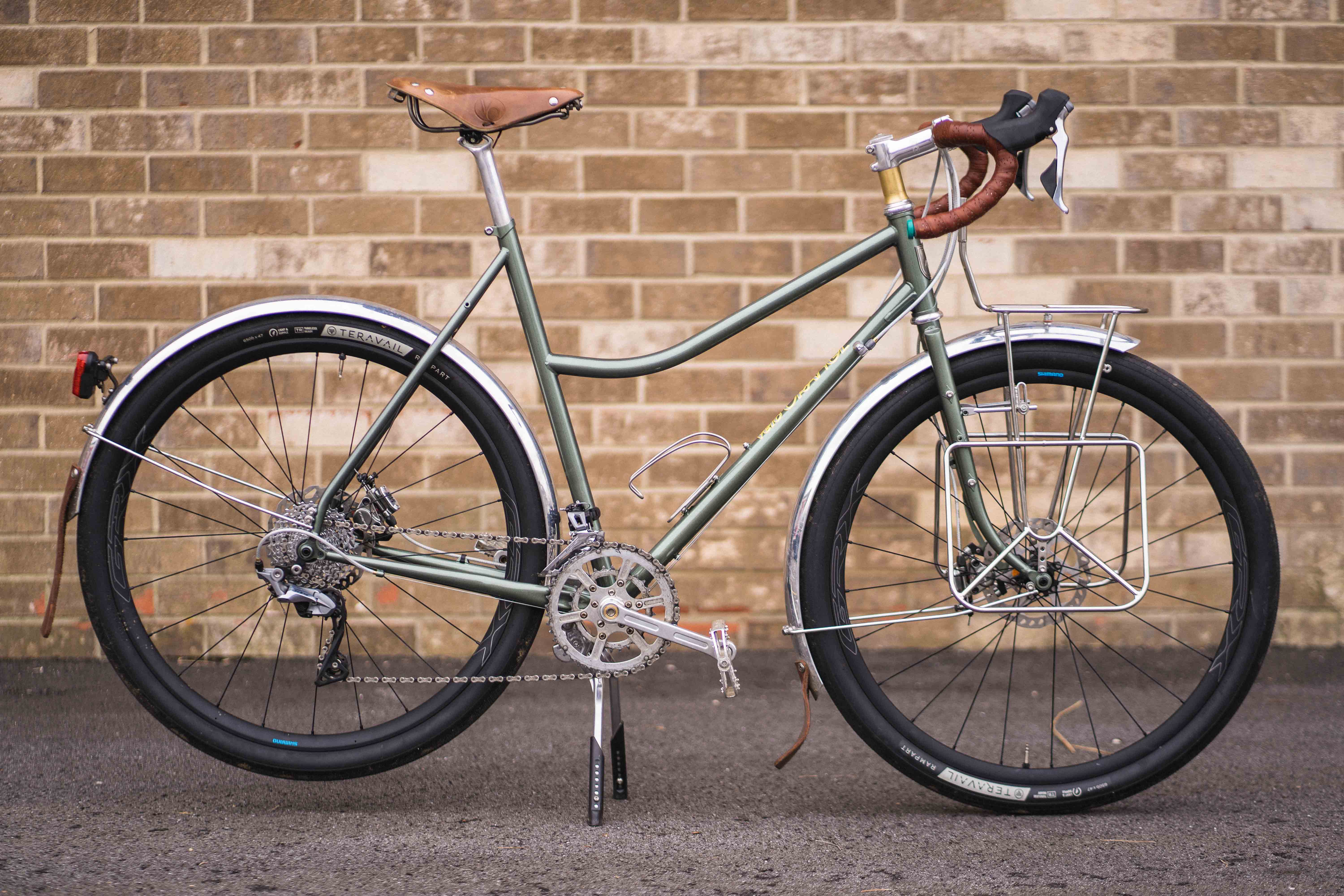

I’m giving you all the first, inside scoop.

(tho why not make the head tube taller?)

and talk to me about that seat tube, does it taper down to 28.6 just above the derailleur, like it’s a super long external butt?
There actually is 6* of slope. Anything more and it looks weird. Plus, this is a pretty chill fit.

That’s right. This was the best way mitigate stresses since the tt goes right into the middle of the st.

Step-through Poly with thru axles? I like.
I love it but I don’t know if 6* is chill these days. The one thing I’ve figured out about women’s* fit is that relative the hip socket the larger pelvis puts the sit bones lower and the base of the spine higher, so for a given height the bars need to be ~2" higher relative the saddle.
