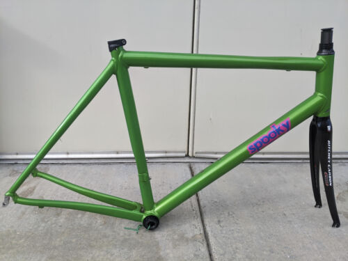

Potentially cheap Spooky.
alu frame + dent is not ideal
I’ll plug as usual here that FTW can make you a new one of these for like $1600-1800, that fits contemporary components.
If only someone here owned such a thing and had the ability to post a picture of it!
Also, Havocstaff was made during the heydey and low point of pressfit bottom brackets
FTW, Rock Lobster, Senko, lots of good ways to get a nice new alu frameset
