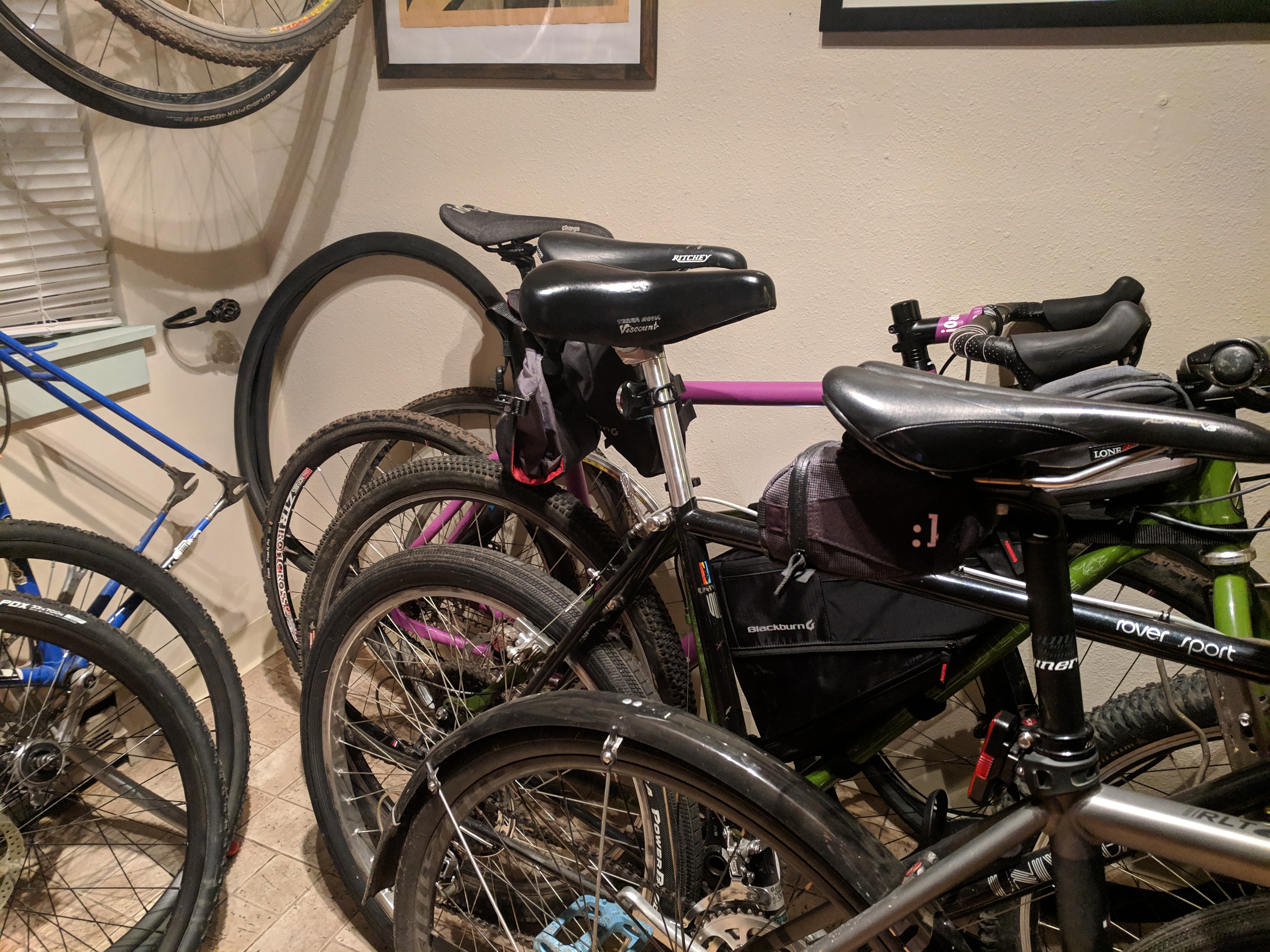

We need to see the bike, tarck will determine if lime green hose is good or bad.
It’s the purple one.
Rerouting is a good idea. Wish I’d thought of that before I just rewrapped the bars.
Possibly the worst picture of a bike ever posted on tarck
It’s at least a small part of nearly every bike I own. Except for the ones in the storage unit.
ahem, mig
Nonphotos don’t count
Yeah what photo
