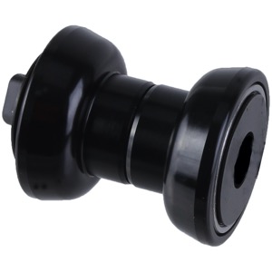

oh ya so I found out that this is the case with these too.
RockShox, Shock Hardware, 8X30.0, 11.4118.091.823
is out of stock everywhere but one seller on ebay in the UK.
8x30.8 is in stock. I’m wondering if the 30.8 might be a replacement and whether it would fit…
I usually go slightly smaller. Since that is a carbon linkage, it might not spread very well.
Universal has a M8X30 bearing in stock.
And Fox will fit on a RS? I actually measure the gap at 29.5…
The majority of shock manufacturers use the same eyelet I.D.
I’m 99% certain Fox and RockShox are the same. I don’t have any nude eyelets to caliper at the moment.

Yeah I bought Fox for RS cuz RS was out of stock.
I think they’re like headsets. You get the standard right and then you have a bunch to pick from that are all basically the same.
