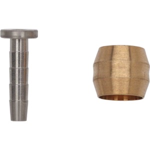

This is the way except I use a fresh razor blade with the hose on my workbench. I see no need to buy the special tool unless you’re doing it a bunch.
Am I the only one whacking the barb in with a hammer, like a monster?
Definitely not, although I usually use a soft face mallet not like a claw hammer like a savage.
the fancy dedicated tool is a razor blade that has some plastic molded around it with different geometry
Yeah whatever is at hand basically. I have a cute little 4 oz hammer.
I use a knipex thing that’s good for cutting PE tubing as well. I suppose if you also had a cigar or needed a circumcision, it’d work in a pinch.
I use a brass hammer to wack in barbs. I have a pusher, but who’s got time for all that?
Are the people who won’t use a plain razor blade the ones who will remove a crown race with a screw driver?
I remove crown race with screwdriver and install barb with fingers and then smash it on the workbench till flush
There’s another way?!?
My ā€œhackā€ was taking those yellow blocks that can wrap around the hose, putting a vice grips around those, then smacking the barb in with some kind of hammer
That’s what I’ve been doing. I splurged on a hose cutter, but the block-and-hammer method works fine, ATMO.
I think that’s what the Shimano instructions say, except replace vise grip with vise.
Yes, this is the intended purpose of those blocks.

Is there any reason I can just unscrew the old caliper and screw on the new one and use the existing lever and housing? I understand there are different sized olives and barbs but I think those depend on the hose and not specifically the brake caliper and lever? The olive on the existing line (installed) looked different than the olive on the new line (not yet installed) but I couldn’t tell if that was just a function of being installed vs new in package. I also assume I can reuse the barb and olive since I didn’t need to adjust the hose length?
All Shimano sruff, so all mineral oil.
Old: BR-M396
New BL-M6100 lever (not using), BR-M6120 caliper
You aren’t supposed to reuse the barb and olive because the olive is the part that keeps the juice in the hose. It is essentially a crush washer.
Having said that, I’ve heard of people doing it. I’ve never done it myself and wouldn’t recommend it.
Based on what you are describing, I don’t think you don’t need a new barb, but technically you need a new olive.
You need a new barb everytime you shorten the hose. You need a new olive every time you reconnect the hose, as Crusty said above, it’s basically a crush fitting. There’s always a chance your system will leak if you reuse it.
