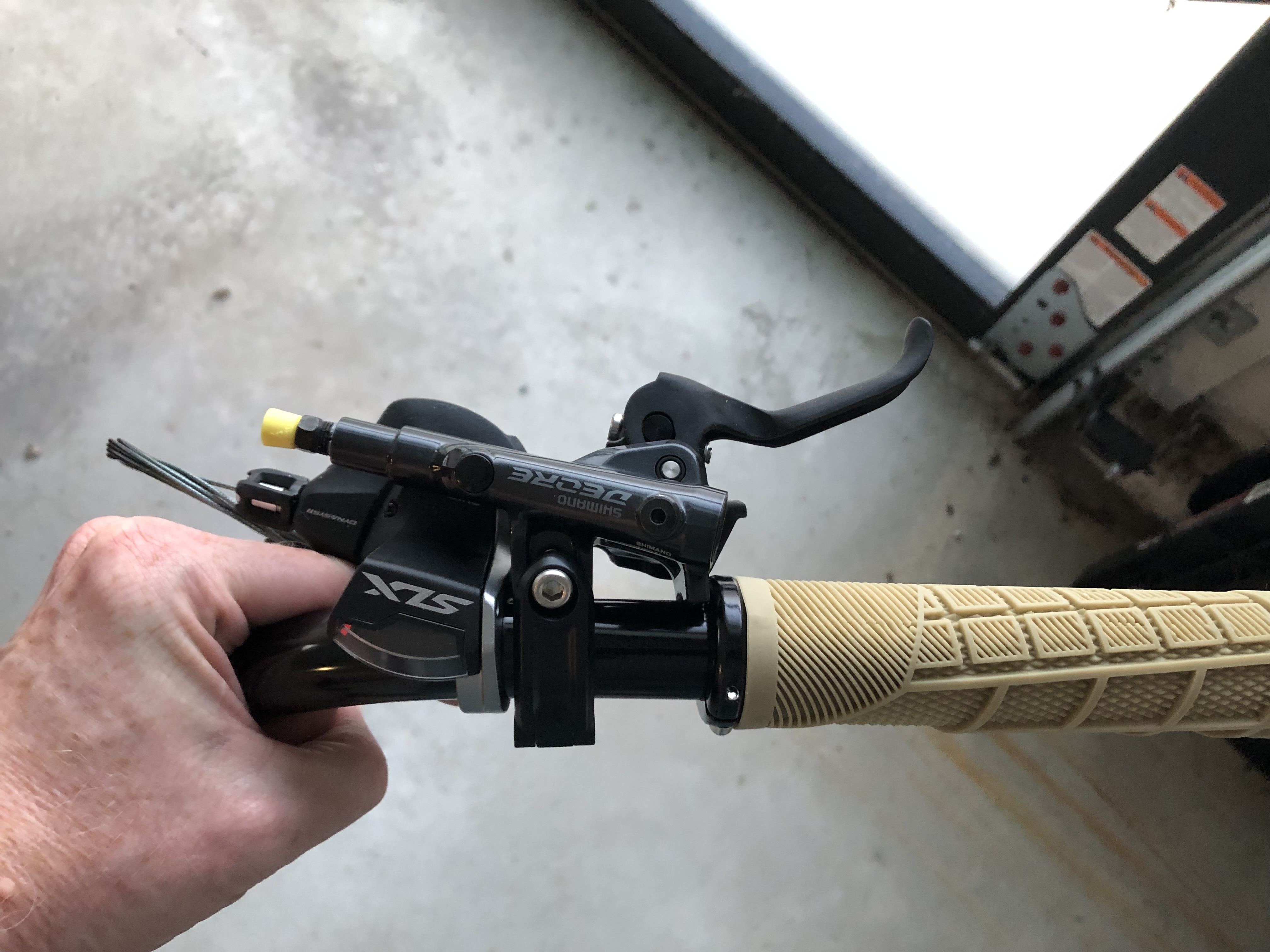

Yeah it seems I’m supposed to run the shift levers on the outside of the brake levers, but these ones have the indicator for the gear # and that gets in the way. Alternatively ispec mounted shifters would work but don’t have those either.

Try it like this if you’ve got enough space on the bar. I had a bike setup this way and it was fine atmo.
A Spurbell fits great in that little space between the brake clamp and brace.
Those gear indicators generally can be taken off pretty easily. Screw off cover and a small bit of tape over the enagagement hole for the indicator hand and you’re golden.

I tried that but I can’t reach my shifters with it on that side!
Thanks I’ll have to try that.

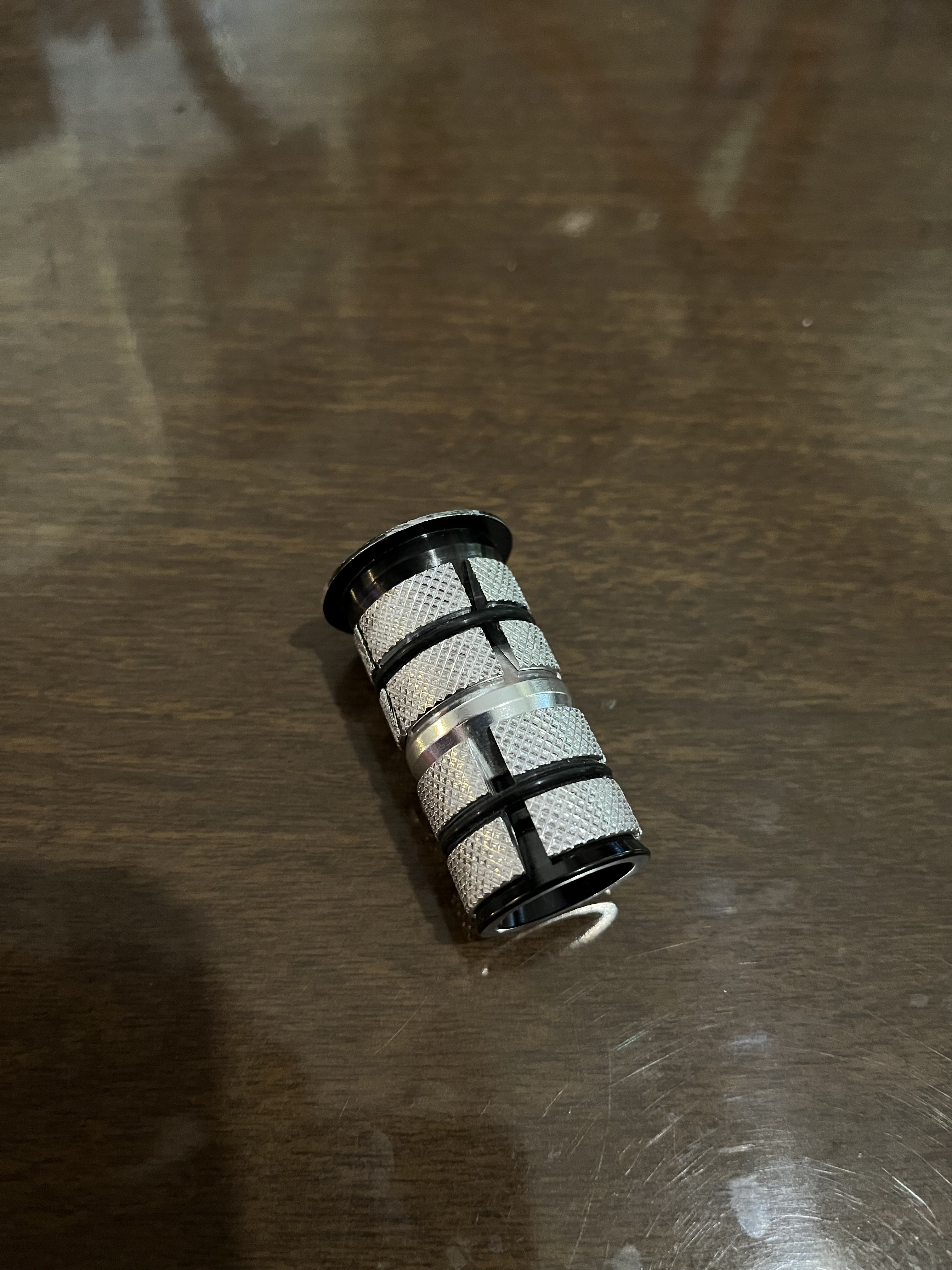

Anyone else had issues with these expanders loosening?
I’ve been having issues with my headset preload. I think what is happening is the expander plug is loosening and lessening the outward pressure on the steer tube, effectively shrinking the steer tube diameter. That’s then causing the stem to slip a bit on the steer tube.
Carbon paste in the steer tube? Probably going to threadlock the wedge bolt at least.
The last time I had an issue like that (with a steel steer tube that I thought the starnut was slipping in and causing the headset to loosen), it was fixed with a new headset.

I recall someone here suggesting the proper way Is to grease the wedge on the expander and then carbon paste inside the steerer
