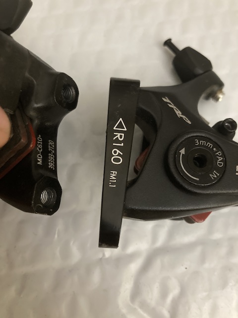

are these post mount calipers?
edit- lol. thought you asked if they were flat mounts, because picture took over my brain. So, yes, flat mounts.
Flat mount, not post mount
