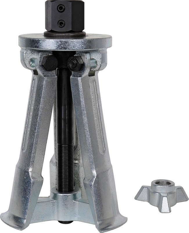

Big ass blind hole bearing puller. You should be able to catch the race with the correct size.
OR depending on the shape of the head tube, you might be able to catch the race with a long flat head and carefully pry or drive it out.

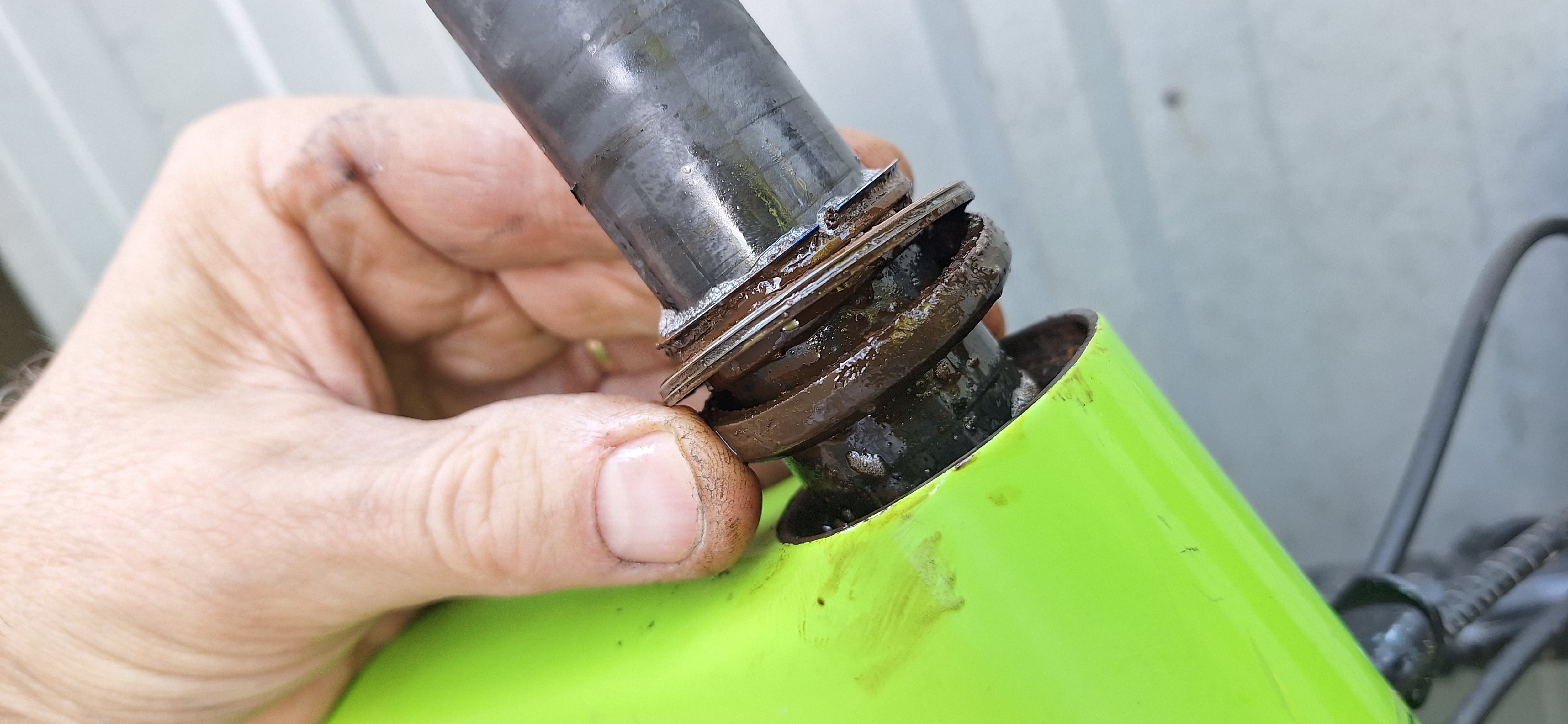

Looks like a bit of corrosion grabbed onto it. get behind it with a screw driver if you can and pry it out, alternating sides to wobble it out.
Use plenty of grease setting the new one in.
I last used a wooden dowel through the top of the head tube. And a hammer. Or is there a lip there that would prevent this approach?
I think I used a tire lever the last time this happened to me. A church key might also grab a hold.

Big ass lip : (
I guess they have been in there for 5 or 6 years. Will take it into a shop on monday I reckon. You have experience with OPEN. Is there an alloy insert on the bottom?
I believe the bearings just go right into the carbon. Whatās the top like? They should be the same. Iāve had to pry top bearings out that got contaminated by salty indoor trainer sweat.
Top one was all good. Manky, but came out well enough.
I think he means does it have an aluminum insert or notā¦
The top had no insert.
Ewwww
Good luck praying that junk out of the bottom.
Googling ābig ass blind hole bearing pullersā and praying. Dropping off at a competent LBS tomoz. Assuming they want my moneyā¦
Something like this combined with a slide hammer will have it out quickly. May be able to rent from an auto parts store or buy-use-return to big box store.
