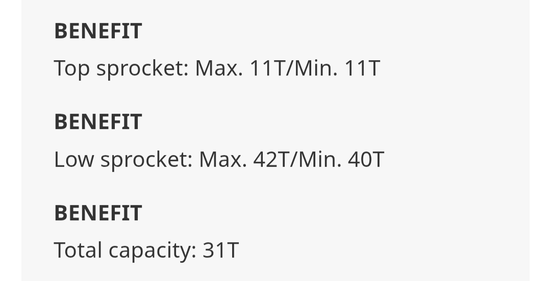

Nice, this is the first instance of new-pull 10s shImano being helpful for someone who needs an odd setup that ive seen
When Shimano says the min teeth on the low sprocket is 40, what does that mean?
From the RD-RX812 info
it’s saying you can’t run that rear derailleur with a cassette having a lowest gear of 39 or less teeth
Sometimes it’s Shimano being Shimano and saying “the cassettes in this group only go down to 40 so that’s all it is compatible with.” Other times it’s something like “if you back the B-screw all the way out, the guide pulley will only be in spec for a 40T cog” (with some wiggle room ofc). But in this case having a 2T difference between min and max is dumb and obviously does not reflect the true capacity.
What size cassette are you running?
The RX800 dangler might be worth looking at. It has the same capacity as the 4700 GS.
https://productinfo.shimano.com/en/product/RD-RX800-GS
pretty sure I have a rx812 and a 11-42 M7000 cassette working mostly nicely
I was trying to up my capacity for 1x gravel, but also use the same bike for a tighter ratio cross gearing. Guess I’ll just have to pick one or the other.
There’s an 11-32 on the right now for cross and I’d like a wider range oprion for gravel.
